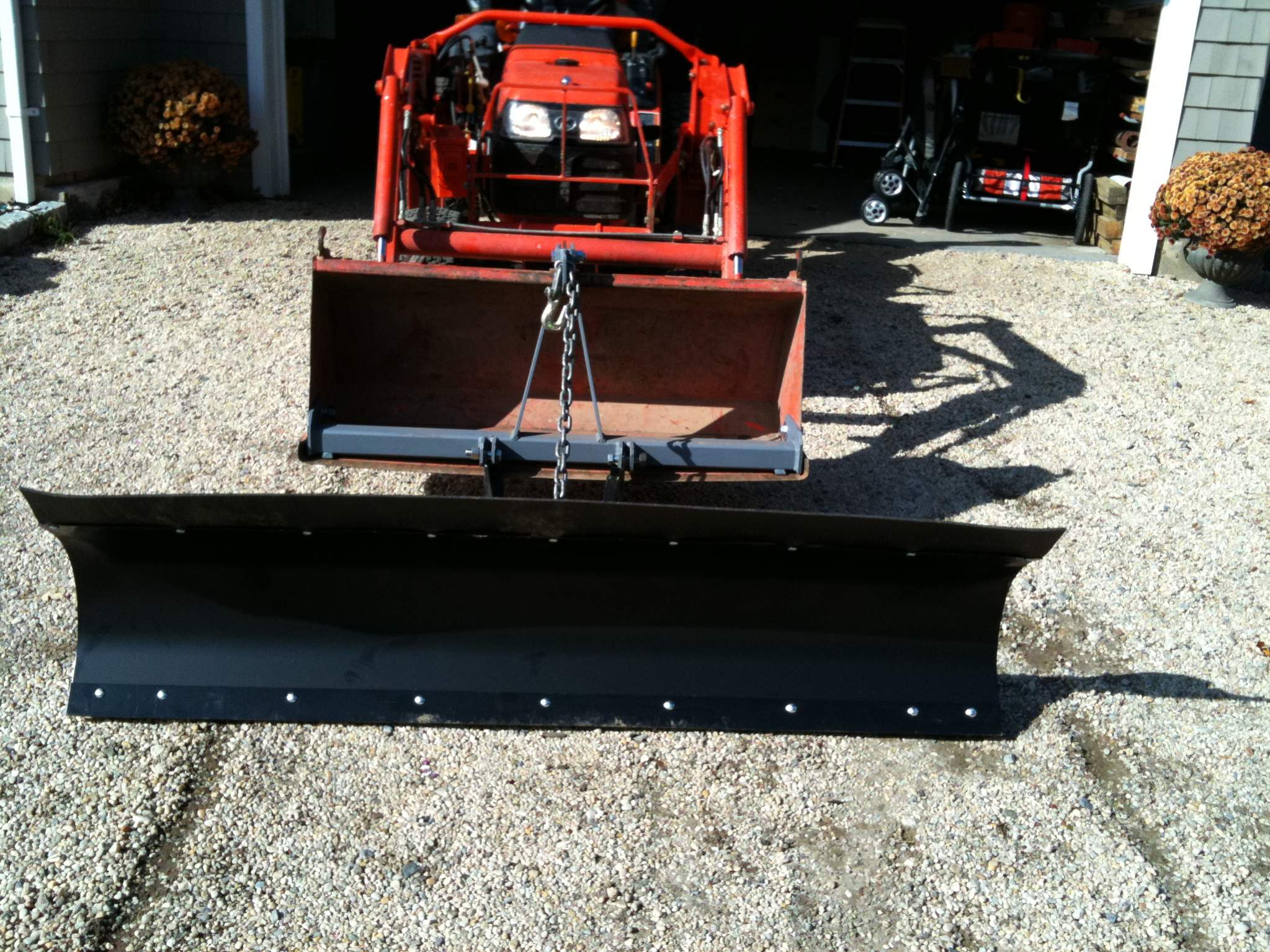

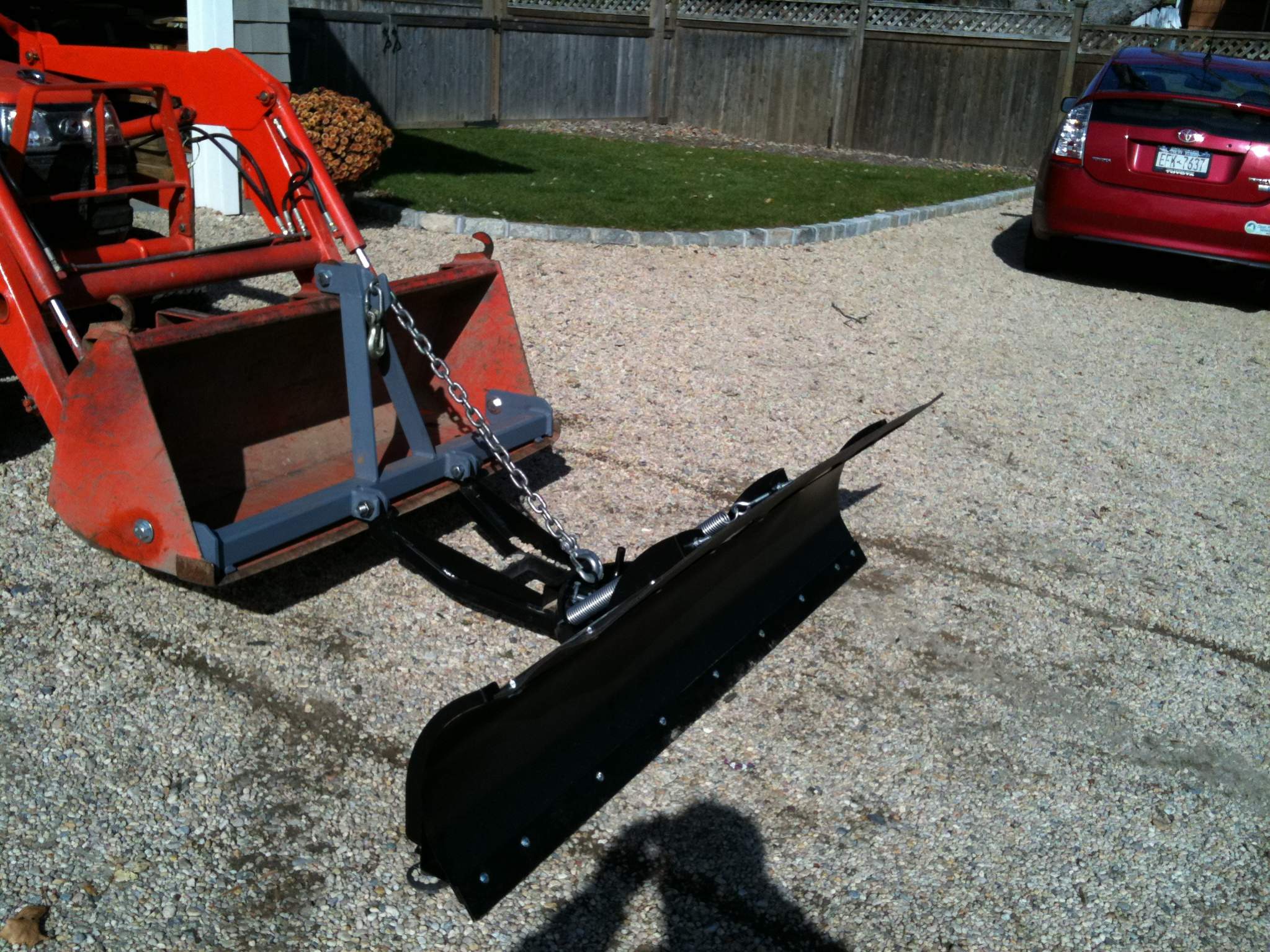

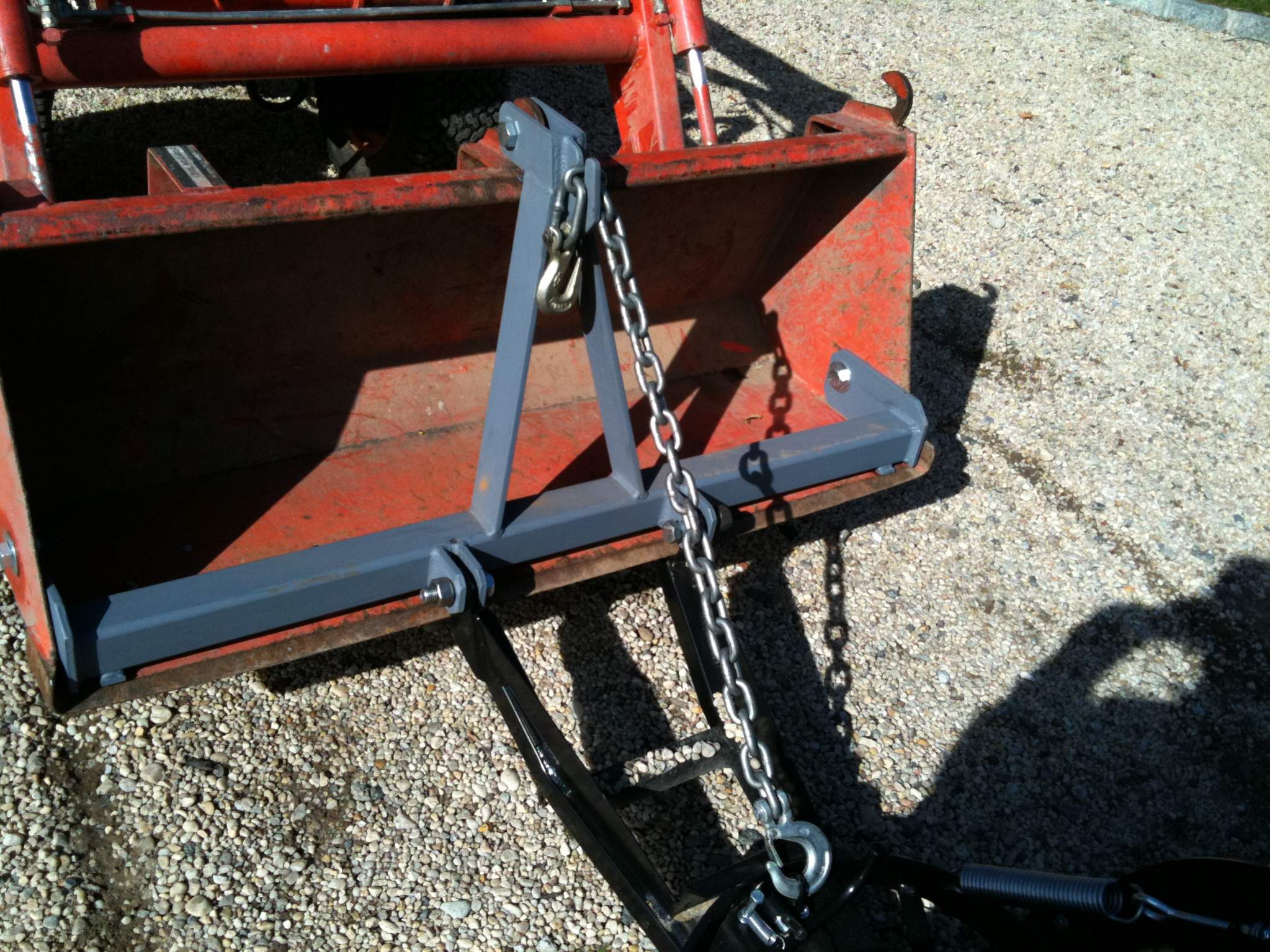

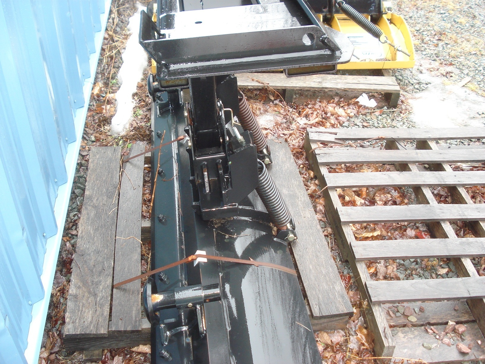

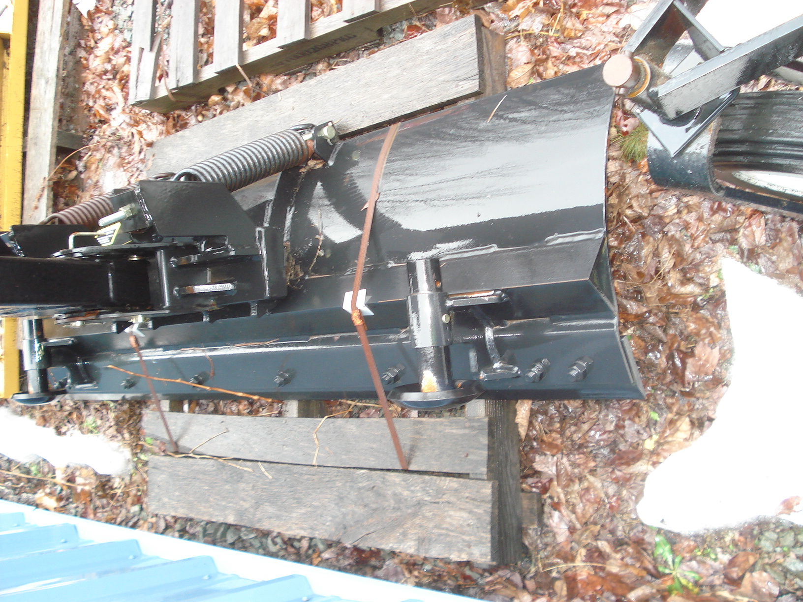

I have a 72" one here that is a snow/dirt blade. There are 2 bolts that you take out and the spring trip will work for snow pushing or you leave them in and now you have a dozer blade. It is a manual angle or you can add the hydraulic cylinder kit down the road, $1,900 manual $2,300 power angle.
It was a Branson made by America-quip.

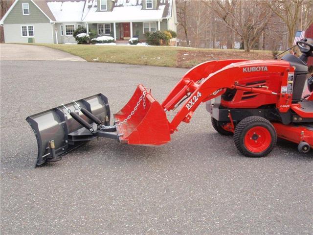

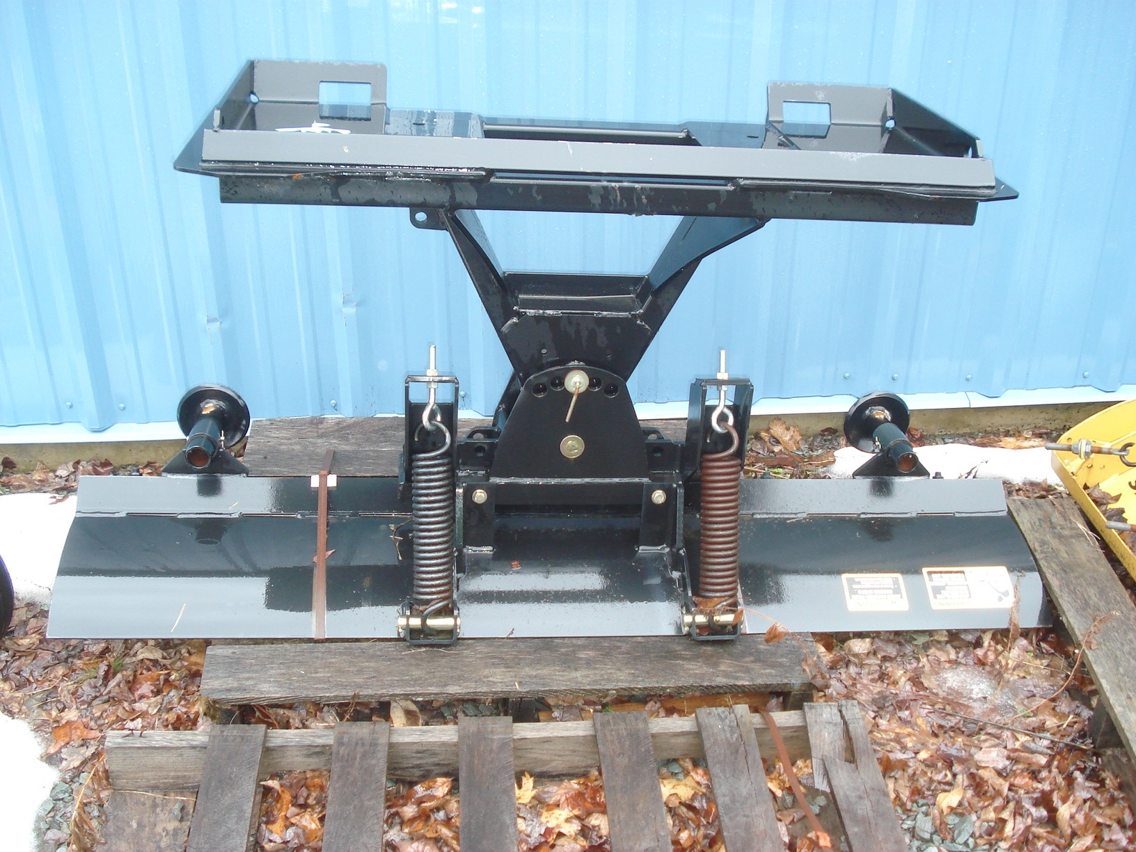

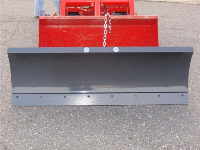

/ FEL Mounted Plow #4
It is easy enough to rig up...this is a 72" UTV plow mounted to a custom mount in the bucket.
