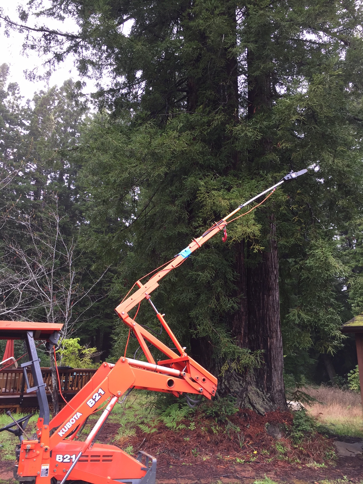

Haha, thanx for the accolades guyz.
Feeling some inspiration.....
I have an FEL, an electric (Remington) pole saw, a piece of 20' fence top rail, some guy wire, an extension cord, a switch or two and a tree hanging over a telephone pole (no power line on it).
Not sure if I have the guts or not though.
I had originally thought about making a human bucket lift cage, attached to the FEL. Or, just renting one. But there was so little room up in some of those trees. Plus, the thought of accidentally bumping the hydraulic control gave me the heebee-jeebees.
Not shown is the practice sessions.
Find a five-foot pencil, and practice signing your name.
Kinda like doing brain surgery, by way of the ****...

I'm impressed, would I do it... NOT, but nice job !
   / FEL mounted tree limb trimmer #46
You know - if I had seven miles of lanes/roads to limb and the limbs got up to 3" - I'd be looking for professional help. This doesn't really sound like a DIY project.
Particularly - with the height ( 25 feet ), power lines involved is some areas and limbs up to 3".
That's why power companies have hydraulic man lifts on big trucks and workers with chain saws.

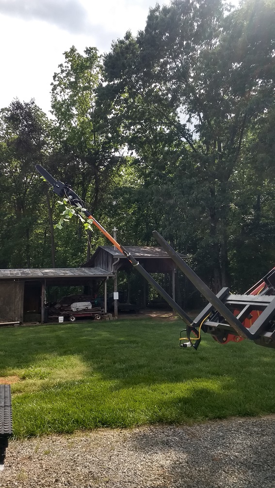

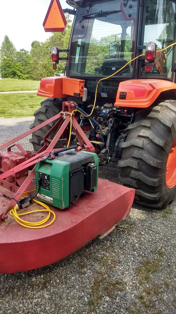

You mean THIS Remington saw? I used (3) 5" hose clamps from TS to pin it to my forks. I use a little suitcase genny I picked up off CL for $75 and a wireless remote on/off switch from Amazon for $11 to turn it on and off. I also have a gas pole saw I can use from work platform for greater reach, but that requires two people. :)
This by no means is an all day work solution, just a simple solution to trim a few trees.
Yeah, but I would just use a momentary contact switch - push to power, off when released .... dead man type switch.
