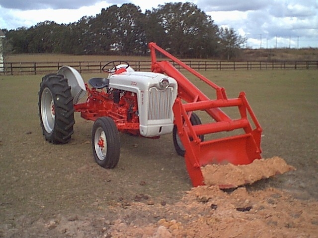

Hmm.. I'd say that you didn't have the steering setup correctly if you could only go straight ahewad or back when loaded. Non PS tractors with fel's generally are hard to steer from a stopped position.. however.. once you are rolling.. the steering is much easier. However.. if the steering still has slop.. or has had the sector backlash adjsuted too tight, or the bushings int he spindles are too sloppy and bind or are too tight.. then I can see where you might have problems.
The attached pic is a 2wd unit.. no ps... 'standard-light duty' front axle.. She has a nice tight steering box and good busings.. She -can- be steered from a stop.. but is way easier to steer when moving.. A 450-600# 3pt counterweight i added was almost like power steering.
Soundguy

They any weaker than ford tractor front axle's built in 1939 using a simple solid axle center section with wings, and a kingpin?
Soundguy

I'm surprised that the U-shaped plate is not stronger. Both my big fords have a similar front axle setup like that ( adjustable ).. and those axles are billed as stronger than the center and leaf solid cast units of yesteryear.. the old fords used to use, before the industrial units hit.. etc.
Must be just sized real small .. i.e. thin metal.. and just can't handle the weight. Are the front hubs/spindles smaller on those units that don't reccomend the loaders? that could be an issue..
By the way.. I'm -not- disagreeing with you.. ( just speculating ) I obviously have not smoked a jinmar front end over.. nor do i have a fraction of the experience you other guys do with them. I'm just wondering 'out loud' what the differences might be inthe units that 'can' handle it, vs the units that are not designed for it.
For the units that are ok.. what is the front axle design? is there a different king pin setup.. larger axle, thicker metal? different wheel hubs / spindles? differnet bearings? different geometry? just curious.
(thanks)
Soundguy
