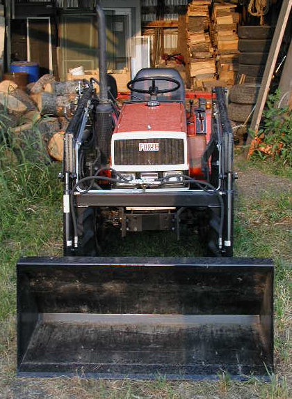

I have an FB15D with an FEL on it. Similar to the F15D just a little lower clearance, wider rear end, and heavier. I'll try and attach some pictures of the loader and tractor.
