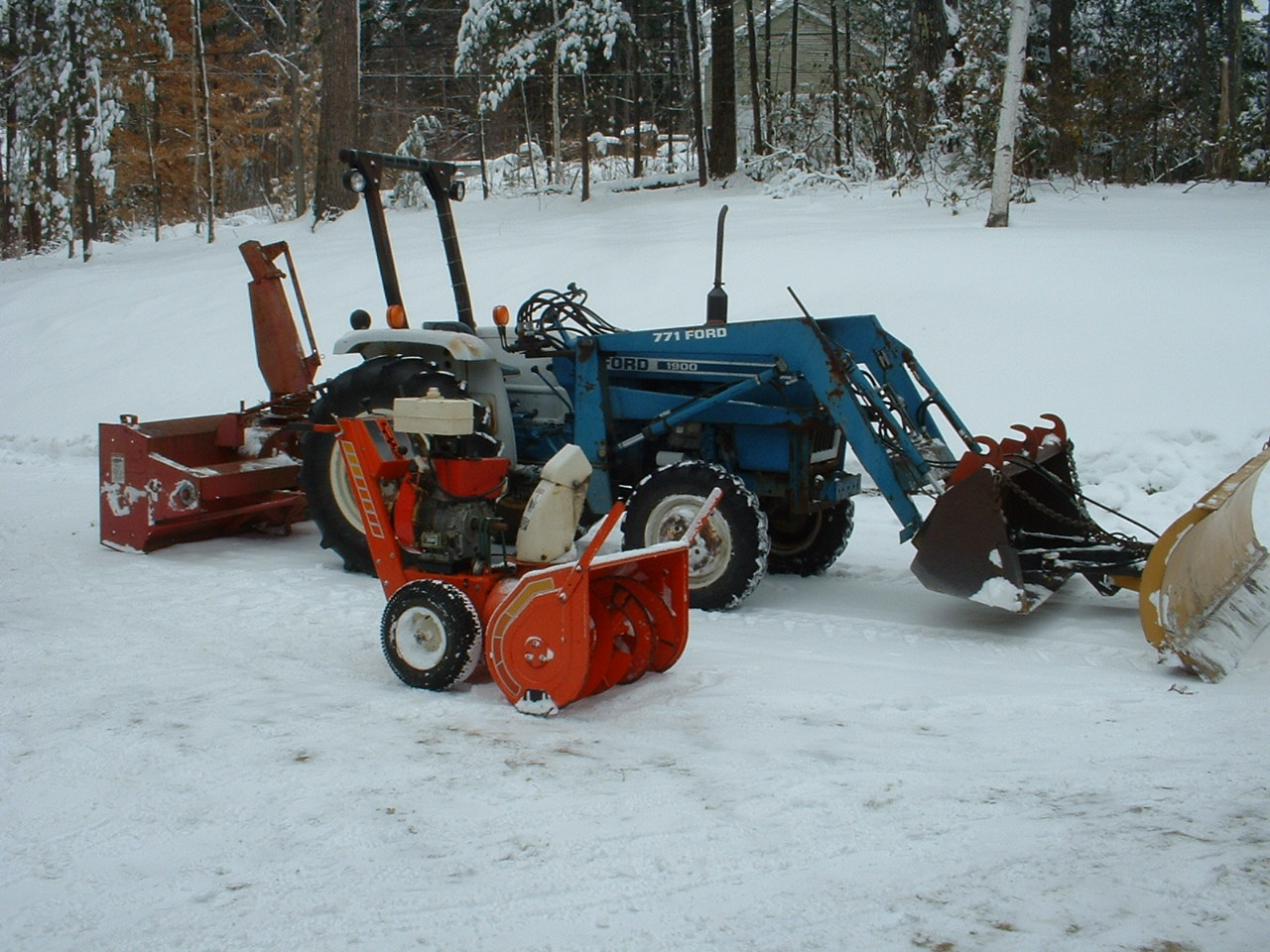

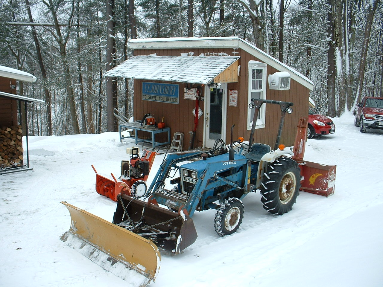

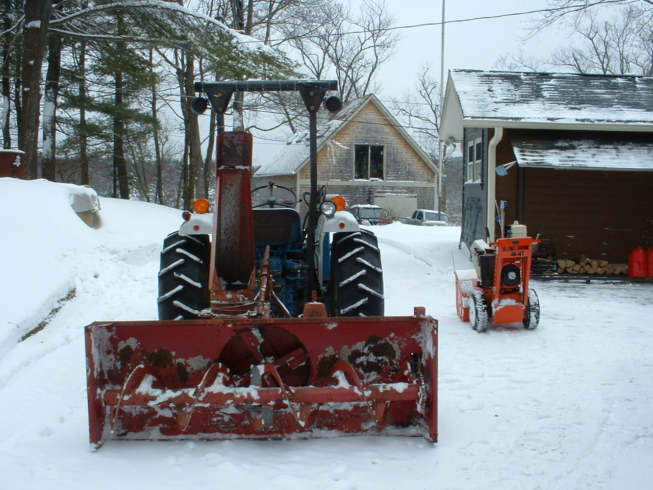

I run a PA plow on the front and a blower on the back. For lighter snowfalls, I'll windrow the snow and then blow it into the woods. For heavier snowfalls I'll start right in with the blower and then clean up with the plow. Until I can get myself a rig like smfcpacfp's this setup does the trick for me...Rick

I did the windrow thing myself this last snowfall. Worked great. Took less overall time than blowing everything. Best of both worlds as it made the job faster AND allowed me to blow the snow 30-40 feet away from the roads to allow for melting water not to puddle next to the berms that the plow makes.
