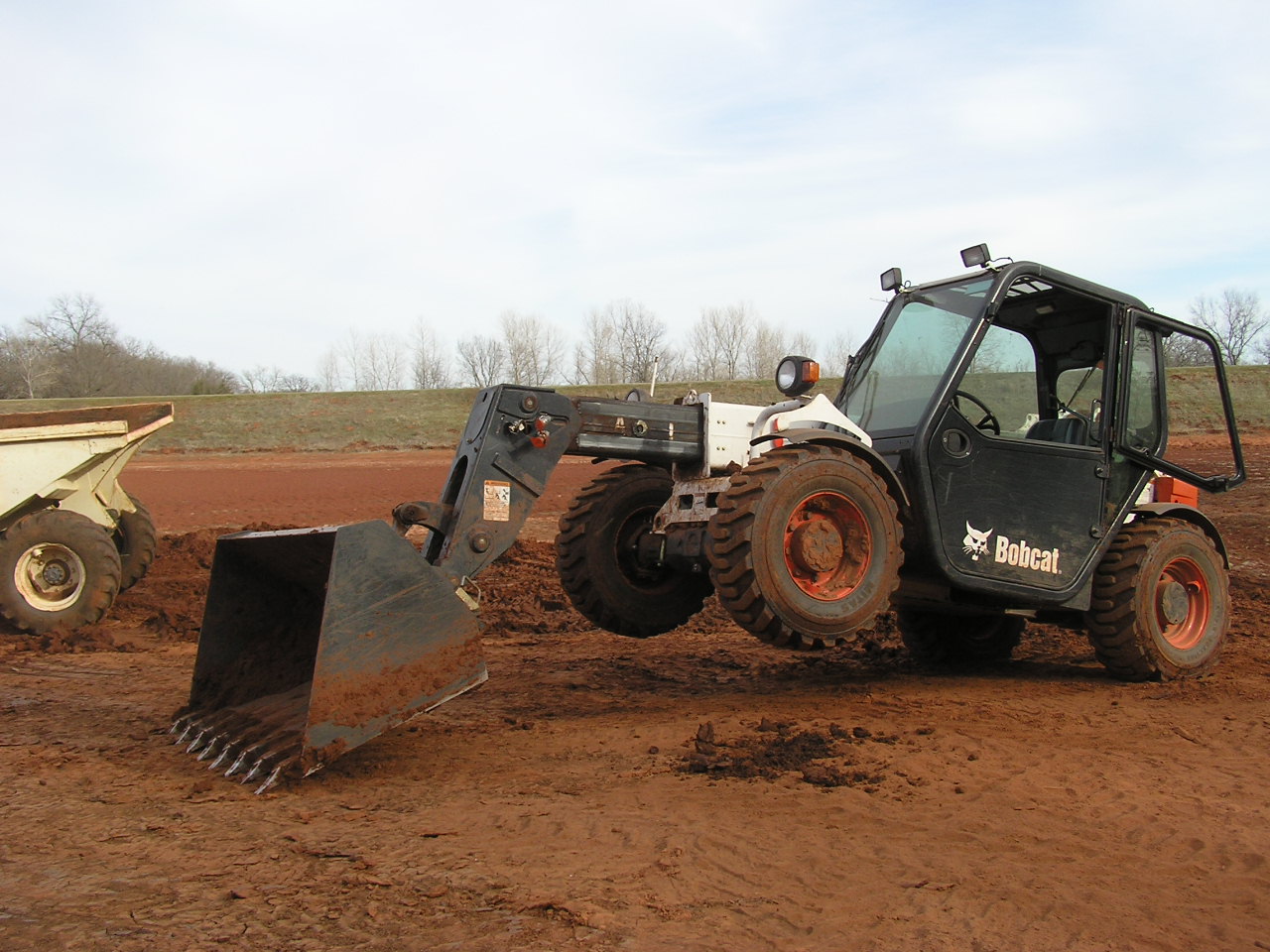

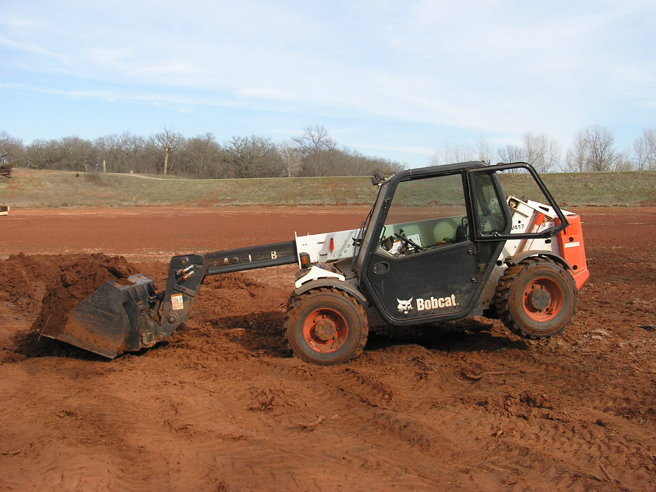

No multi photos from the phone app.
   / FEL question #33
I do it because it makes me appear to be doing a wheelie. :laughing:
   / FEL question #34
I have to lower mine to do a wheelie! :laughing:
I can also do a reverse wheelie! :D
   / FEL question #35
That bobcat looks like so much fun faxman!!

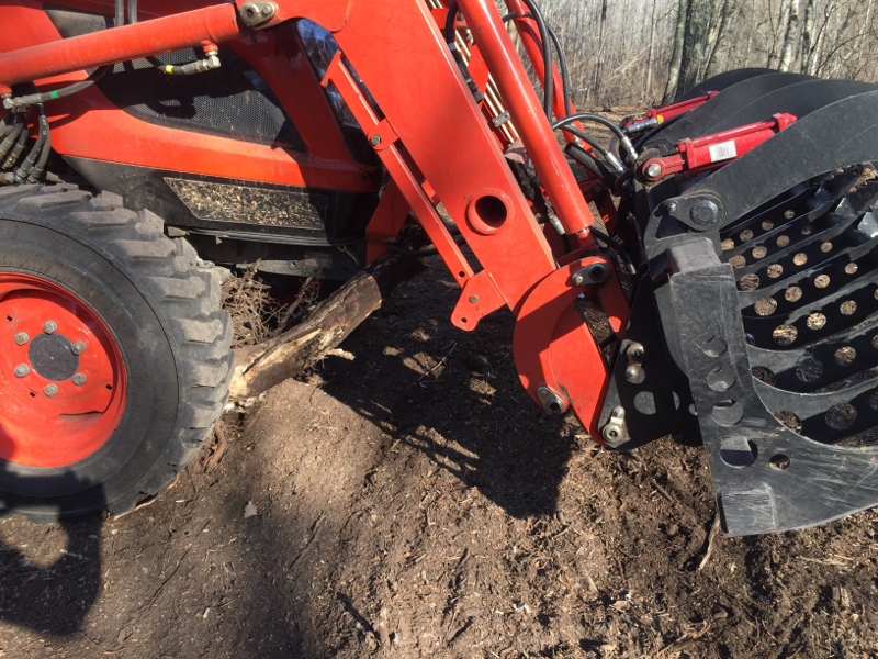

I'll give you point #1. The more you practice it, the easier it becomes though.
#2-They have suitcase weights for this that work very well. If I'm doing field work, the loader comes off and the weights go on.
#3-I can see how you justify this, but if you are ok with wearing your loader pins out by bouncing around a light duty loader then by all means.
#4-I was not calling you foolish, I was calling the act foolish. These modern loaders are very expensive and are not tolerant of abuse. Bouncing around a rough field is a sure way to need a line boring job done much sooner rather than later.
Its your equipment though, do as you wish.
I leave the loader on, in fact I don't think its ever been off. I really value it for pre-clearing a path so that I avoid hidden problems. With the buck curled, It will ride over a rock that would destroy my mower and PTO. Clearance and ballast are also reasons, and I don't actually know if it would go back on my 30 yr old machine!
But, I don't do any field work at speed that causes me to be bouncing around. Forget the loader. I value my back and kidneys!
