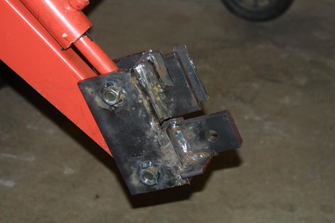

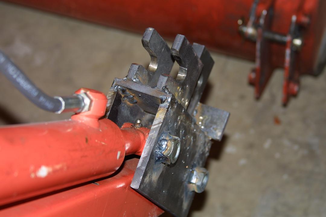

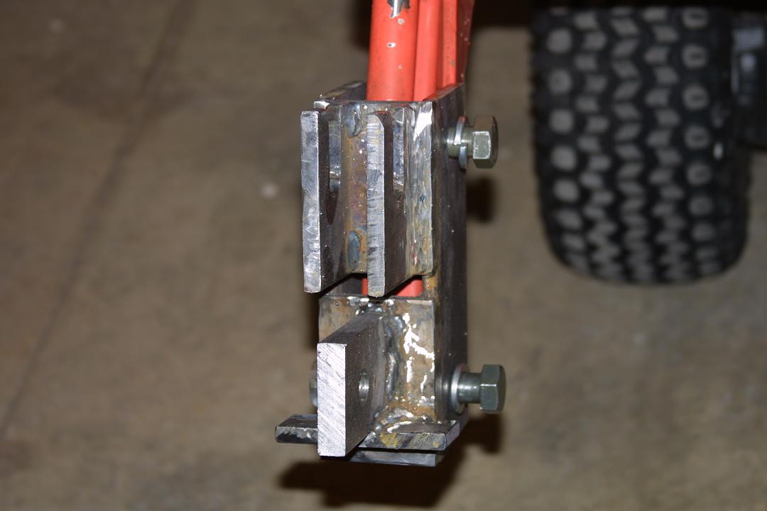

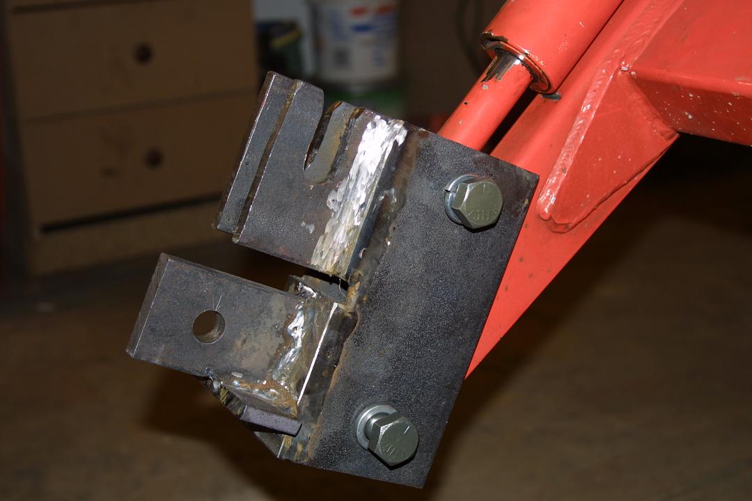

I just finished welding the forks up tonight so here are some pics. Still in the just-welded, pre-make it look pretty stage but anyway. The last picture is my 200lb carcass standing on the forks (yes they are off the ground) so they'll hold at least that much! I love this tractor stuff!
Dave

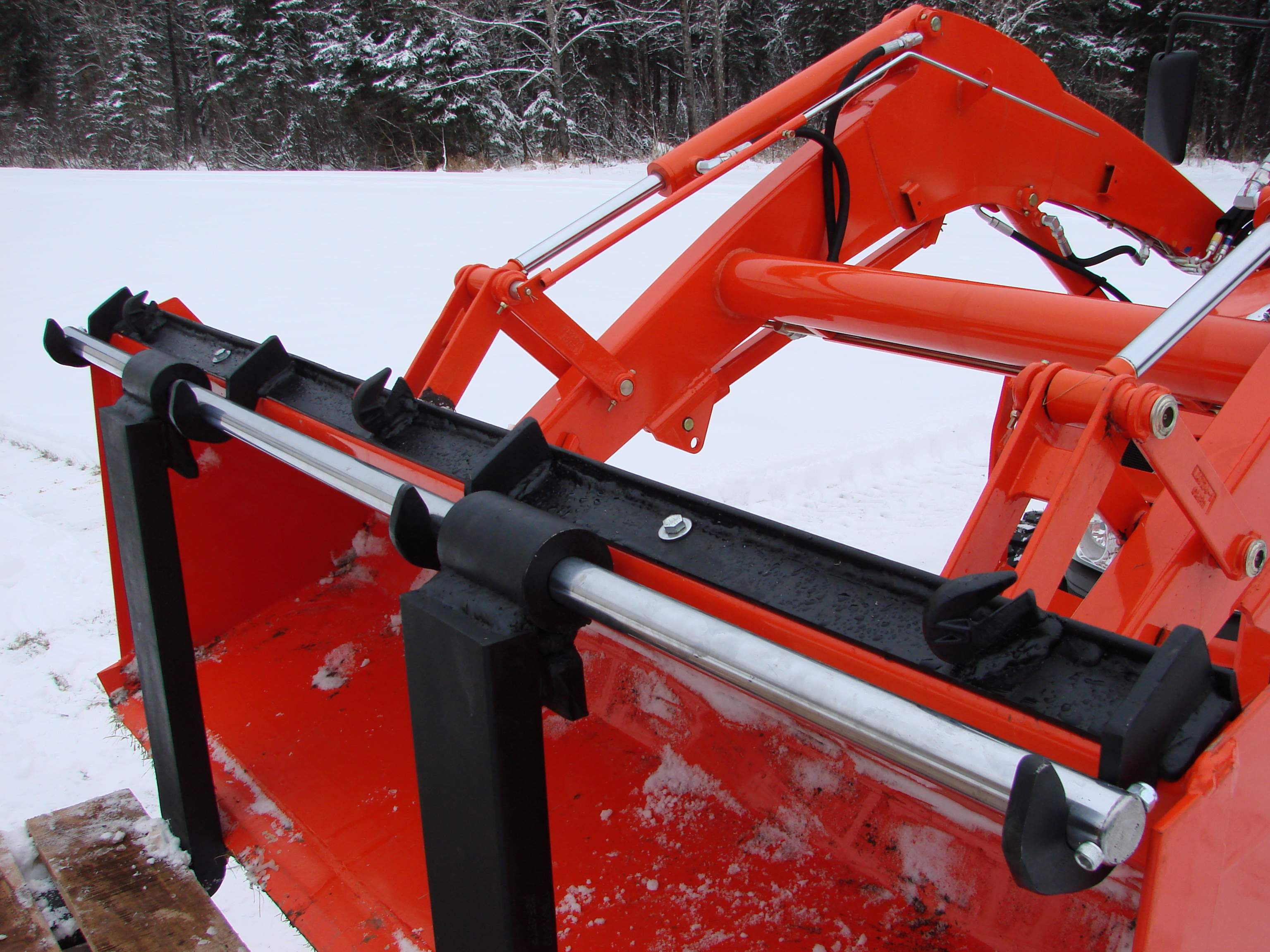

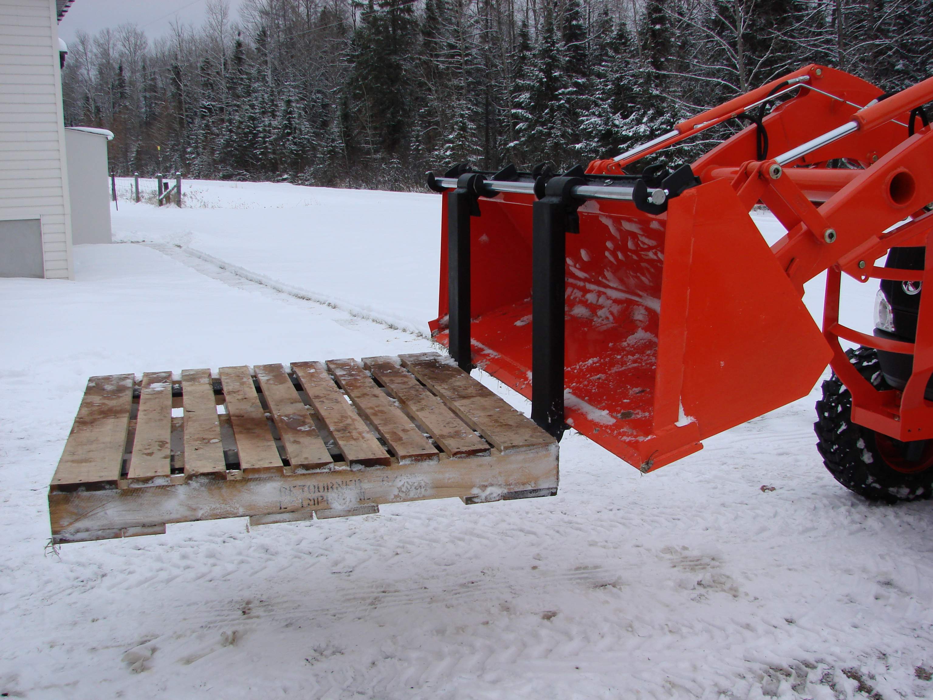

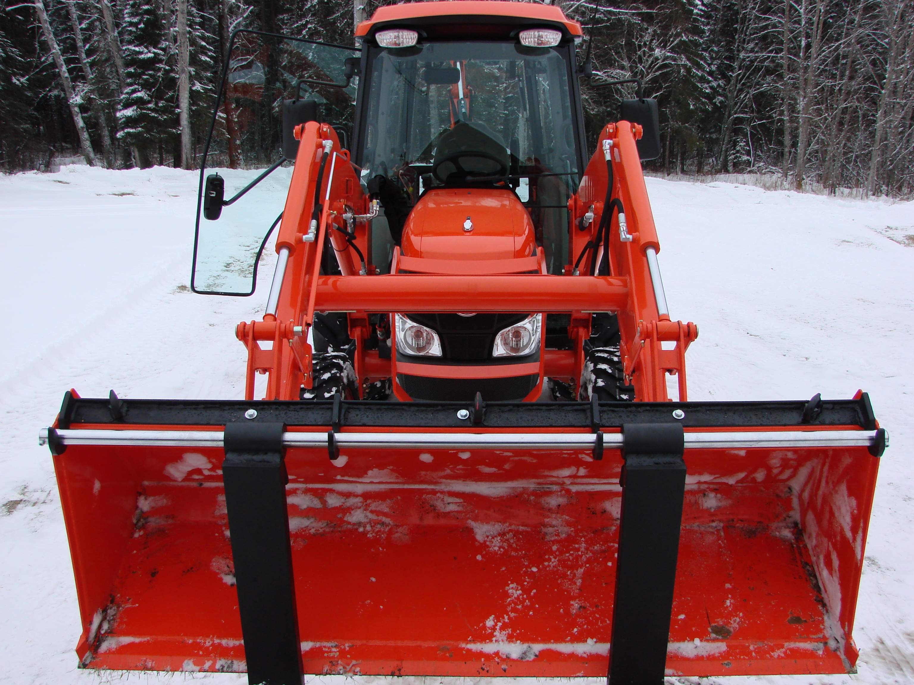

Here's my contraption........ is there a way to have pics saved in profile for others,,, ?
/ FEL quick attachment ideas #24
The picture you saved in profile, came from somewhere, maybe My Pictures, etc. If you look at my profile, that picture was resized and saved in My Pictures, and then I can use it wherever.
You can also do a right click on just about any picture and save it to My Pictures.

That is a nice set of forks, How long does it take you to put you FEL back on?

/ FEL quick attachment ideas #27
wrong photos
Yea that is a great setup also!

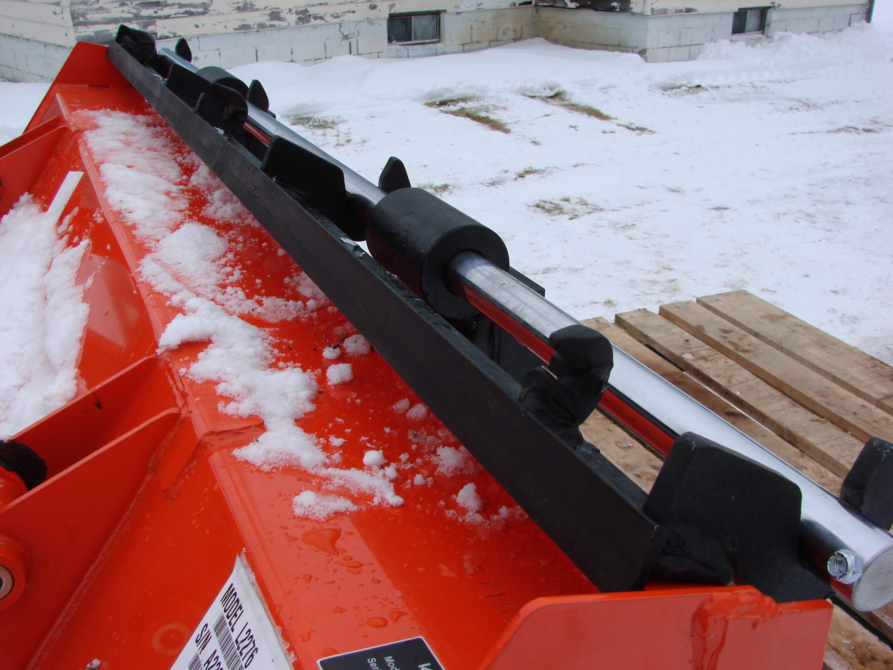

Just from looking at the picture with the pallet.
When you raise your bucket the pallet will stay level, RIGHT.??
I had a set that clamped on, but didn't like them so i sold them a friend that had a smaller tractor.
I am planning on building a set._____Thanks for the pictures.
/ FEL quick attachment ideas #28
wrong photos
Also Welcome to TBN!
When you take them off, do you lower you bucket to rest the forks on the ground,~pull a pin and slide the shaft out.??
/ FEL quick attachment ideas #29
No they just rest on ground tilt bucket slightly forward,, and lower bucket,, drive up and rev. sequence to attach..

Wondering if you purchased the forks and attachment or made it yourself.
Thanks
Wayne
/ FEL quick attachment ideas #32
Old forks from work, and build the rest, machined 2 mech. tubing to match shaft,, weld hooks ,, cut chrome shaft...
