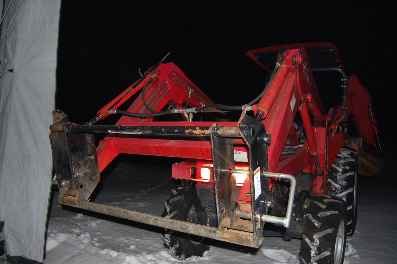

Here's my contraption........ is there a way to have pics saved in profile for others,,, ?

wrong photos
Yea that is a great setup also!
Just from looking at the picture with the pallet.
When you raise your bucket the pallet will stay level, RIGHT.??
I had a set that clamped on, but didn't like them so i sold them a friend that had a smaller tractor.
I am planning on building a set._____Thanks for the pictures.
/ FEL quick attachment ideas #28
wrong photos
Also Welcome to TBN!
When you take them off, do you lower you bucket to rest the forks on the ground,~pull a pin and slide the shaft out.??
/ FEL quick attachment ideas #29
No they just rest on ground tilt bucket slightly forward,, and lower bucket,, drive up and rev. sequence to attach..
/ FEL quick attachment ideas #30
OK.
I went back and looked at the picture.
Thanks!

Old forks from work, and build the rest, machined 2 mech. tubing to match shaft,, weld hooks ,, cut chrome shaft...

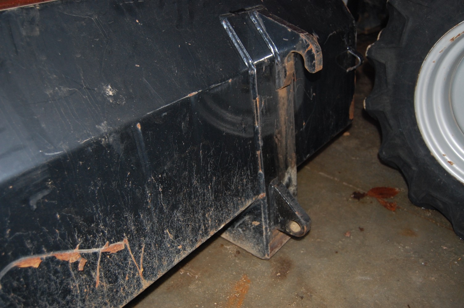

Well, I would like to apologize about not following through on my post back on 2/24/07. I described about the quick attach I have and asked if anyone would like pics and there was some replies about liking to see pics. I didn't realize that I never followed through until another member recently contacted me about my quick attach.
I did take pics tonight if anyone still would like to see.

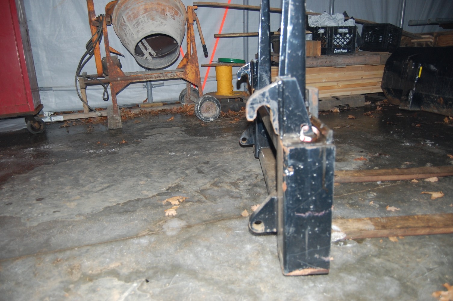

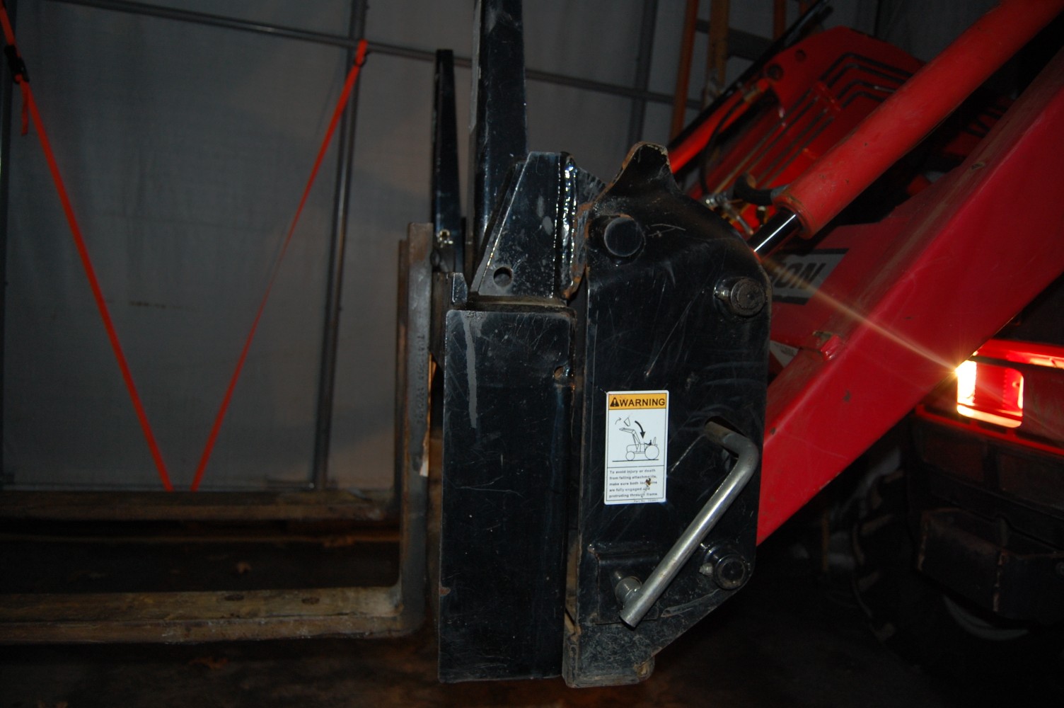

Here are a few pics, I have some close up's of the pins if needed.
Thanks,
Dennis
