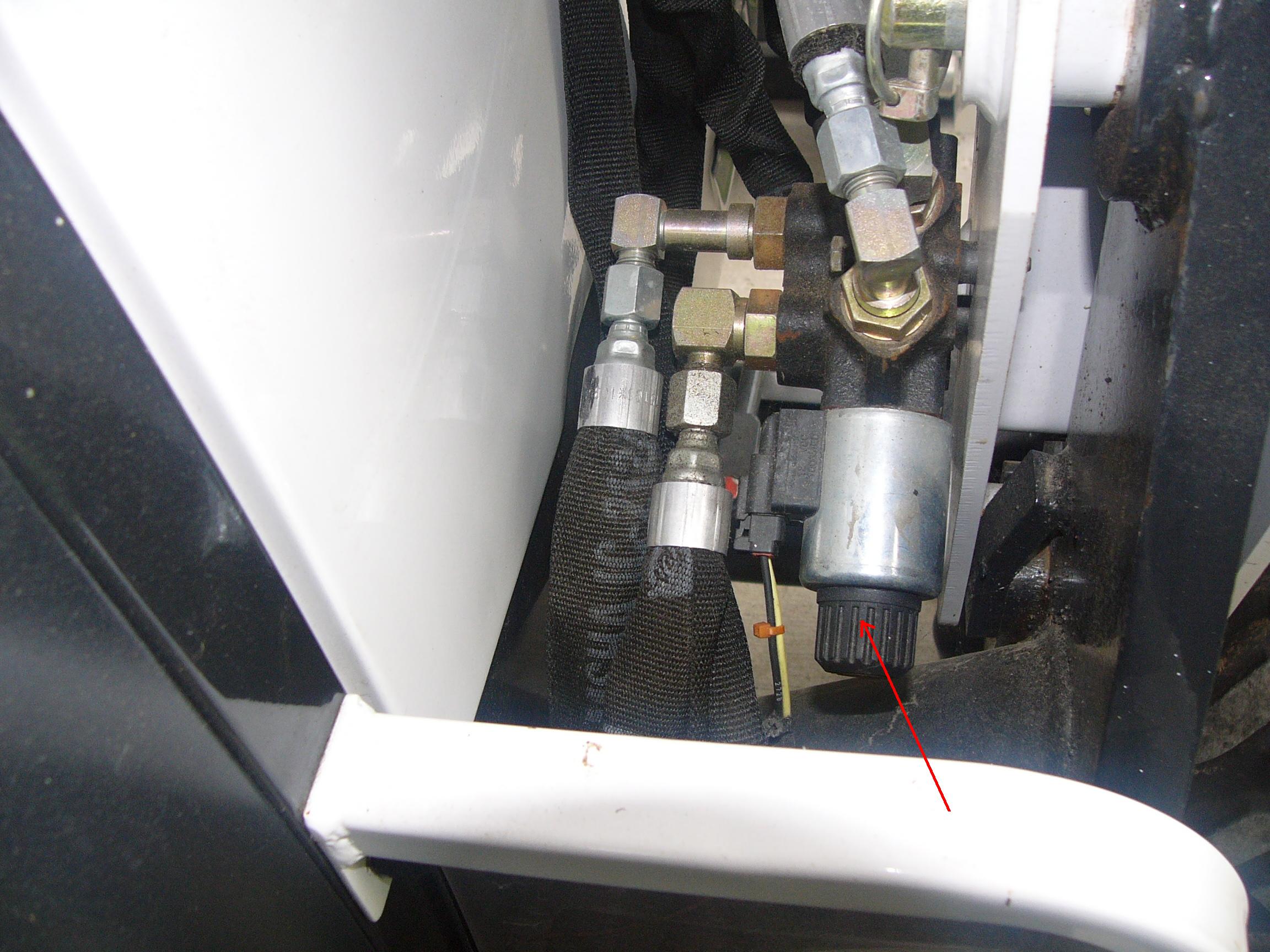

I'm assuming you're going to offload both the bucket and loader arms as one piece? I'd get it where you want it to sit, lower the support legs and get them set, and as stated undo the hydraulic lines once you have the loader disconnected from the support structure and the pins are removed from same. Don't move too much beyond getting everything undone so no damage occurs to your FEL hydraulic lines. Once you know you're set and can back out from the FEL, then disconnect your hydraulics, AFTER using the locking mechanism just below the FEL's control stick. This will keep you from bumping it accidentally while you disconnect the QDs under the right side floorboard.

Not sure if I did it when removing the loader, but before disconnecting the backhoe cycle the joystick to relieve the pressure from all the hoses. ( with the engine off )
If you don't you will not be able to reconnect the lines without relieving the pressure. Putting a rag over the female connector and hitting the nipple with a hammer usually will relieve enough pressure to reconnect the lines.
