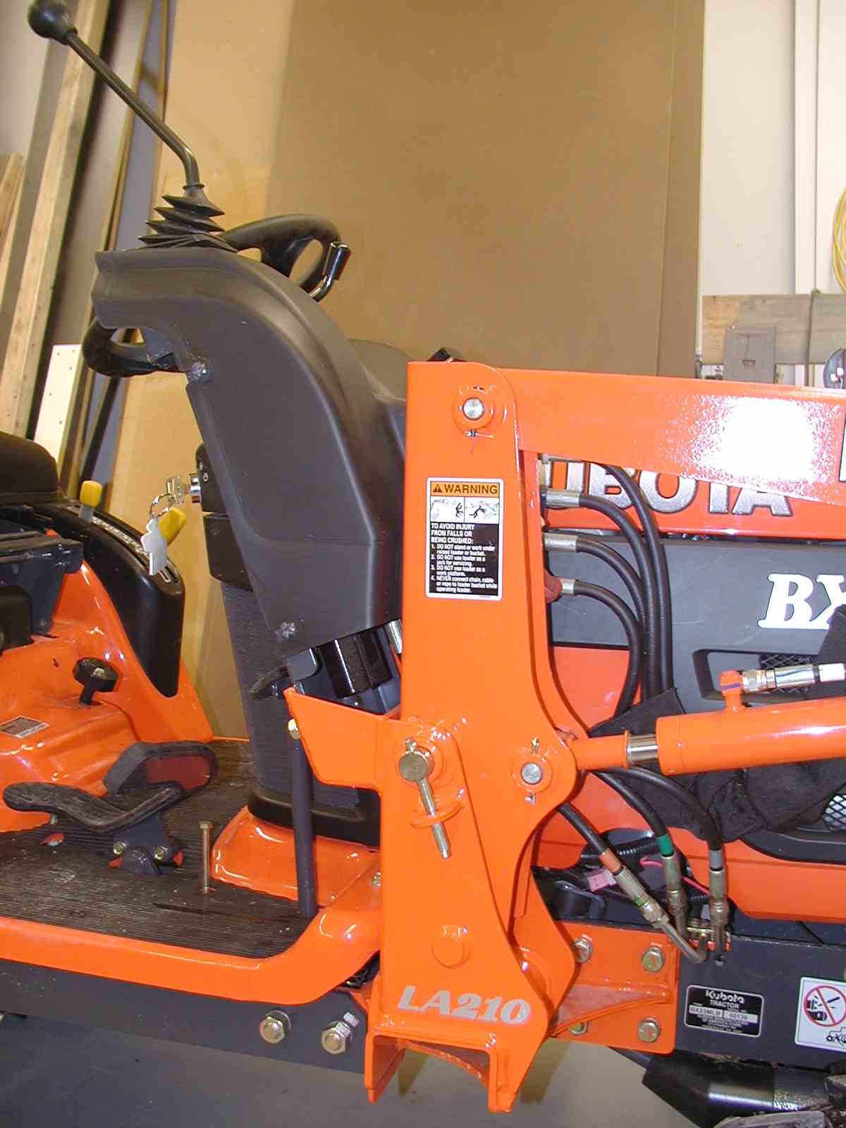

I just got a BX23 with BH & FEL, and have to wait another couple of weeks for the 2750 snow blower. I have been reading this thread to understand what the process of changing from FEL to blower will involve. It seems that Kubota has changed the BX23 from the BX22 and similar so that the 4-position valve always stays on the tractor when the FEL is removed (photo attached). In other words, it seems like Kubota has taken the ideas from this forum and included them in the latest version.
Can anyone who is familiar with the BX series confirm this?
Thanks
   / fel removal with fel question #20
You are correct..... Kubota finally got it right and figured out that the loader control should stay with the tractor when the loader is removed because it is used with other attachments. They also have discontinued the old 3 way valve and the 4 way is standard with the BX-23. Who said that an old dog couldn't learn new tricks.... Let us know how you like the blower.. and don't forget your ski mask for when the snow starts blowing back at you... /forums/images/graemlins/blush.gif /forums/images/graemlins/grin.gif
