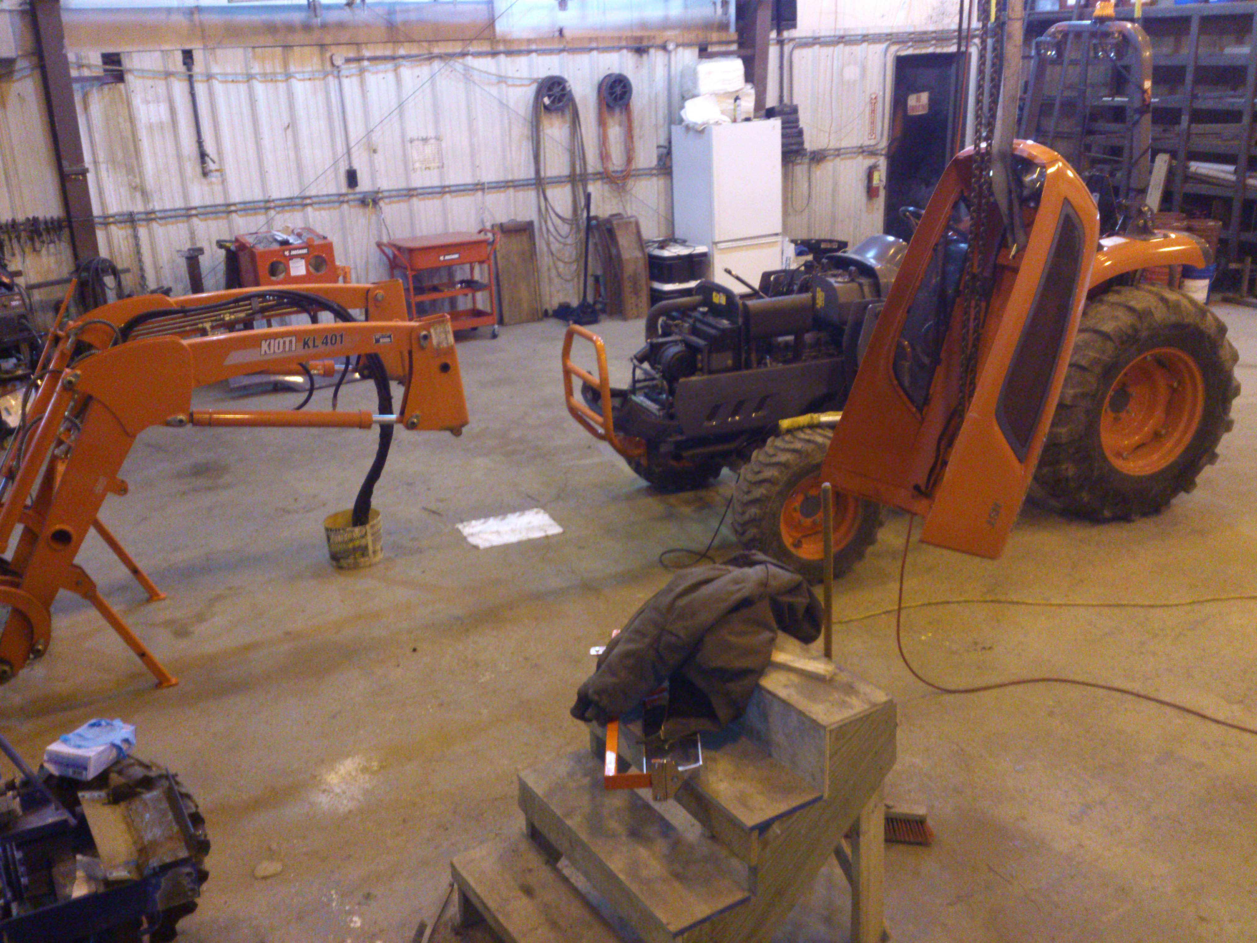

Took the FEL off my 07 DK45 today. I bought used and have had tractor for a year and half. Came off just like manual said it should. I do believe this is the first tme the FEL has been off this tractor since install. There was no sign of any lubricant in the pins and they were starting to corrode. I cleaned everything up and lubed the pins and bottom of FEL. Glade I had to remove FEL for another repair. Not sure I could have gotten the pins out in another year or two.

I will say installation was not quite as per manual. I had to use a crow bar to raise back end of FEL about 1/32 of an inch to put both pins back in. Other than that just like manual says. Far eaiser than expected. I have also weided a commericial wear blade on end of FEL bucket that may have made back end of FEL sit lower in Brackets. Wish I had taken some pics, but had too much time invested on taking pics for another repair. If you want to do this help is at your finger tip., I will say far easier than I expected.

seacap, I've never removed the FEL from my 06 DK45s so I'm interested in your experience. I've heard the critical thing is a flat surface to R&R the FEL. What kind of surface were you parked on?

DSC_0217.jpgI am lucky to have a big shop with smooth concret floor. I think any firm level suface would work. Firm so the bucket edge and suport legs don't sink in. Fairly level so that the FEL will go back into brackets evenly. The back end of Fel is not too heavy and fairly easy to move a little by hand. Good luck. I also really cleaned around the hydraulic disconnects with brake cleaner before I disconnected.
