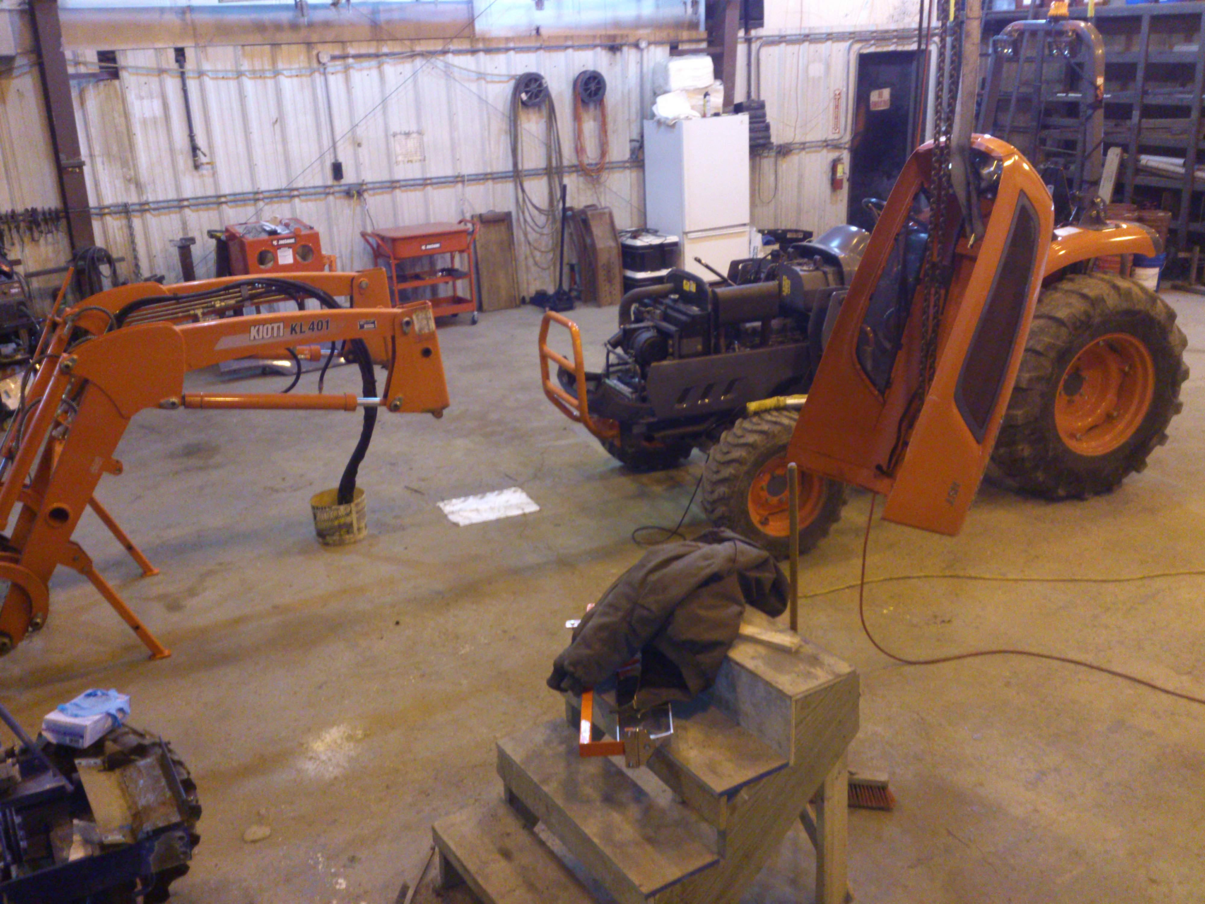

Having trouble re-connecting 2 of the hydraulic lines. Too much pressure to connect. Any way to relieve the pressure?
/ FEL removal #22
Push hose ends against the tire.
/ FEL removal #23
Ballpeen hammer and flat punch, hit the center pin on the male and female end to relieve pressure. Just use a rag around it b/c the hydro fluid will spray.
/ FEL removal #24
Watch your eyes when it goes off.Wear glasses
/ FEL removal #25
For future reference, if you're going to disconnect the FEL get it to where you are about to disconnect the lines, and with the tractor turned off, move the joystick in every direction to relieve the pressure in the lines, THEN disconnect the lines.
/ FEL removal #26
ive also noticed that if i wait for the tractor to cool down...like the next day. the hoses will press in without any issue. the hydraulic temps in the tractor have expanded the fluids and increased the pressure (i am guessing) and when it cools the pressures decrease.
i also disconnect and leave my loader in the shade now on. dont have issues with pressure differential any more.
