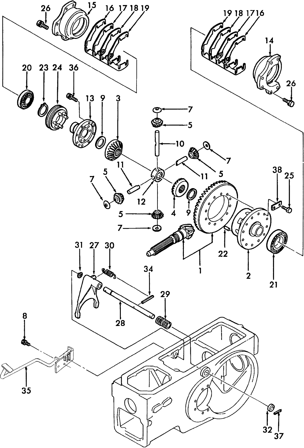

On mine(TC35D) it is behind my left foot - just a black "L" shaped rod.
On the TC48DA, the differential lock is on the right side of the transmission, probably toward the rear of the operator platform. An illustration is attached (item #35). On HST tractors, the diff. lock is on the left because you have to use the HST pedals on the right. On gear transmissions, the diff. lock is on the right so you can use it and the clutch on the left at the same time.

Okay, I saw that pedal. It's a little orange foot pedel right hand side just below the seat. I'll use that first before the FEL next time. :thumbsup: I love this tractor! Food Plots to plant next!
