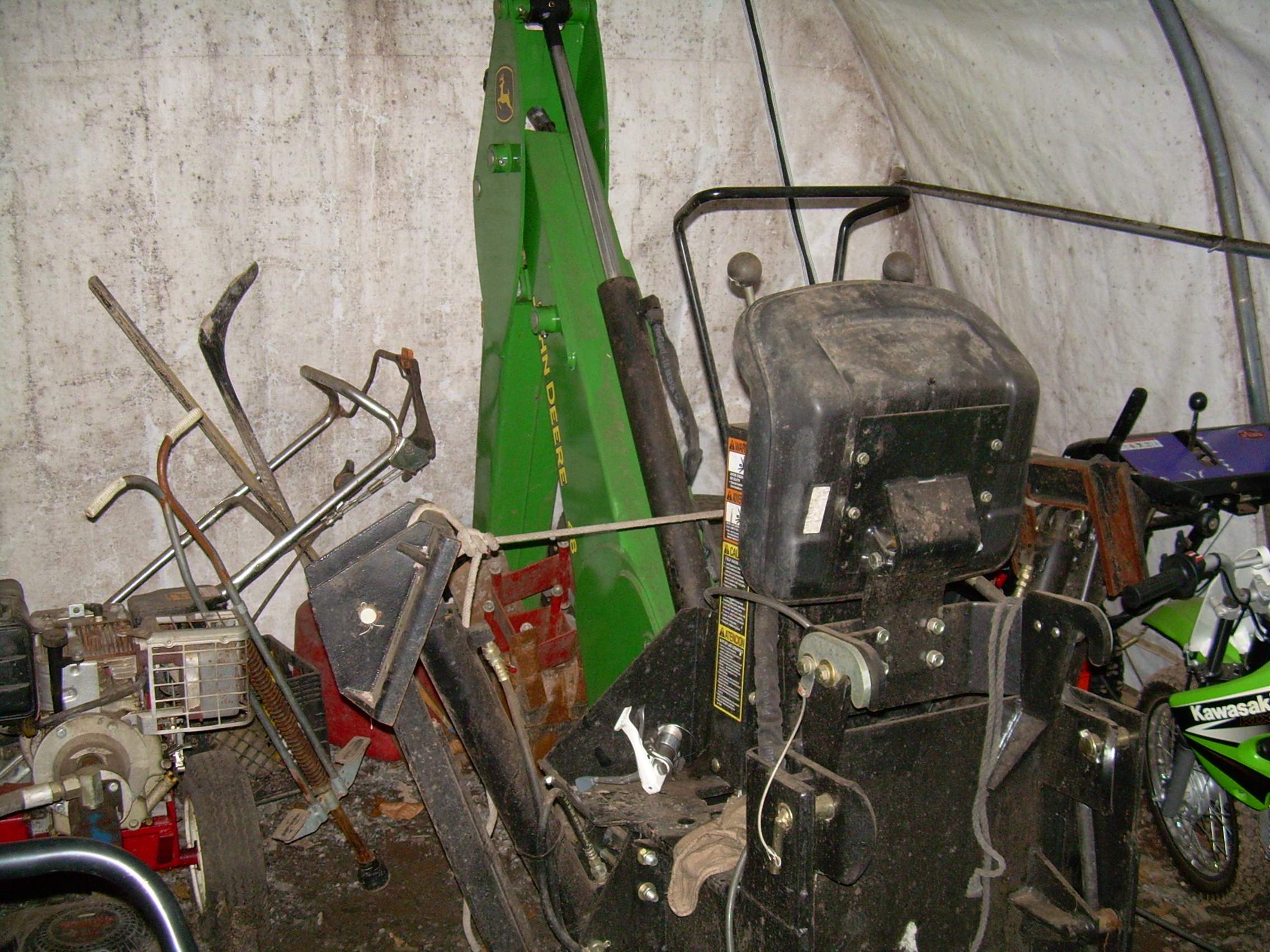

I keep my BH in one of those tent type garages, the conditions in there are not much better than outside sometimes with the humidity, everything gets mildew on it.
I was worried about the bare cylinders also as they were showing signs of spotting, but they cleaned right up with one wipe of an oily rag.
