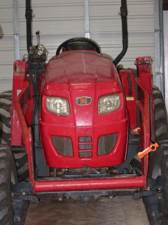

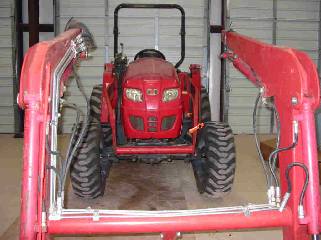

Has anyone had trouble with the subframe for the FEL bowing at the sides. Mine (ML108H on 2810HST) has bowed enough that the hydrolic cylinders rub on it as the bucket is raised or lowered. I HAVE been using it to push down some 4-5inch cedar trees....but I would have thought it should have held up to this. I've removed the FEL, disassembled it and am planning on trying to straighten it. If this isn't possible, it appears these units are made in Kansas...so I'll call and see if they'll sell JUST the subframe. In either case, I plan to heavily reinforce the arms and add a brushguard!!

The "subframe" that I'm talking about is the U-shaped frame that the main "bucket frame" and hydraulics mount to. It slips into a channel at the front of the tractor and bolts to the underframe with just 2 bolts. And it is definitely bent. I removed it and it is pretty twisted. I checked with the manufacturer in Kansas, but they can ONLY sell through Mahindra.....so it may be fairly expensive. I'll let you know what I find out on a price. It may be time to re-engineer this thing by cutting it apart and rebuilding it stronger than it was originally!

Here are some pictures of the bowed/bent subframe arms on my 2810. As you can see, the FEL has been removed. It was only designed for lifting...NOT pushing.....but I plan to remove the current arms and replace them with 2 pieces of pipe (drillstem) on each side forming an "A" shape tith the top of the "A" at the front of the frame and the 2 lower portions welded to the upright that attaches to the tractor. I'll post those pics when I gewt it done in a few weeks.
