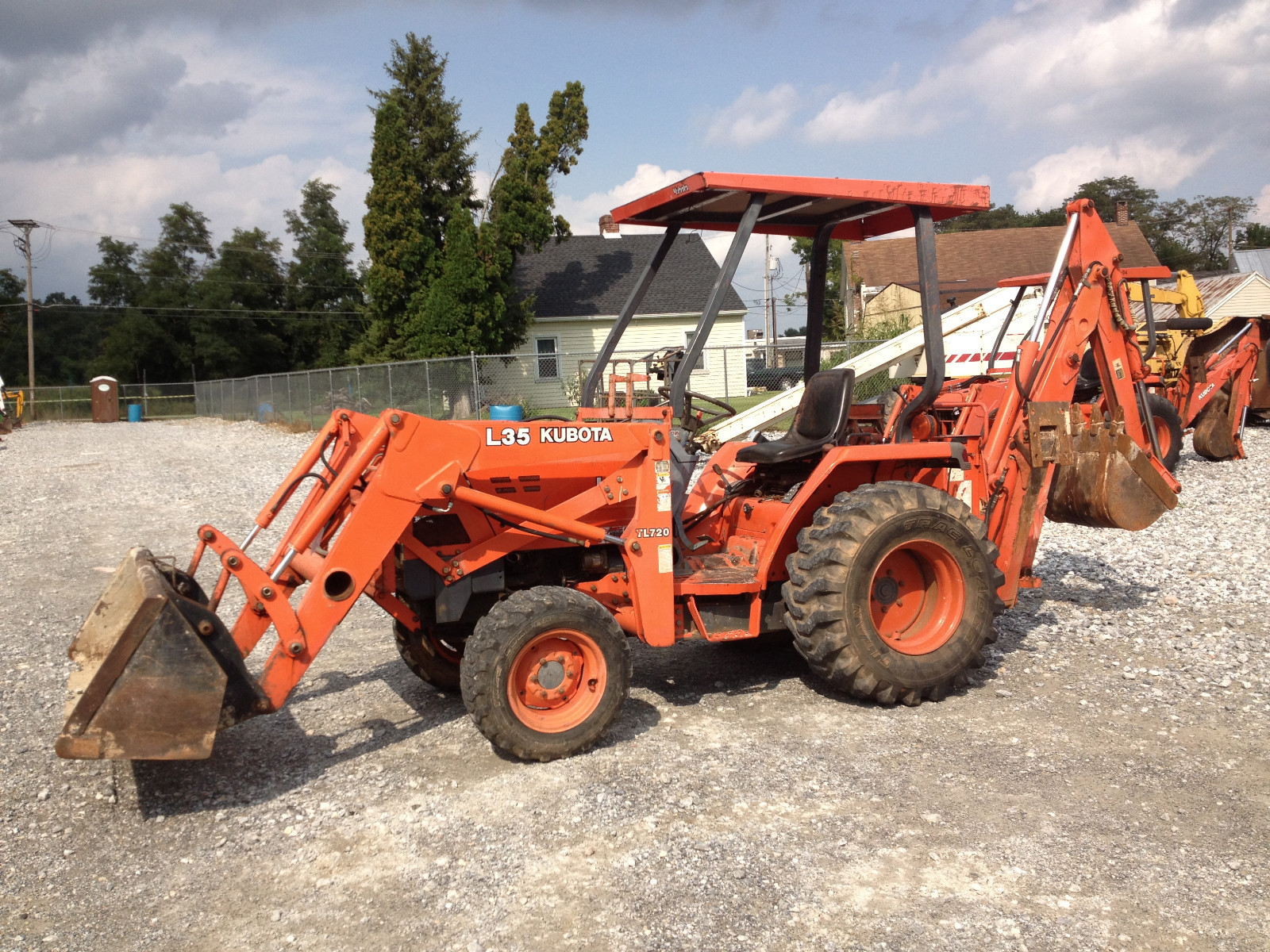

The picture of THAT 4 bar does indeed increase dumping angle, but at a decrease of force.
Thats not the typical 4-bar I see. Like on my BH and the one posted in post #5 by xring100. When the upper bar is mounted inline (same pivot) as the cylinder, there is no mechanical advantage.
The pic of that L35, the upper bar moves at a faster rate than the cylinder. If you were to reverse where the upper bar and cylinder are mounted, you would have much more force, but less range of travel.
Yep you've got this more direct approach to a 4 bar linkage The main disadvantage I see of this style is the additional height required for this linkage can obstruct view
