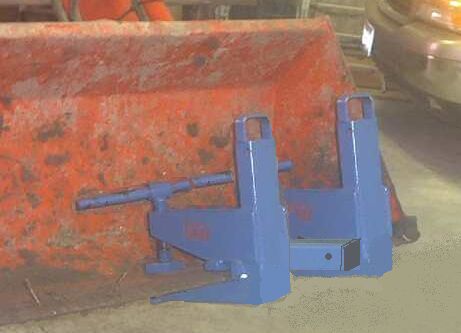

I'm thinking about a clamp-type removable receiver hitch (similar to clamp-on bucket bucket forks) which mounts on the bucket. Easy-on, easy-off. Just to test my idea, I c-clamped a receiver itself with a ball attached to my bucket. It worked pretty good until the load shifted and the clamp couldn't hold sideways forces. One problem though- I could not see the ball from the "drivers seat".
   / FEL trick #8
OK, I had a little time on my hands and butchered up Alan L.'s bucket fork picture. Alan L., I hope you don't mind. Here's my concept (see attachment).
John
