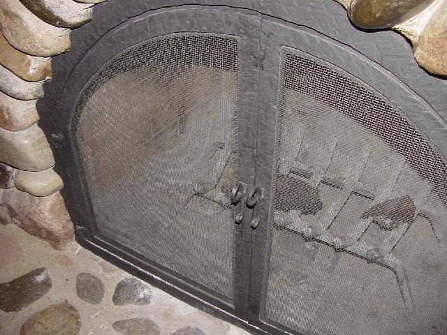

awright osarker,
This is on a floppy I had close. It's a fireplace screen I made couple three years ago. Customer wanted a custom screen for his custom fireplace in his new custom house.
I suggested he bring me a pattern.
He did.
I started off with a piece of three eighths plate four feet by eight feet and his pattern made of three eighths plywood.
I made one trip up and that was to install it.
All I had to do was do a test fit. Mark where to weld some tabs to attach it to the rocks. Go out weld the tabs on. Come back in and put it in place. Drill the holes and put in the anchors, pick up the check and leave with a customer for life.

I want to talk to that fool that says an old dog can't learn new tricks!!!!!!!
   / FEL trick #24
Re: Examples
Beautiful workmanship... /w3tcompact/icons/blush.gif

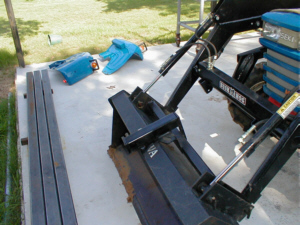

I saved this drawtite hitch from salvage and just had to do minor "adjusting"
I tried a boom pole idea, but it bent just outside the receiver.
Can you elaborate on your ideas of support from the bucket bottom?
