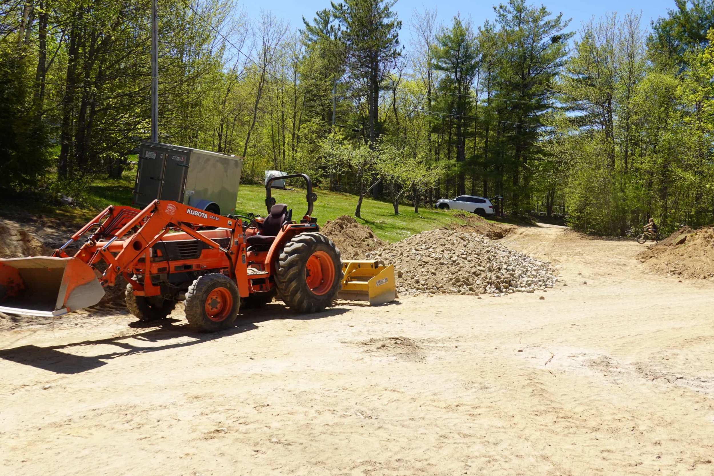

Your FEL bucket can scoop up loose material from a tall pile, then transport the loose material to where you want it. To safely carry a max load in the FEL bucket, Three Point Hitch counterbalance to the dirt laden bucket is necessary. A Box Blade is one of the most common implements used as TPH counterbalance to heavy FEL loads.
Wet dirt is much heavier than loose dry dirt. Gravel is heavier yet.
I regularly transport bucket loads of tree debris 1/2 mile one-way to a community burn pit.

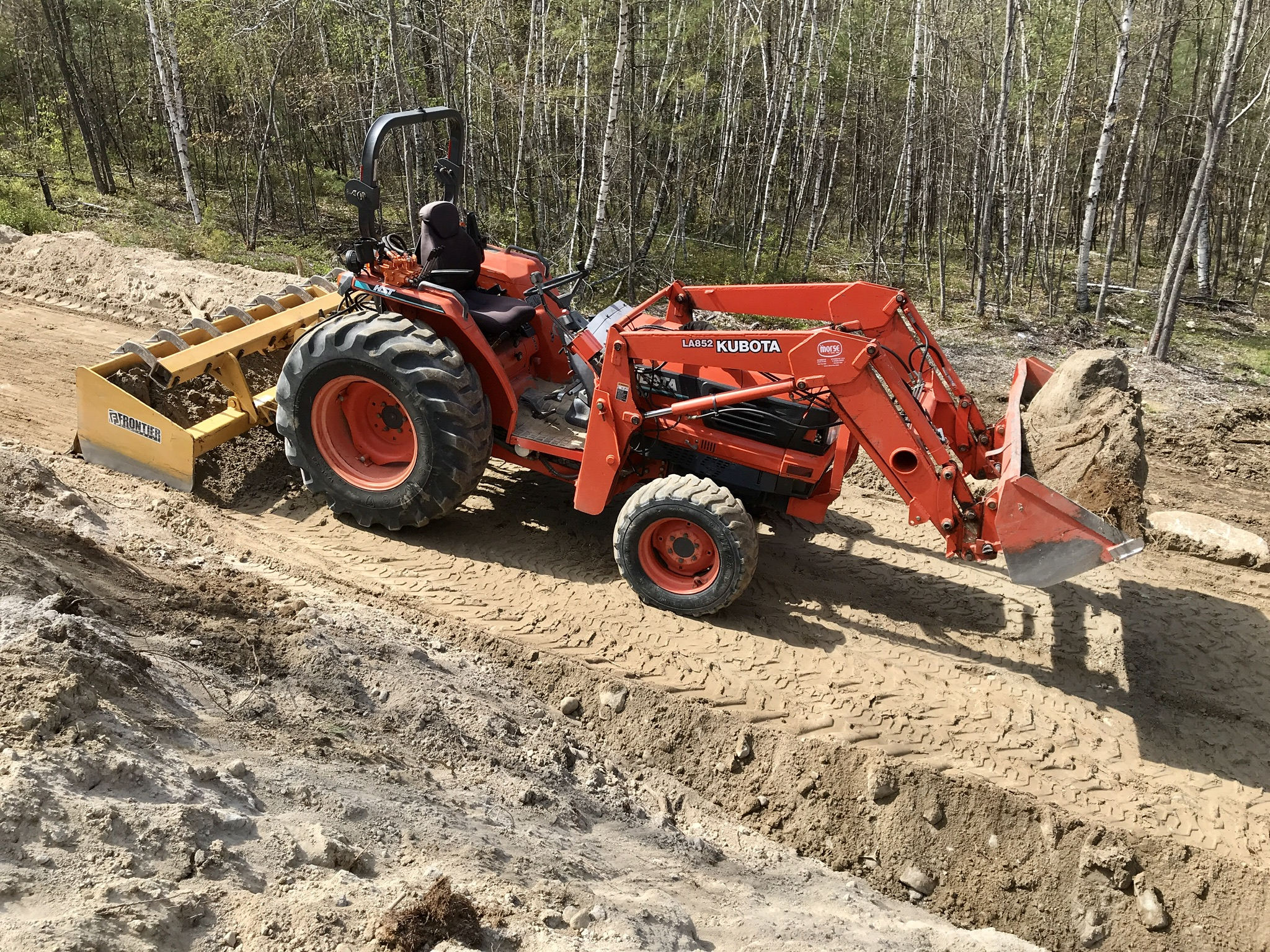

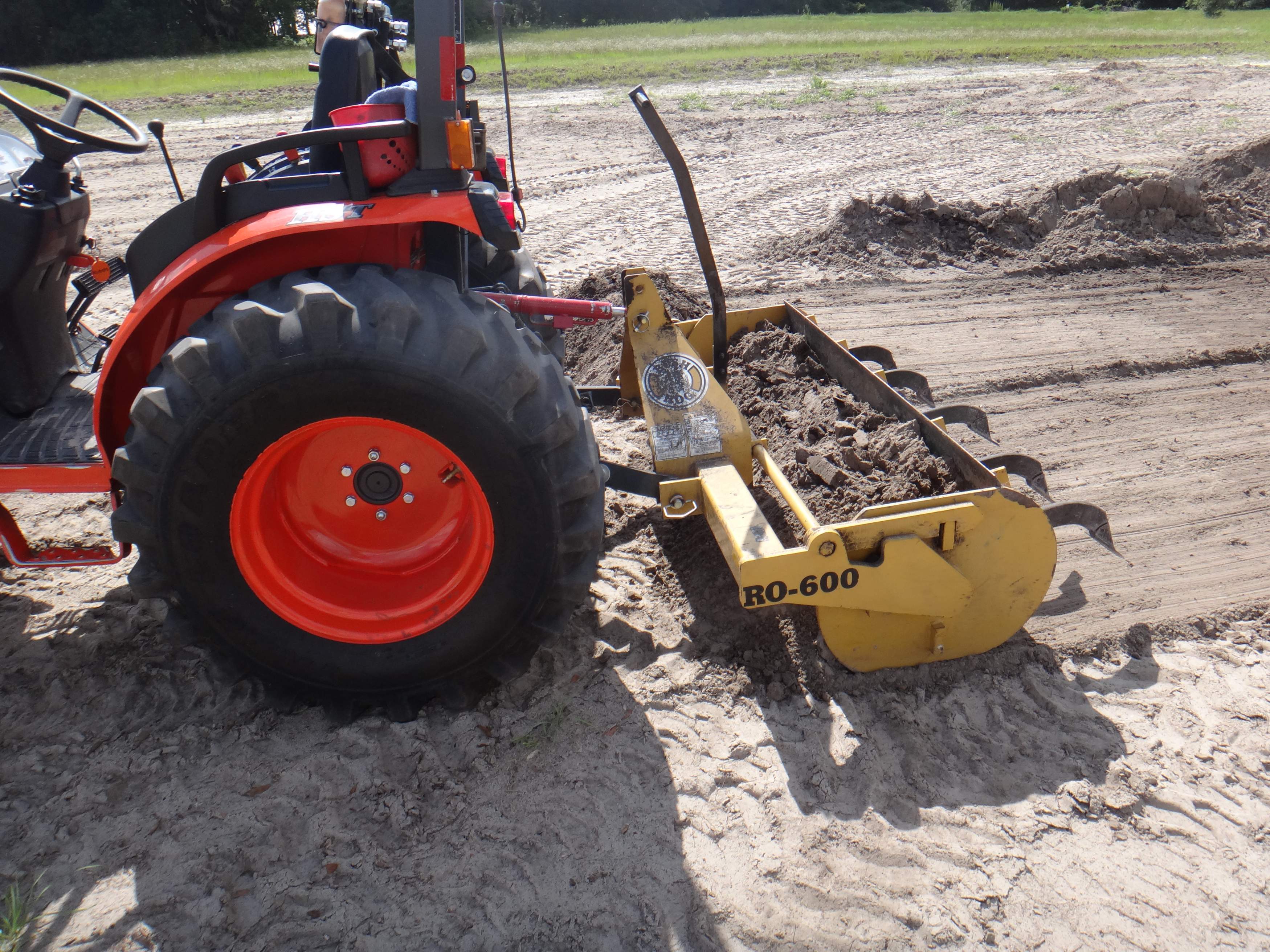

A Box Blade peels 1" to 3" layers of dirt, which accumulate in the box. Your cannot transport dirt from a pile until the pile is reduced to ~ 4" height. Transport distance for a Box Blade is usually just a few feet, from one part of the work site to another part of the work site close by.

Tractor FEL is delicate relative to the tractor Three Point Hitch. Heavy tractor works should be accomplished utilizing Three Point Hitch implements.

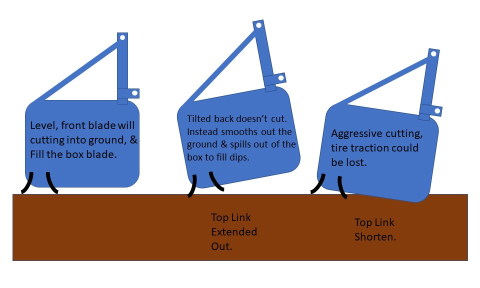

Yes, but you need to know how to use the box blade, too. Also, does your FEL have the ability to "float"? Using the float feature while back dragging with the FEL also helps to level things out. I will back drag with the FEL with lots of weight in it to work better (full bucket of gravel helps with extra down pressure).
Box Blades, you'll need to know what effects the length of your top link does for the cutting edges of the blade:

As shown in the movie and graphics up above, angle of attack is key to box blade use. Having a hydraulic top link (or an easily accessible/adjustable turnbuckle top link) will give you very precise control over how the box performs. I have a hydraulic top link and I am adjusting it hundreds of times a day when doing grading work. I can fine tune what I want the box to do and I can fine tune the behavior for forward operation or reverse operation, on the fly. It significantly improves the productivity of the box blade.
