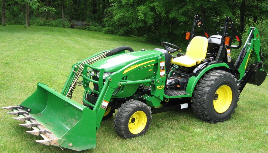

JD makes a bolt-on toothbar for a 61" bucket that fits the 200cx 61" bucket very nicely. It cost $300 installed by my dealer.

Interesting, the dealers out here did not offer that, they instead offered an ATI tooth bar. Oh well that tooth bar looks pretty good. Does it have replaceable teeth?
   / FEL w/ toothbar or not??? #18
I have a JD toothbar.... its teeth are replaceable. It is extremely heavy duty... I can't imagine breaking a tooth or wearing one down so much that it needs replacing.
   / FEL w/ toothbar or not??? #19
Yup, the teeth are replaceable. Neat piece, has been more useful than I had imagined.
