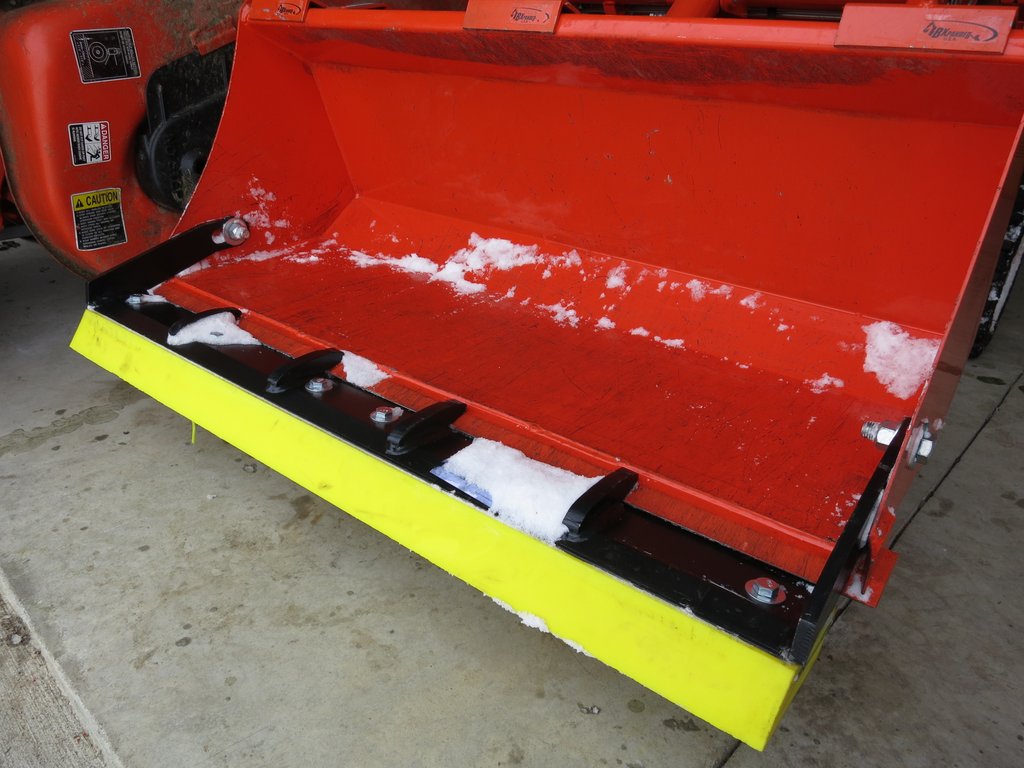

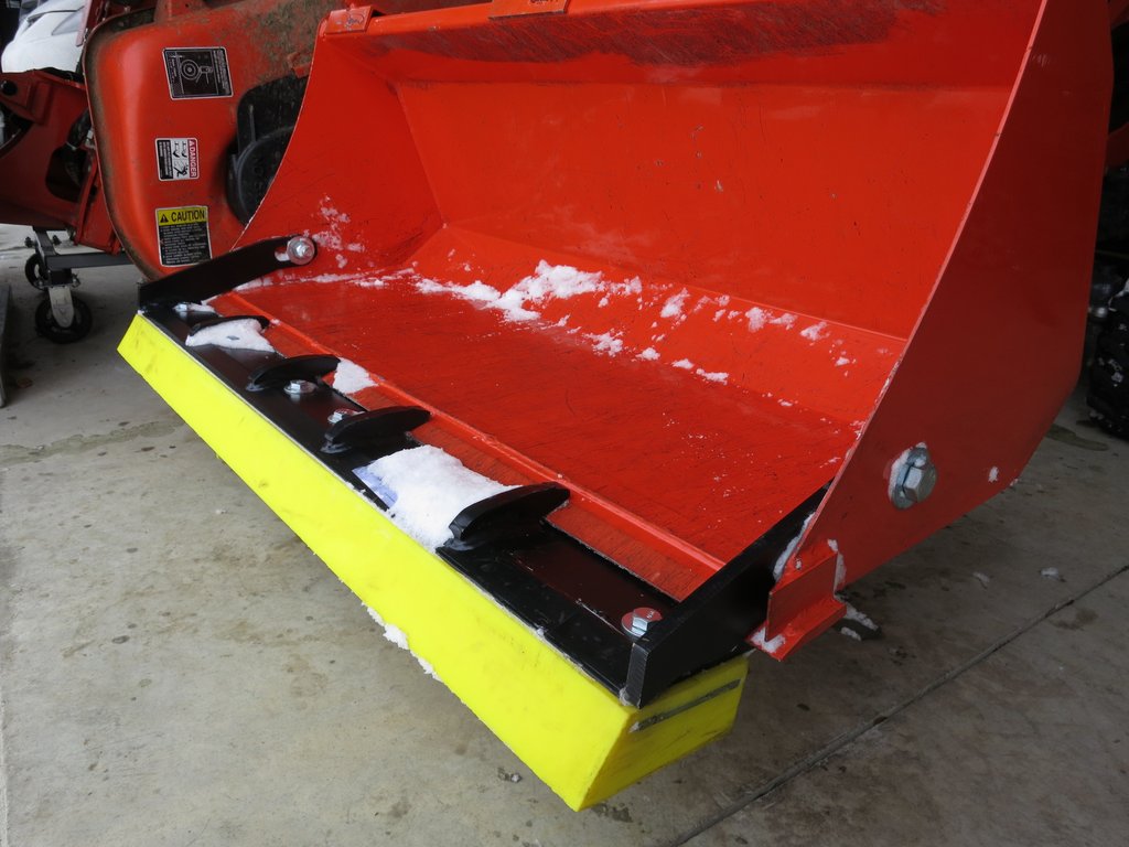

I bought a wear bar for my BX which I leave on all the time, but also drilled holes in that so I can put a urethane edge on in the winter so I don't tear up the concrete. The only regret is that I didn't totally understand how the urethane edge would be attached, so I ordered it with measurement for the inside of the bucket instead of outside, but not a big issue. Attached are some pics of the wear blade with edge attached and also the lighting I wired in at the same time.
