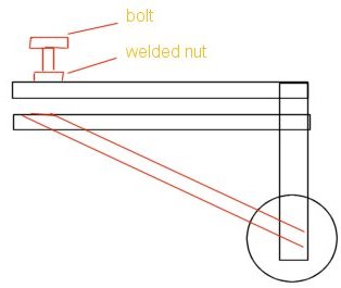

1950 VAC tricycle with FEL and haven't found no reason to want more traction other than lower gears.
