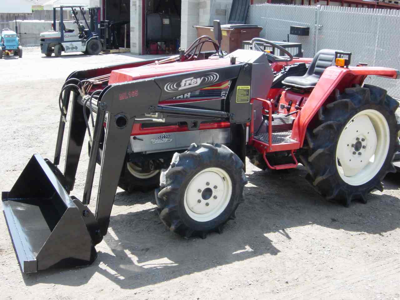

/ FEL's #6
This is what it looks like with a Frey.
Buck

/ FEL's #10
Buck
Buck,
I like the way the Frey bucket is tucked in close to the front tires
I have always wondered why ALL loaders arent built that way.
It sure makes the tractor a lot more stable.
/ FEL's #11
I also saw how close the Frey bucket was to the front of the tractor and I'll second Ernie's last comments. The closer the bucket is to the front axle, the lower the weight transfer on the front axle. The Koyker on my tractor has the bucket mounted out far enough it equals the wheelbase. Every pound in the bucket is 2 lbs on the front axle.

/ FEL's #13
tractorErnie said:
Buck,
Wow Buck, just like Ernie (and Mickey) I saw an immediate and advantageous design in Frey's loaders. With their bucket fully flat and on the ground it's quite obvious that their front loader arms are nearly at 90° where most other manufacturers are at the lazy 45°.
If you're not quite sure of what to look at, check out the length and orientation of the dump/curl (front) hydraulic rams!

/ FEL's #15
runningbird said:
I have looked at the frey loaders also, But Frey tells me they do not make the mounting brackets for yanmars. Buck are you making your own brackets?
thanks
Mark
After installing Koyker’s I truly appreciate the Frey loaders. We do build our own brackets for the Frey but we were building our own brackets for the Koyker’s anyway. On average we could get the loader 6" to 12" closer to the tractor if we built the brackets in house. With the Frey we can get the bucket even closer than that. maybe as much as 6 more inches. The only parts we were using from Koyker was the loader and bucket. Our hose kits are built in house and we use an American valve that has a lifetime warranty and that will stay the same with Frey.
For me it is not about increasing lift capacity so much, it is about limiting the stress the front axel has to endure. Also like you already know most of what we sell does not have power steering so the closer the better.
In a few weeks we will be mounting the new Vertex high lift Frey loader on our new Deutz 80 and 100hp for handling the big 4x4x8 bales of hay they use around here. Go to Frey’s web site and check out the video it is crazy. If you want I can post pics when we get it installed.
