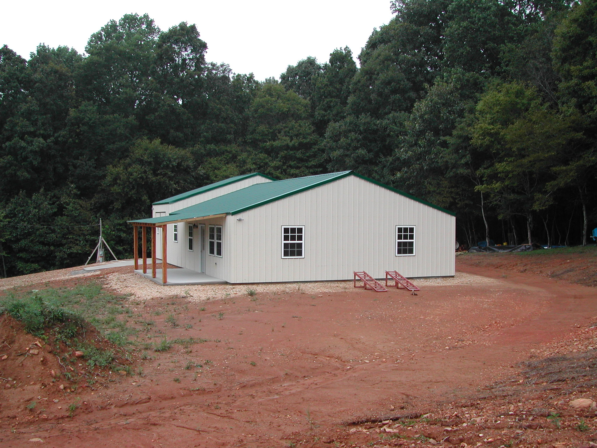

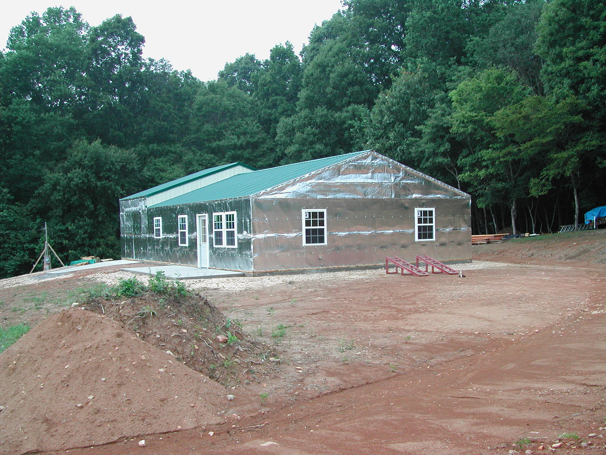

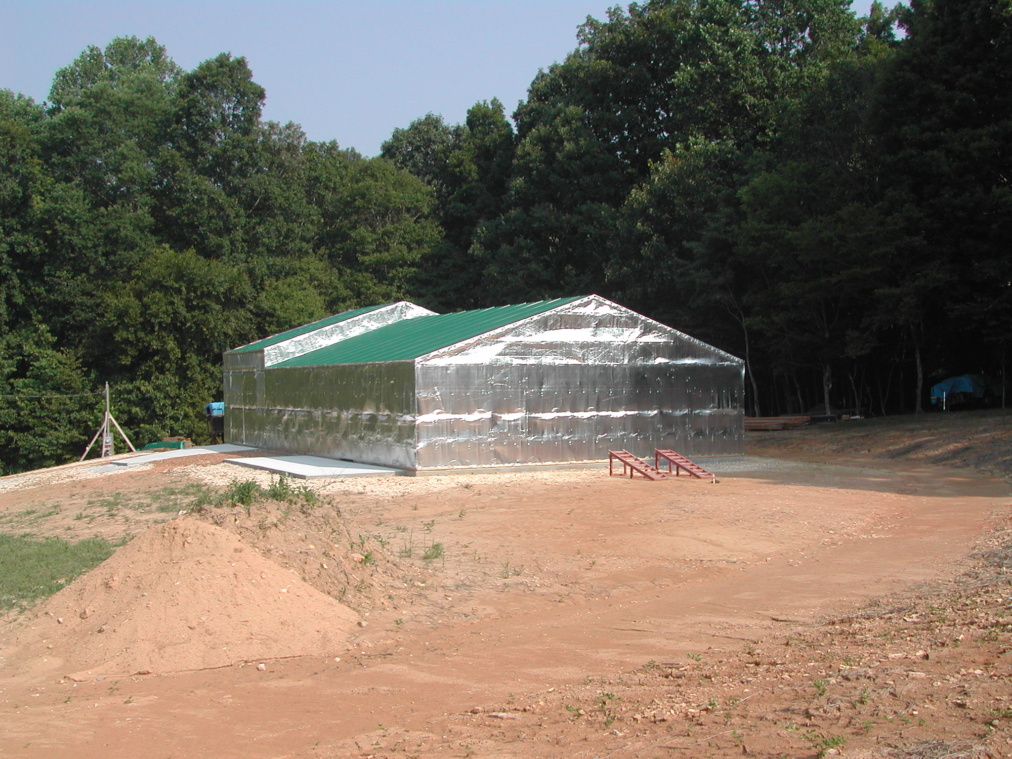

In 2006 when I built my house by myself I used 1x4x16' pine lath boards - they were a whole lot easier to install by myself than plywood and cheaper too !!! The foil bubble wrap has been an excellent choice too - mine is reflective foil on both sides and has helped with heating/cooling tremendously and is an excellent moisture barrier. All seams are taped with metal duct tape. You can't necessarily tell in the pics but the bubble wrap sags between the lath (on the roof) and leaves a small air gap between the metal and itself, the only direct contact is at the boards themselves. My framing nailer made quick work of attaching the lath boards to the trusses, the foil bubble was attached with button cap nails by hand - a little slower but worked very well. I built my utility shed with this same construction except it is a gambrel roof.

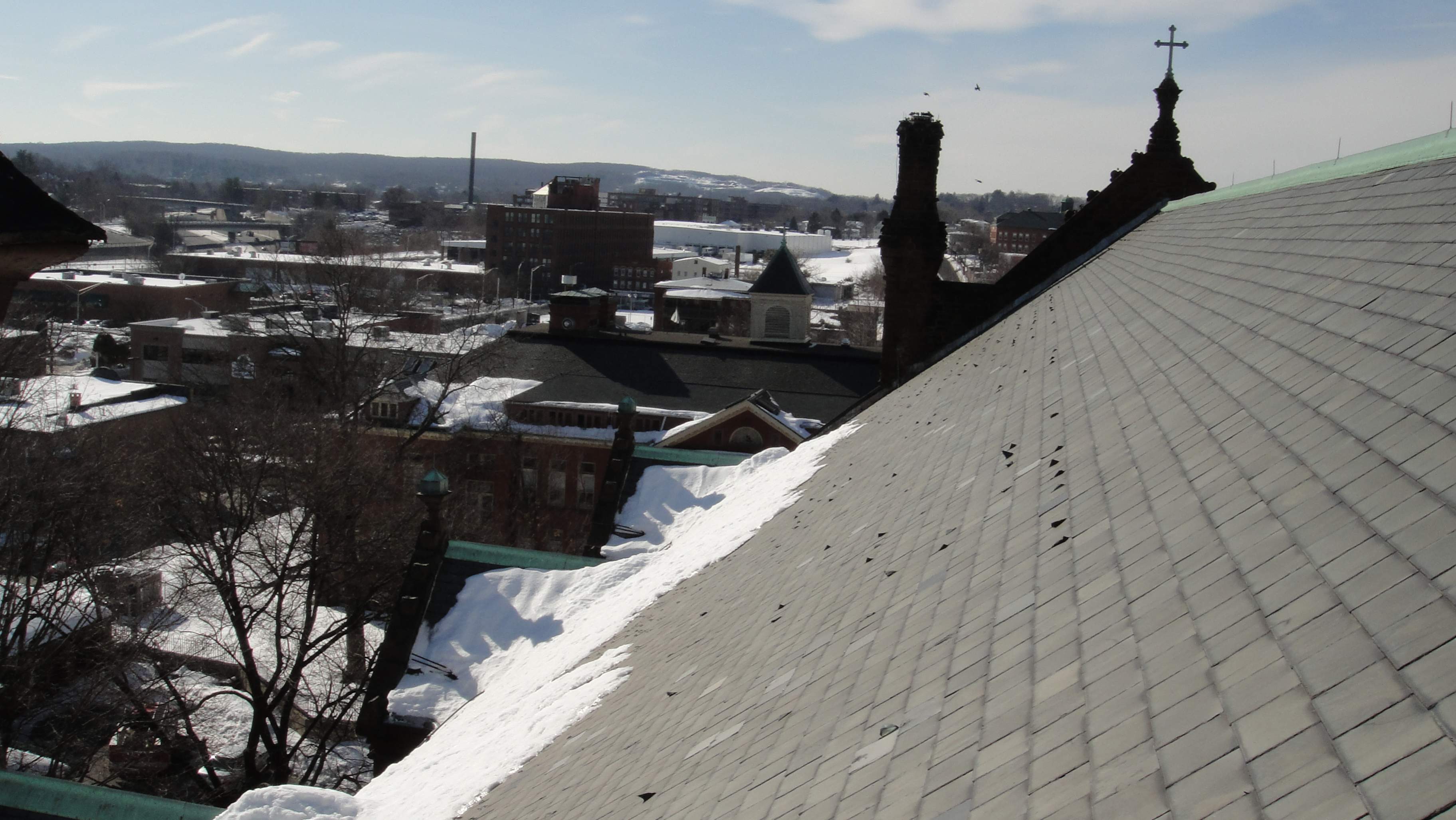

I work on old slate roofs, when they were put on 100+ years ago, of course felt was the only option. you should see what happens to felt after 125 years under slate on the south side. Pure dust if you try and move/touch it, I mean particles no larger than mushroom spores, dust!
Those roofs will leak under certain conditions due to the ancient underlayment, even though we maintain them and there are no missing slates. There's a critical 2" bib overlap in slate roofing that is not enough to always repel water when the wind blows or the snow/ice piles up.
JB.
Winter slate roof inspection, working hard. Yeah right!
Your metal roof looks great, many years of maintenance free service I'm sure.
What are the ramps for, loading materials up to roof?
That's not typical roof deck construction these days, but if it worked for you that's good. My 75 year old house has 1x6 - 1x8 tongue and groove boards both on the roof and walls. IMO better than plywood or OSB, i'm sure some will disagree, but I have never felt a 1x board roof soft under my feet like with plywood.

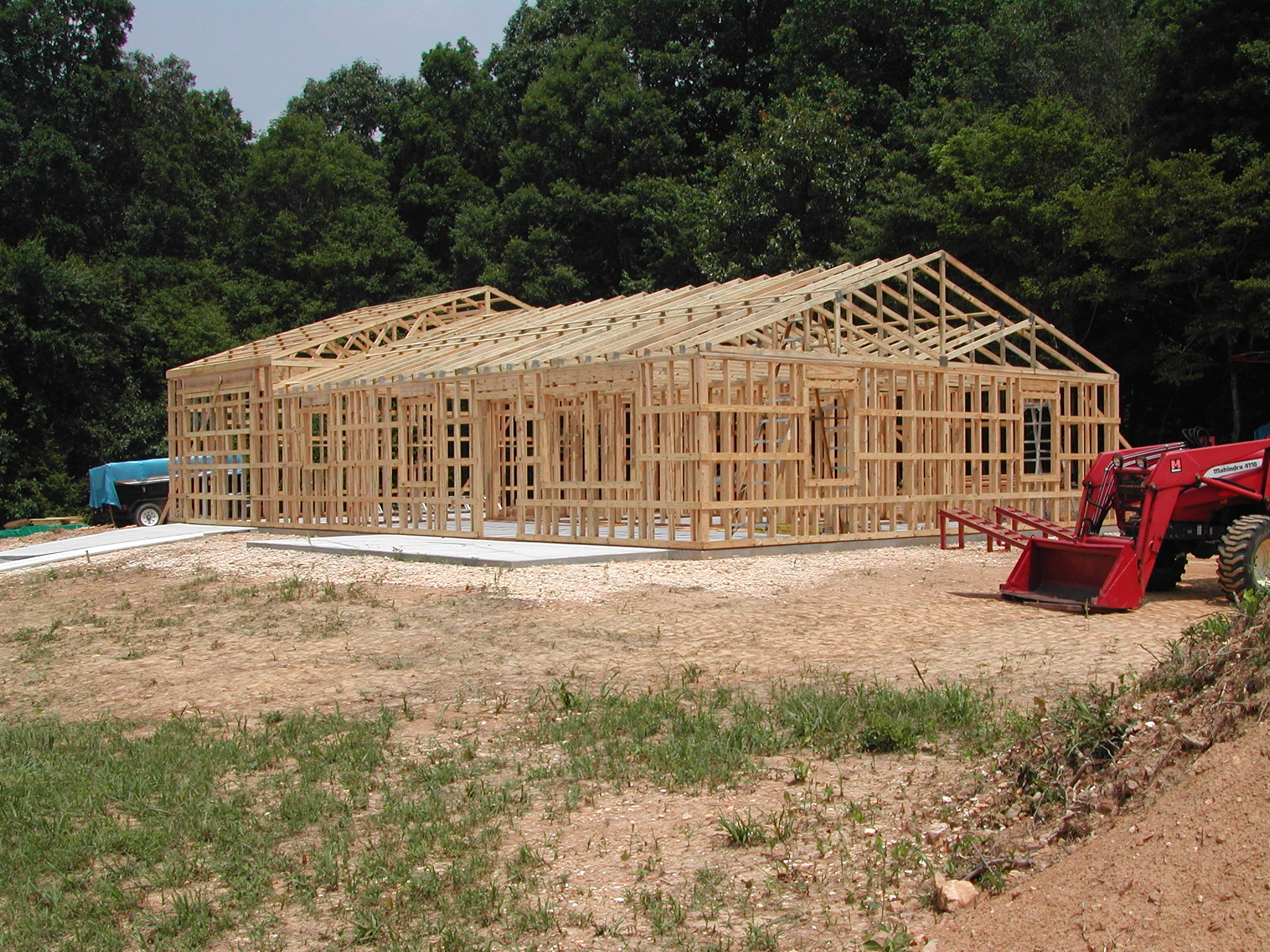

Yes, the ramps are how I got my trusses set on top of the walls, were just barely tall enough too !! I have no problem walking on my roof, of course I keep my feet over top of the 1x but if sitting for some reason I can plop my butt down anywhere with no problems. My metal is the 29 ga. galvalume.
