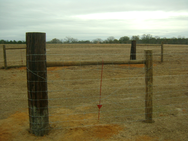

I will be building a new barb wire fence and need advice on setting the corner post and the brace post. I am thinking I need 3 post and a stub for the brace on each corner. What would be the depth of the holes to insure the post does not come out of the ground when I pull and attach the wire.

What length posts do you have? I use 8' corner posts buried about 3-1/2' deep.

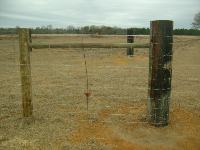

I use 2 poles with a post or 4x4 between them and wrap brace wire from bottom of corner post to top of other corner post for added bracing, I usually dig from 3' to 4' depending on soil conditions, if you have the time and can build your corners now and let them set up for a month or so before pulling your wire they will be plenty ready for your wire pull after setting up.

Same here. I put the 4x4 at the top and the X brace with wire between them. The wire rising towards the fence line is the important one. The other one just holds the posts square. I use a scrap piece of wood to wrap-tight the X brace wires up towards the top and nail it to the 4x4. I don't make my wires banjo tight like some people do, but I do get them taunt.

This is how I did the corners for my high tension wire, not sure it's any better or worse than using a metal brace.
