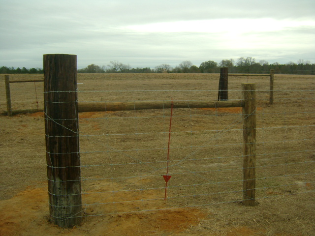

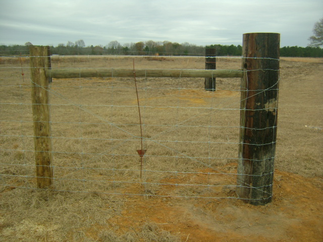

Here are a few pictures of my standard corner/pull post. I like using the big ends of used utility poles (~12 to 20 inches), 3' deep packed with dry sand. I sometimes will add concrete (2 bags) if my sand is a little wet.
I cross braced with a 4" to 5" post and pull it all together with high tensile wire.
