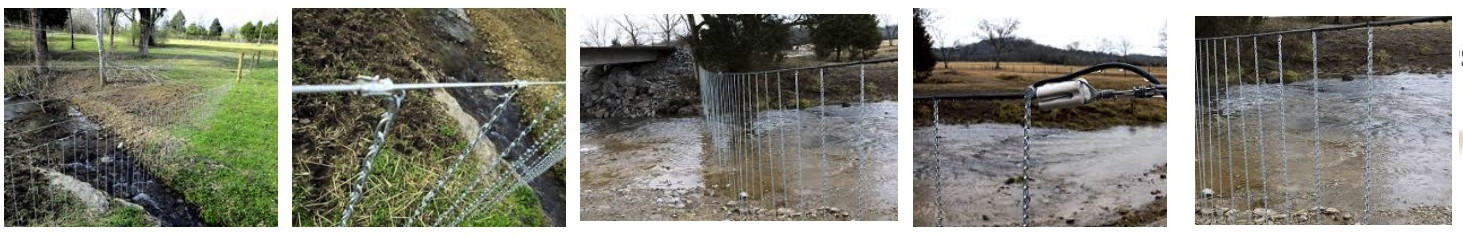

The creek got up and washed out the fence that has given problems for a long time. The gate is closed, no cows on this side of the pasture. I just took my time, cleaned out all the bushes, debris, old wire, bent posts, etc. and repaired it the best I knew how. Maybe it'll hold up until the next monsoon comes through.
Before
After

Why page wire? Seems like page wire would trap the most debris and lead to failure quicker when debris becomes a pseudo-dam and force of water behind it really starts pushing. it .
If it's cows you're keeping in, why not a few strands of barbed wire at the crossing? Maybe where each strand has a "weak link" connection that can fail separately if debris rises up to that level and it starts exerting pressure on it.
Good luck!
/ Fence repair
Those are cattle panels, suspended from a cable that runs across the creek. The three separate panels are loosely tied with wire to a couple of the t-posts creating the "weak link". The swollen creek runs from right to left, tearing the panels away from the posts with the debris flowing underneath the panels. The suspended panels and posts are left and all I have to do is wire the panels back to the posts.
As you can see from the top pic, " a few strands of barbed wire" had not done too well and I got tire of patching and rigging a barbed wire rat nest every time the creek got up. My solution might not be the best but it'll be easier to fix back.
Ah ha!! I see said the blind man.
Now that makes sense.
