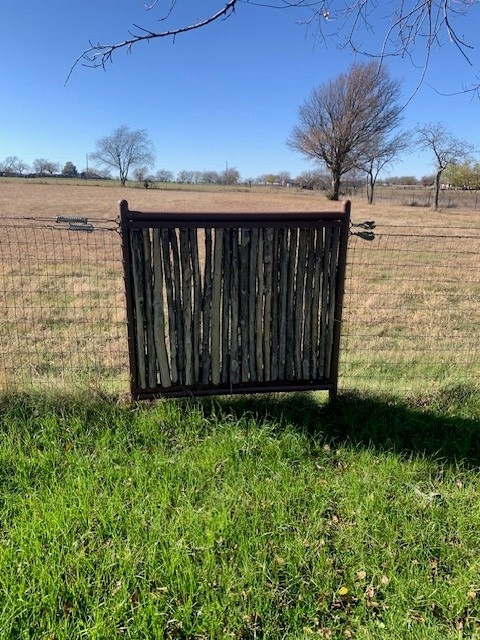

With exception of the one Diamond weave section, all mine has been the OK Brand 2 x 4 horse fence. I used the 100' rolls, because at every 100', I install an H to pull to. Because we have horses, I also pulled (2) smooth twisted wires at the top that have tensioners and a spring. It irks me when I see a fence top bent over from horses leaning on it. You could probably do without the tensioner and just use the spring. There's also a smooth wire at the bottom (that's what I use as my straight line for putting in tee-poles and posts.) As an example I ran a 600' wire along the ground, from corner post to corner post and pulled it tight. I then used that wire as my straight line to set my posts and H assemblies. The fence is hog ringed to the smooth wire at the top and bottom.
