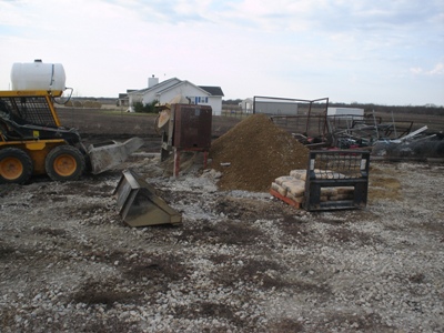

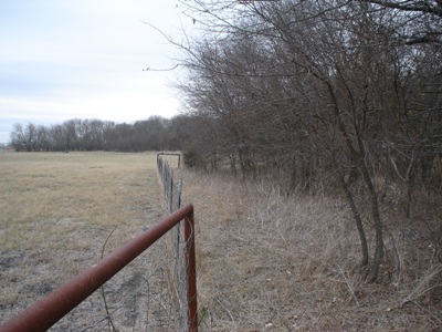

I'm doing a fence job in Josephine-Nevada-Farmersville Texas. Yeah, I get confused too. My customer has a Nevada address. Across the street they have Josephine addresses. And a block away they're in Farmersville. And it's all county. /forums/images/graemlins/grin.gif
Customer has ten acres that came fenced.

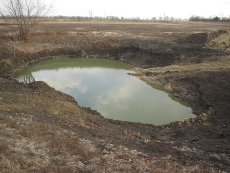

I need lots of dirt to build up a pad where we're going to put a four stall horse barn.
There was lots of dirt in the dried up pond (we're in a drought).

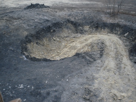

So we removed a lot of dirt from the bottom of the pond before I started anything else because you never know when it's going to rain and then rain some more. And once it starts raining there'll be no more digging in the pond for Iris.

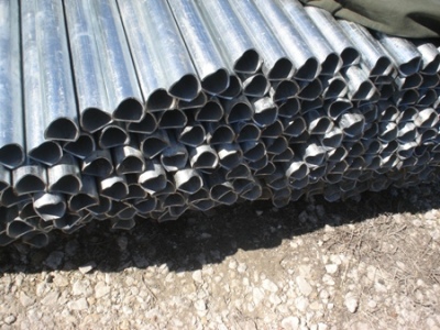

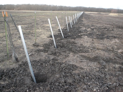

We're looking at thirty two hundred linear feet of five foot high V Mesh horse fence on a welded galvanized two inch (2 3/8 O.D.) pipe framework.
Gary is a helper-student-homeowner-client on this project. We agreed he'd have fun. He's paying for it on a couple of different levels. One of course is physically, he swears he's got an intimate relationship with every grain of sand and piece of stone going into the concrete for the posts.
One of his first chores while I was being the fenceman was to cope five hundred posts. We set up the pipe notcher and let him get after it. And get after it. And then he got after it somemore. In fact, he got after it until he got it.

The water tank on top of Iris was required because the clay soil is just about perfectly wrong right now. The big rain soaked down enough to make it clingy. It clings to everything. Mostly itself. And itself gets on everything which attracts more itself to cling to if you know what I mean.
So the old fence man waters his holes as he's augering them in. Not only does it make the holes easier to dig. It also gives him nice even straight up and down holes.
The even straight up and down holes is very important in this contractive-expansive clay soil. One of the biggest mistakes I see others making doing their post holes is they make them cone shaped, bigger at the top than at the bottom. This enables the soil when it expands and contracts to move those posts around like they're marshmellows in a cup of hot chocolate.

Keep in mind these are eight feet long posts. The holes are a minimum of three and a half feet deep and they're one foot across.

Fencemen don't use strings to set posts.
Fencemen do it by eye.
This line is eleven hundred feet long, about a hundred and thirty eight posts, seventeen cubic yards of concrete (thanks
Gary).
