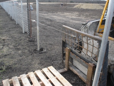

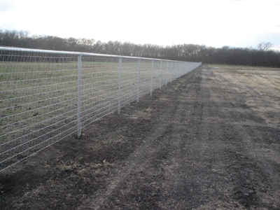

Yesterday we finished welding up the fence line about eleven. So we started stretching the V Mesh and tying it in.
   / Fenceman doing what fencemen do these days
#28
We laid out two rolls (165' per roll) and then stretched them. Then I stretch after every roll after that. I had the client and two friends helping with the tying. I put ten ties per section, five on the post and five on the top rail between the post.
I use the tractor to dispense the wire and also to stretch it. Even though I'm using the tractor I still like using the come a long because I can get a feel for how tight I'm pulling it.
We'll finish off the stretching and tying today and this section will be done. The neighbors will have access to their pastures once again.

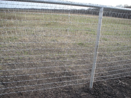

What I do is go in get the wire up good and tight. Then I come back with my little tricks and finish it out so it looks like a professional was at least in the county when the fence was put in.
This is a splice before I had time to come back and dress it up.

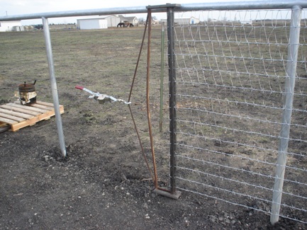

This is my stretching tool that I made when I got tired of the old two boards and bolts system. It's a friction device that works like a hose full of lead in a beating. /forums/images/graemlins/grin.gif
