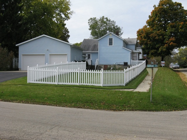

My only experience was with the vinyl picket fence products. I put up a 4 foot high by 200 feet long picket fence around my yard at my old house 9 years ago. Fence still looks good today. I live there for 5 years and never replaced ay components. Talked to the current owner this winter and he has not replaced any components yet either.

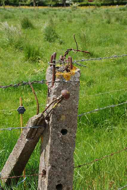

And no, this is not my concrete fence post. But it does look like it has been there a long time. It looks like they ran the rebar too close to the ends where it rusted and the concrete spalled off.
