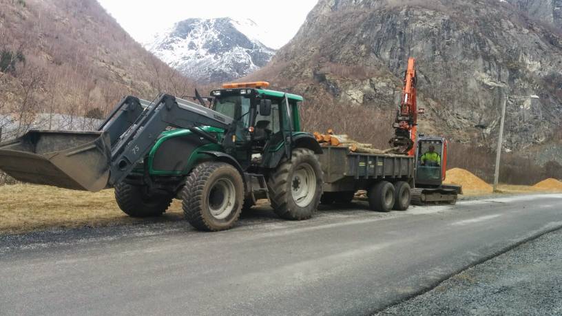

Do the tractors have very much upgraded brakes vs North America tractors? Do they use road tires? Do they have the hp to maintain that speed? Over here you can buy a day cab semi for pretty cheap.
   / Fencing on my rock farm ;)
#35
Depends on top speed, 30km/h no particular demands, 40km/h four wheel brakes, can engage 4WD automatically for front brakes, 50km/h+ must have separat front brakes, dual circuit brakesystem and front suspension with a spring function, and all rims must be welded together so no adjustments on with. Probably more minor demands I don't know so much about.
Airbrakes are very common om trailers designed for high speed, all tractor trailers from 6t must have brakes, most common on 40km/h and slower are hydraulic brakes, operated with a special brake valve on the tractor.
