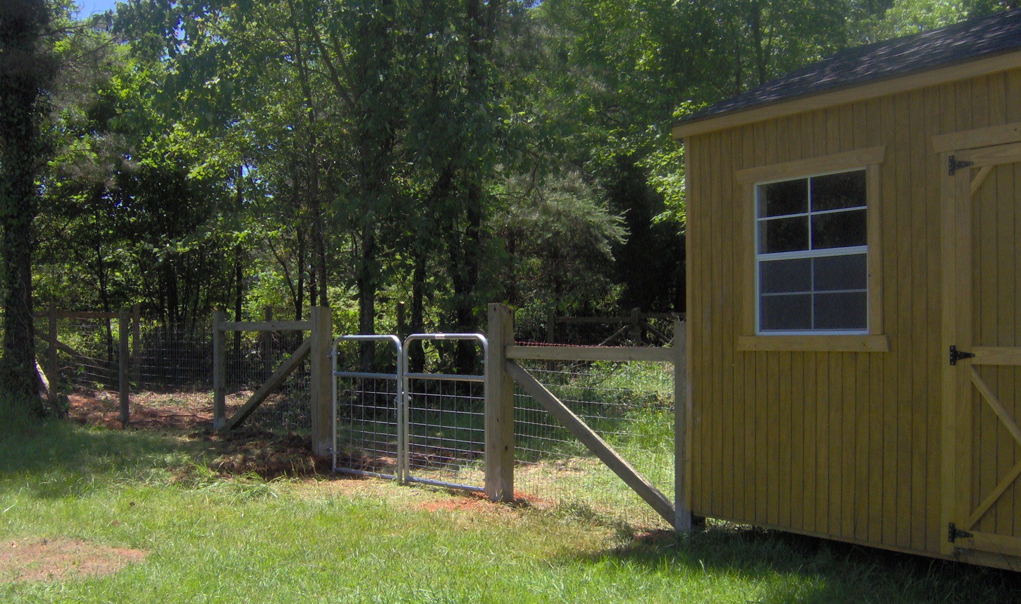

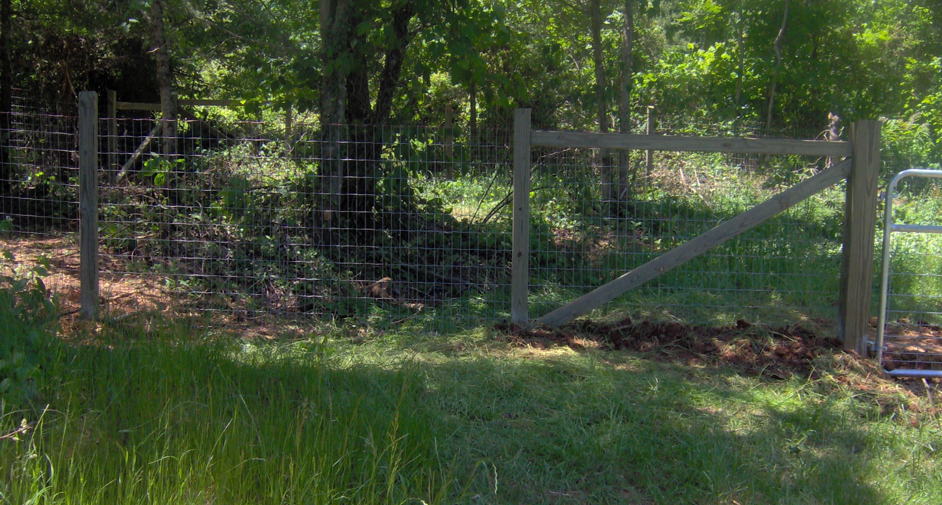

I really like the Red Brand woven 2"x4" wire. Here's a little goat lot I built for a lady:

This fence is to match what we have along the horse side. There is a top and bottom 2x6 rail, to keep horses from leaning down on the top, and from digging under/kicking out the bottom (also keeps the dogs, pigs, goats, etc from trying to wiggle under the fence.
There are currently 3 areas that have this setup existing. One has a 4x4 top rail so it is flush with the posts, and the fence is attached to posts and those rails. One has the same setup, with a 2x6 covering up that attachment, so you don't see the top staples (it appears the fence is floating behind or attached to the back side of this top rail). And another has the rails attached to the face of the posts, so the top and bottom are 1.5" further out than the posts.
I'm going to put it up on the posts, then cover with 2x6 kinda like the 2nd one mentioned above, without the extra wood. So wire will be sandwitched between post and rails.
Advantage I see to what is up, is the fence doesn't have to be pulled as tight, so there is less stress on the posts.
