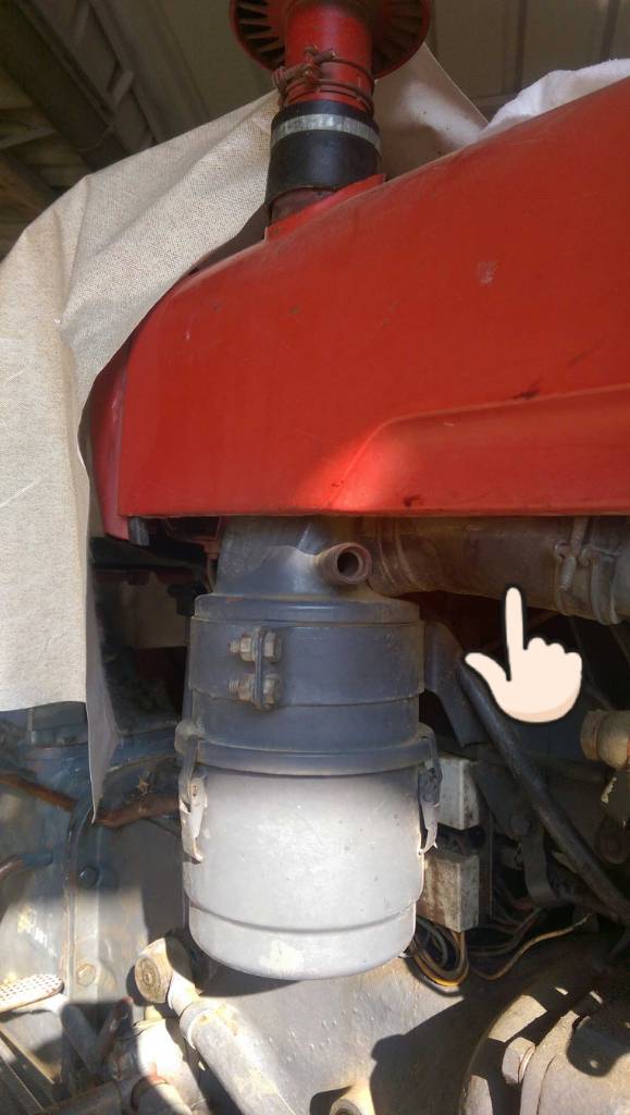

Ok, I got a new set of pictures.
Can you tell anything about those pics? Air intake hose?

Intake mushroom, top part: http://shrani.si/f/3p/e0/3AwULLqV/intake-0.jpg
Afaik air filter is housed here: http://shrani.si/f/14/OT/2CBhrJm3/intake-1.jpg

@dlttrekkers, but, hm, there's no dust in the air? I mean, when we work in the fields air can be dusty, but most of the time it sucks clean air. How many % are you convinced that the problem is in that hose?

The video is still not viewable on my computer.. Can u snap a couple of pic of the inj. pump?
Can u raise the hood & snap a couple of pics of the air intake, where it goes from plastic/rubber to metal..??

If its a CAV pump/system.. some of them had a cold start devise the was screwed into the air intake pipe.. Called a thermostart..
The thermostart was fed fuel from the injection pump & was electrically controlled by the key switch..
They use to burn up all the time & the fuel would still drip into the intake pipe.. causing massive amounts of smoke..
That's why I want the pictures of the intake piping & inj. pump..

My thoughts exactly here to. I reckon the heater plug is leaking internally into the air and on into the head.
OP when you start it at first is it very smokey?
Worth taking out the heater plug and out a bolt or something in the threads and start it let it run for a while so any diesel in the head will burn up. Then try it again when the engine cools/next day with the plug still.out
