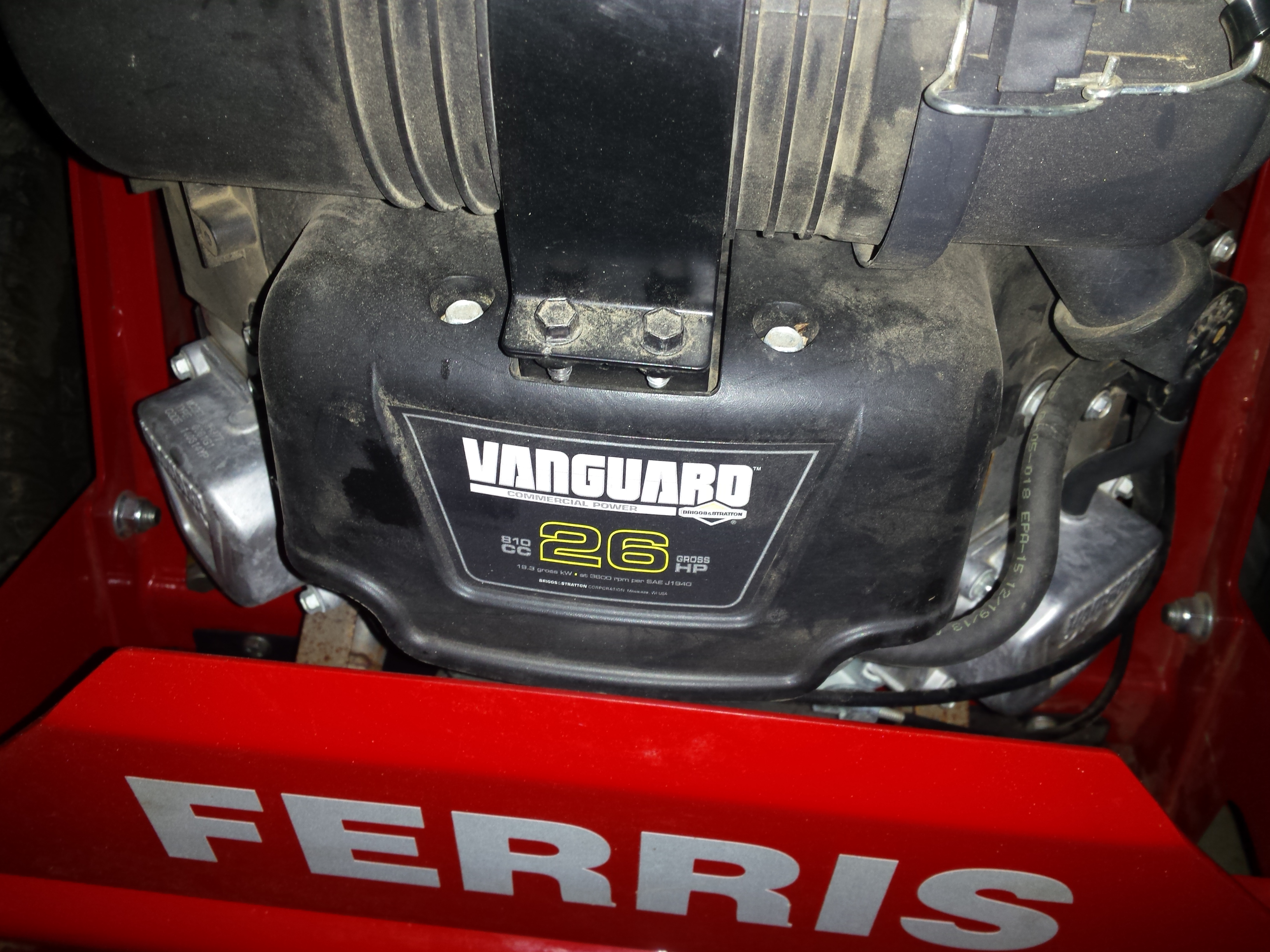

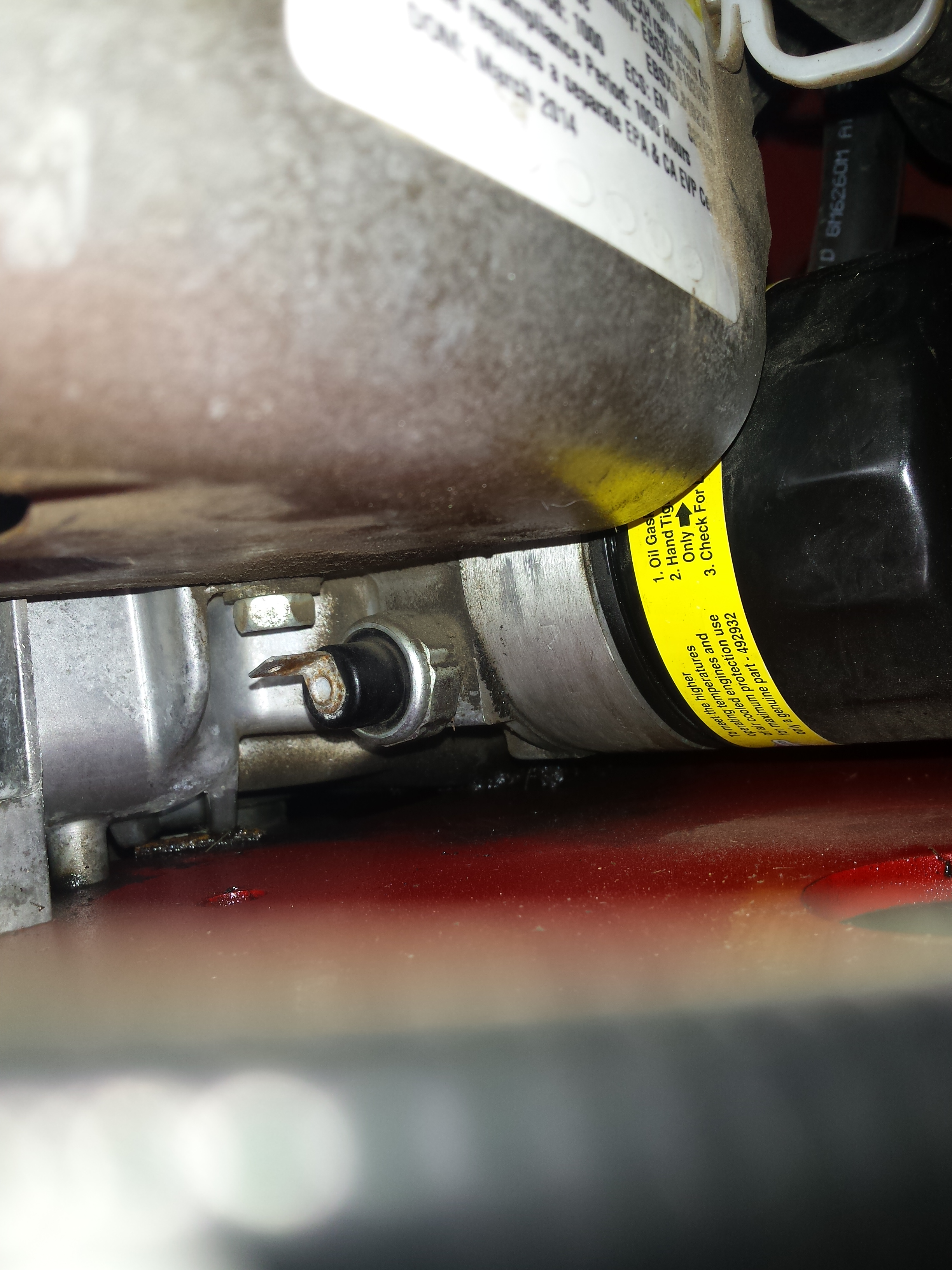

Eric,
I changed the oil in my is2100z yesterday for the first time (I bought it used last week) and notice that a oil sending unit was not plugged in.
I could not find any lose wires. I have the Briggs & Stratton Vanguard 26 HP Eng. I was just wondering if your Ferris is the same
