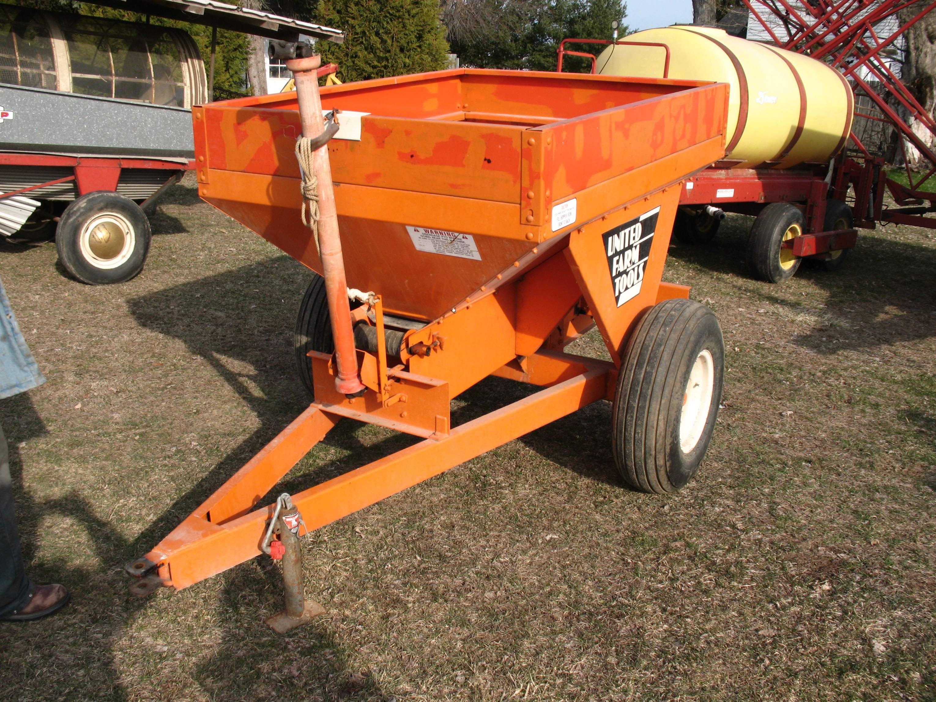

For Lime, I'm 40 miles from a quarry, and one load on my 1 ton dump is enough to cover my hay field. This application is normally good for 4-5 years. I bought a small fertilizer/lime spreader exactly like pictured below, about 20 years ago, for $250. I just use it to spread lime. Holds right at 1500 lbs. I pull it with one of the Farmall Super C's, it's just right for them. I dump it on the ground, and load the spreader with my little Bobcat. 2 years ago, I hand spread 4 tons of lime. The little spreaders hopper was just too bad of shape, to work. After slinging 4 tons of lime by hand, I decided it was worth rebuilding that winter. It's all rebuilt, and ready for the next time I need lime spread. Well worth the $250.00 worth of sheet steel, bearings, gear box, & paddle wheel to fix it back up. Soil tests just done, show I'm good for this year. Small spreaders like this are used on golf courses, so they should be relatively easy to find, if you know where to look. I saw one in about as poor of condition mine was before rebuilding sell at a farm auction about 18 months ago, for right at $400.00. If a person can do the work themselves, that's still a cheap spreader, in my book.
