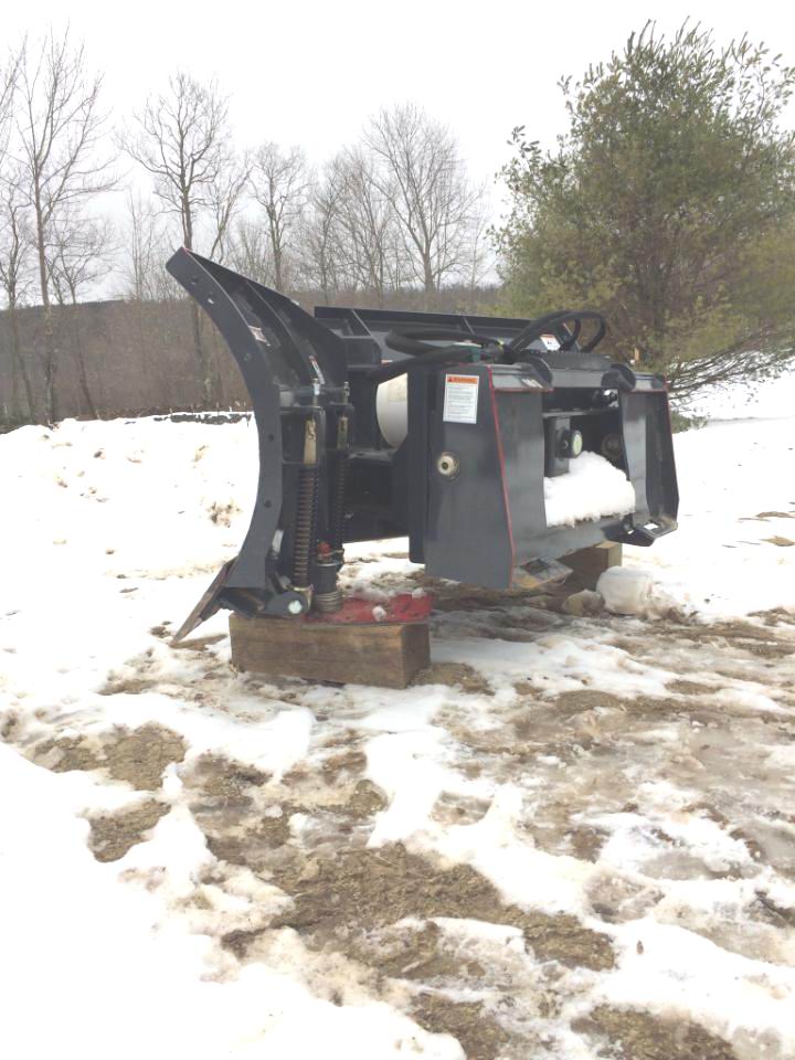

Just stumbled on this post...again. It's been a few years, so here's an update... still got the Virnig plow, still VERY happy. The first year I did make big ole Skids to help it on my stone driveway. See the Red feet in the PIC
I like that it stands on it's own when not in use. Unlike straight plows, I set the plow in a 'V' and drop it down on blocks, for added height. It balances nicely this way and the Quick Attach end stays up out of the mud.

yeah, big$$$ for something kinda simple. When I made my larger ones, I I just welded the vertical Rod to the top of the Foot. It wasn't the best way to go as it sheared off and I lost the new foot. Fortunately, a few weeks later we had enough melt that the Foot and all the washers were sitting there on the side of the driveway. Drilling into the Foot so the vertical Rod (1 1/8 diameter) drops down into the foot then welding both sides did the trick.
