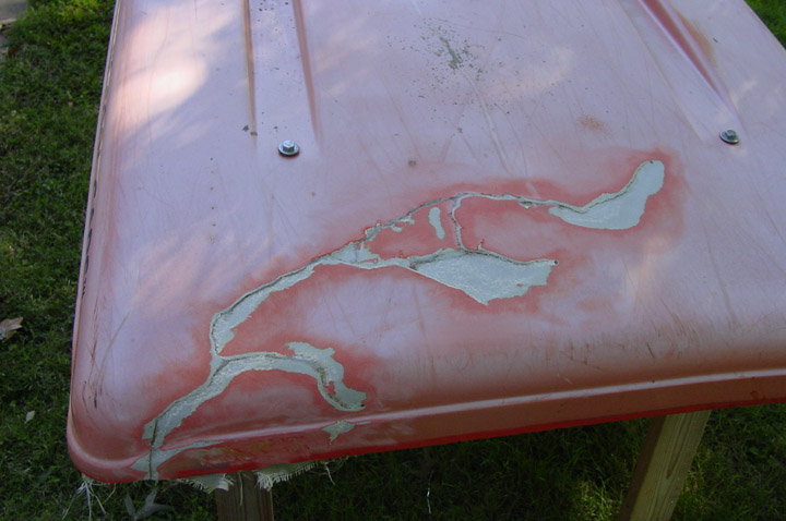

Before you go much further, take the time to drill out the ends of those cracks... may never come up, but cracks have a tendency to spread.

From the Picture:
Sand or grind down to pure fiberglass on both sides.
Fill in with mat. Cover with a layer of cloth. Lay on a layer of bondo. Sand flat and smooth and paint.
Repairing the damage structurally will not be difficult. Getting everything to blend in and look good is the hard part.

Here is the canopy prepped for the first layer of mat and resin, and with the first layer of mat and resin. (I already patched the underside.)
This is my first time to work with the mat. It's very different from the fiberglass cloth.

Looks good so far. That wasn't so hard now was it <g>.
