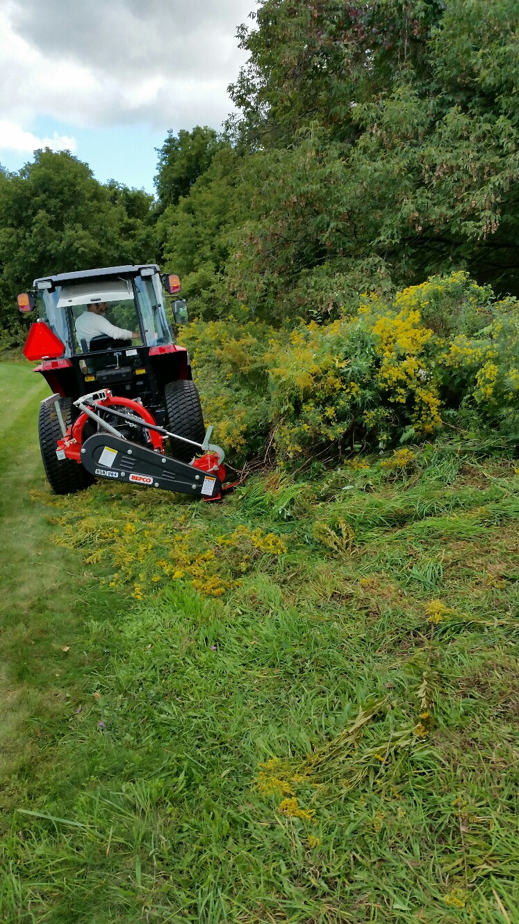

Here are some pics of the berm from a couple of years ago. This is my old MF 1643 with a BEFCO sickle bar mower.

Thanks. Mine is a little steeper, but not much.
How long is the sickle and how much can you adjust the angle?

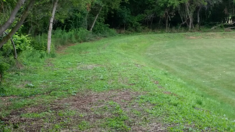

Here are some pics of small parts of the berm last year after some cleanup. I don't have any pics handy, but there are sections of the slope that are steeper. The DR would want to roll over in those areas. We've actually found a lot of uses for the sickle bar. With our current MF 1754, barely feel the sickle bar on the back. Cutting is really easy! On the berm, I take a pass from the bottom and then one from the top and I'm done. Since, I already have the sickle bar on the tractor, I finish the flat sections with it. Have found the sickle bar pretty handy for trimming close to the hedgerow in our back field and trails as long as you know what it in the hedgerow where you are cutting.
I have a 7 foot bar on it. According to the manual, it will mow 90 degrees up and 55 degrees down. I haven't had any issues mowing our ditches which are a pretty steep drop-off.

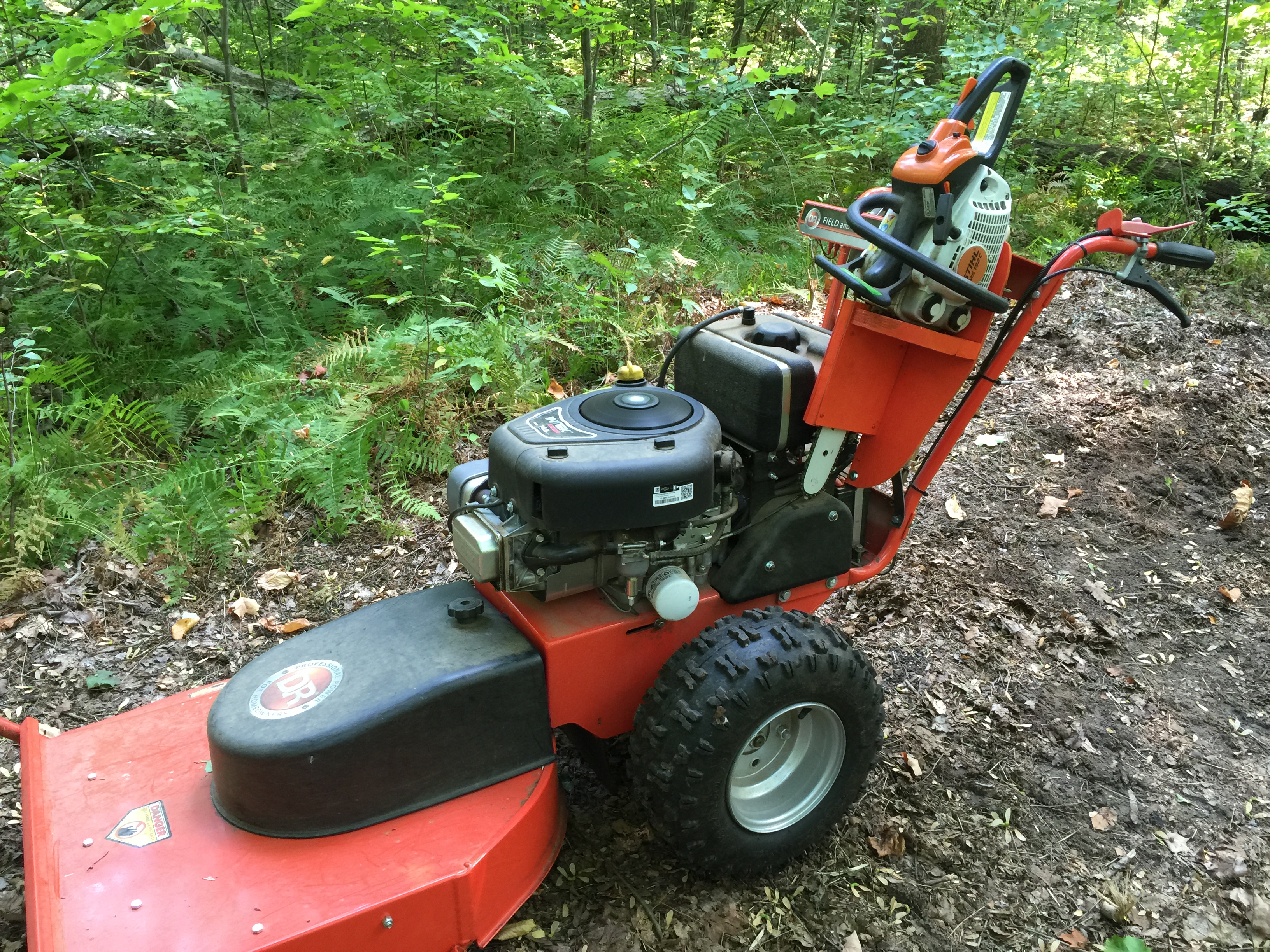

I bought a DR Field & Brush mower about 3 years ago and should have have bought one years earlier. It is definitely one of my most-useful pieces of equipment. The machine is a beast and is useful for mowing just about anywhere you can walk. I wish i had a picture of the steepest hill I mow with it- maybe I can get one later today. i bought the machine specifically to mow areas that I felt were too steep to mow with my tractor and to build and maintain walking trails through our woods that would be narrower and through rougher terrain than I was comfortable on the tractor. My model is the 14.5 hp (I think) which I bought specifically because the engine has pressurized lubrication which DR recommended for steeper mowing. I got electric start because my old shoulders complain about certain motions. I used the mower about a week ago for the first time since last November and it started right up at about 30 degrees- so the no-maintenance battery is not a concern for me.
My machine predates the latest brake-steered models, and it can give you a workout, but it's satisfying work. Before purchasing, I looked a Billy Goat, but now I can't recall why I chose the DR over the BG.
As for service, the owner's manual is very descriptive to allow the owner to do all routine maintenance. If you are not comfortable with that, the machine is so basic that any competent lawn equipment shop can easily handle it.
Finally, just because everyone likes photos, here's a picture of mine showing the chain saw carrier I added for trail building and maintenance activities.
