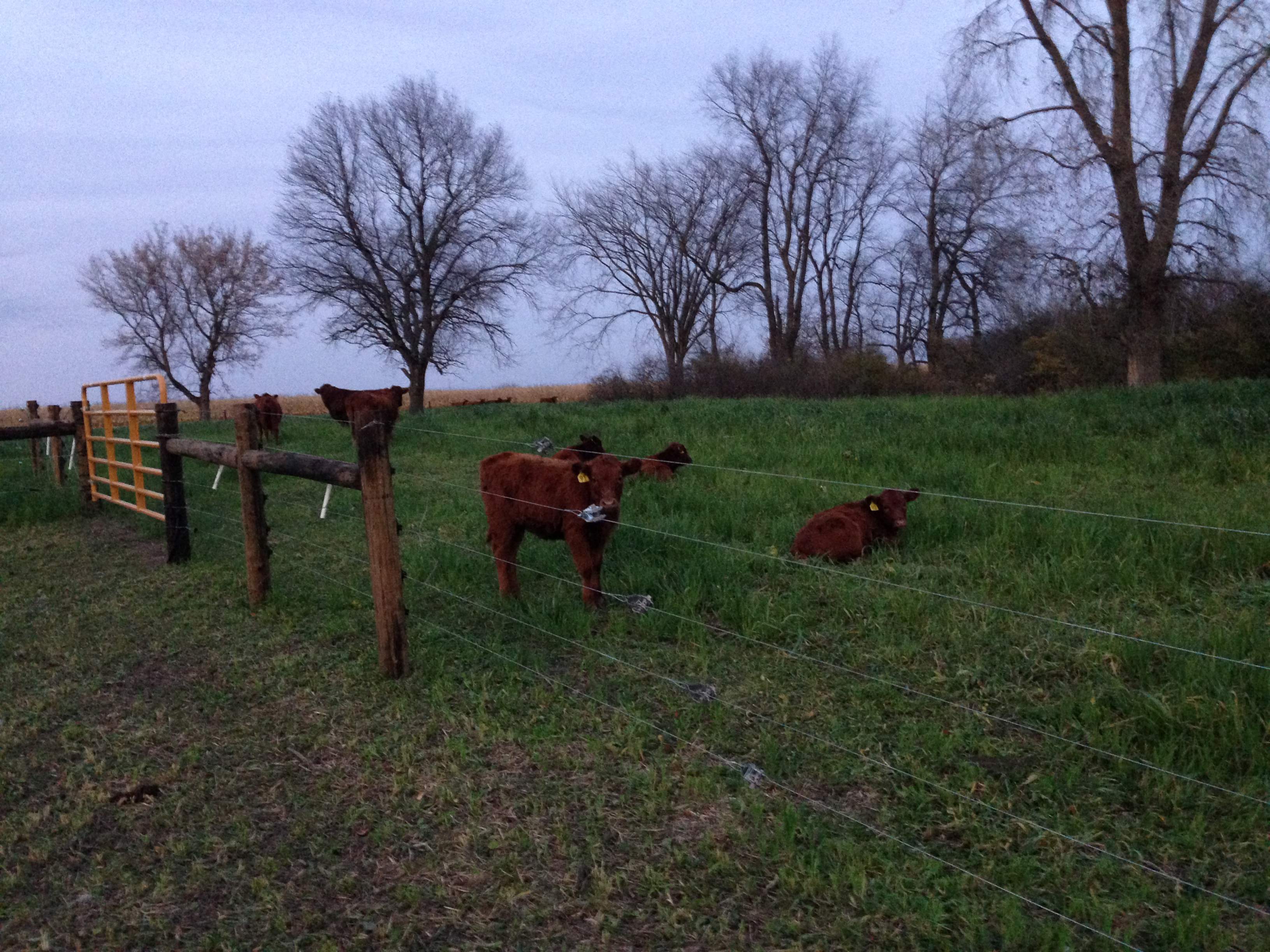

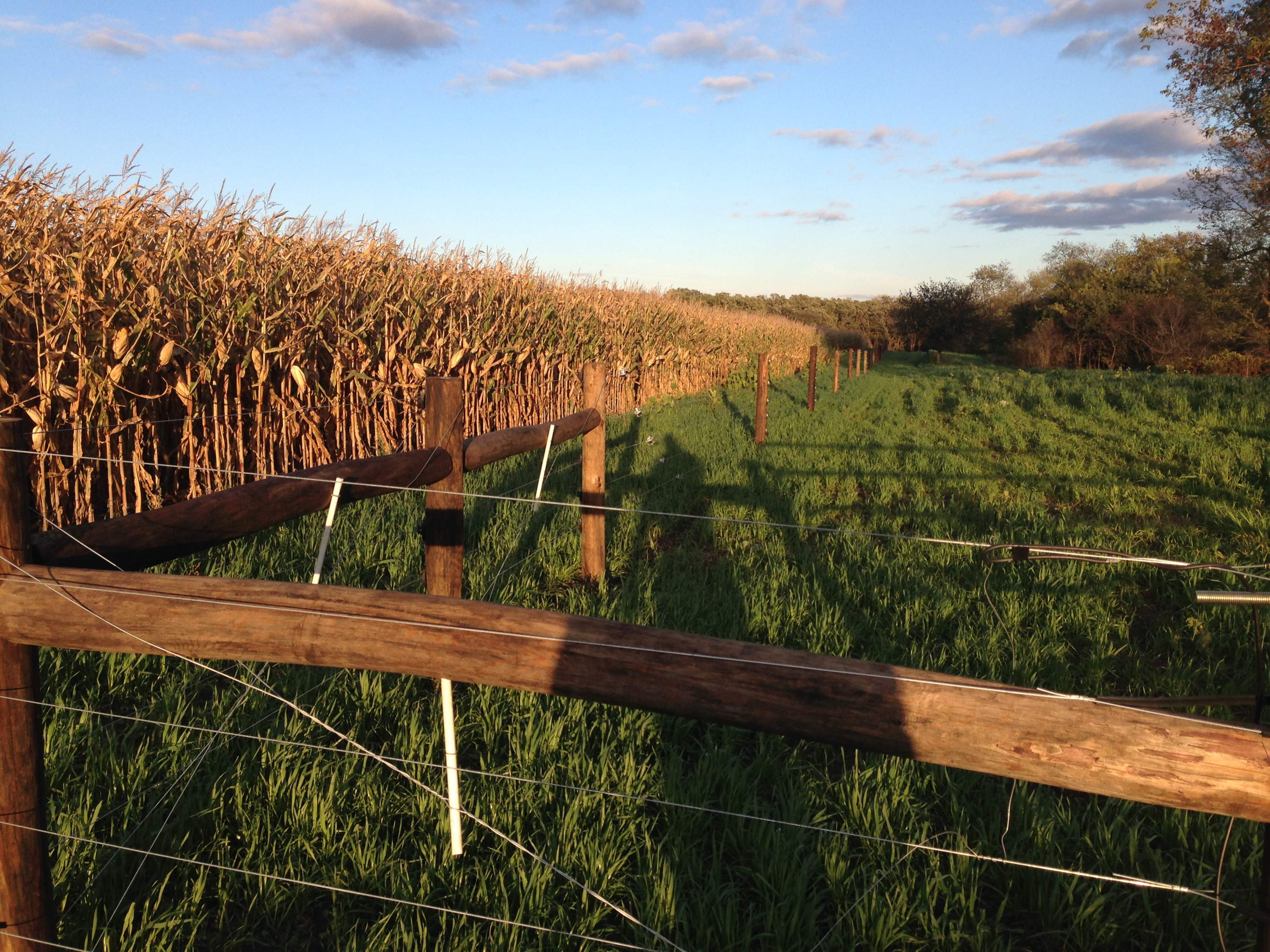

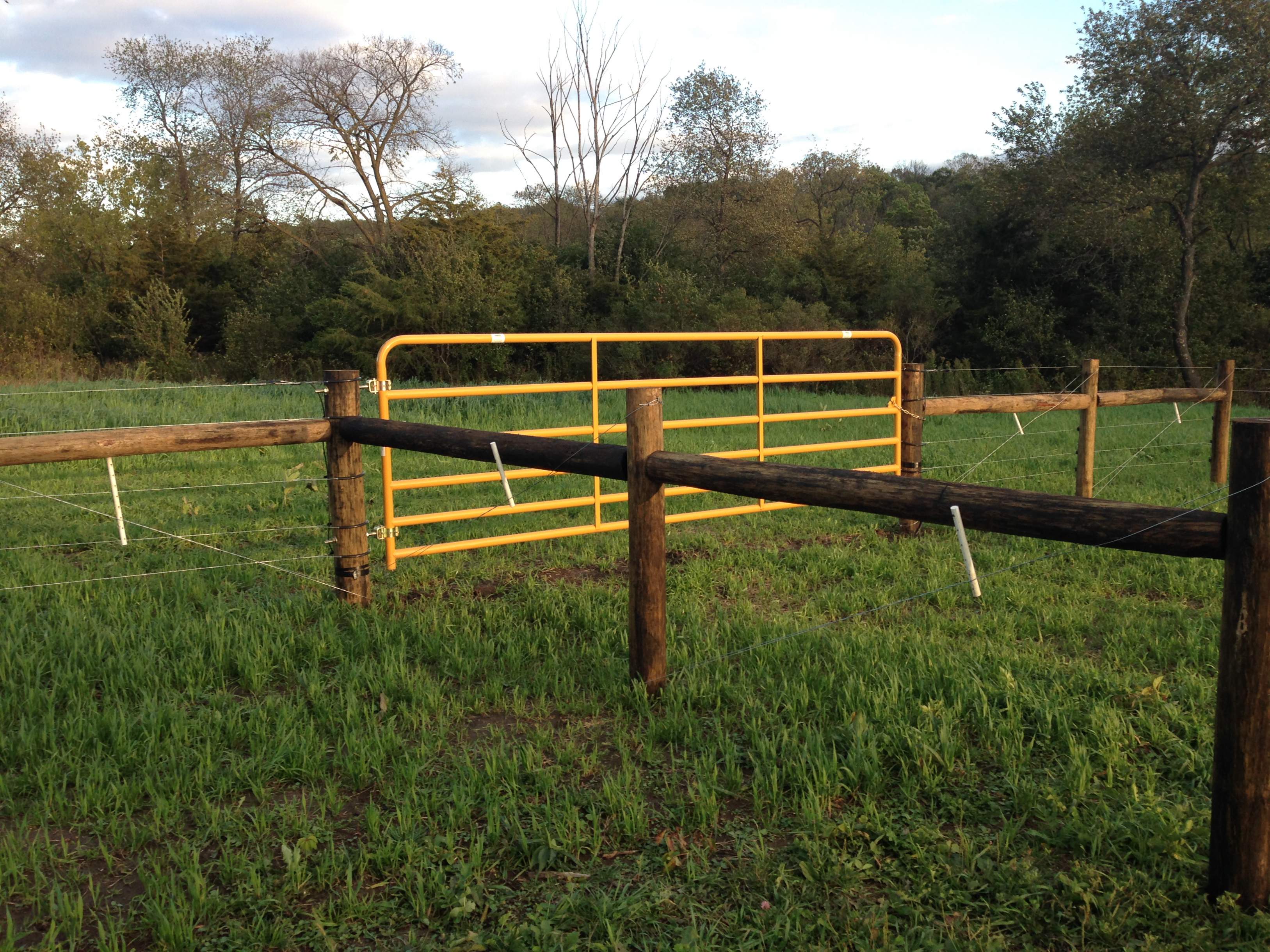

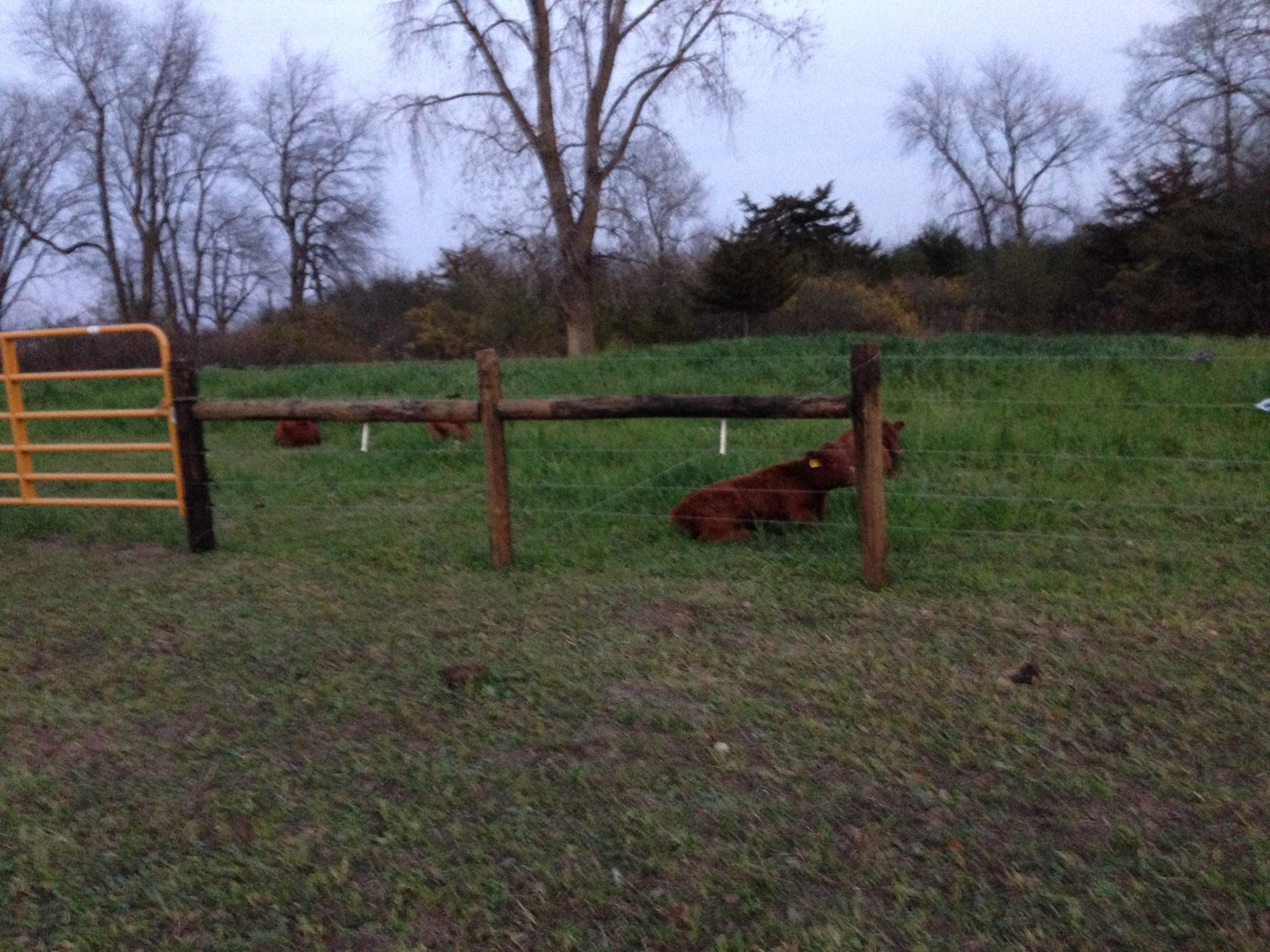

This is what I've been putting in lately. The old barb and woven wire was 40+ years old, so I guess you can say it did it's job, but boy I was glad to get it ripped out.
My new fence is 5 strands of electrified high tensile with 5 inch creosote line posts, and 6 inch posts in the double corners. They don't mess with it.

Beautiful country and nice looking fence. ^^^^^^^^^^^
Depending on the charger, you many have to deal with the grass along the fenceline.
