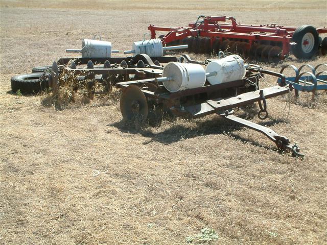

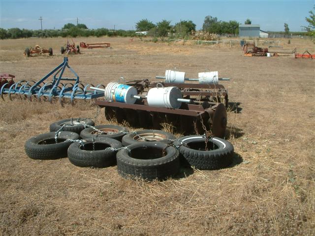

After plowing, run a disc over the field several times. Tow some kind of heavy drag behind the disc to break up the clods and smooth.
That old Towner disc was a gift from a neighbor. The tires were freebies from another neighbor who was cleaning up his sheds. I added about 400 lb of concrete weight to get the disc to work better.
