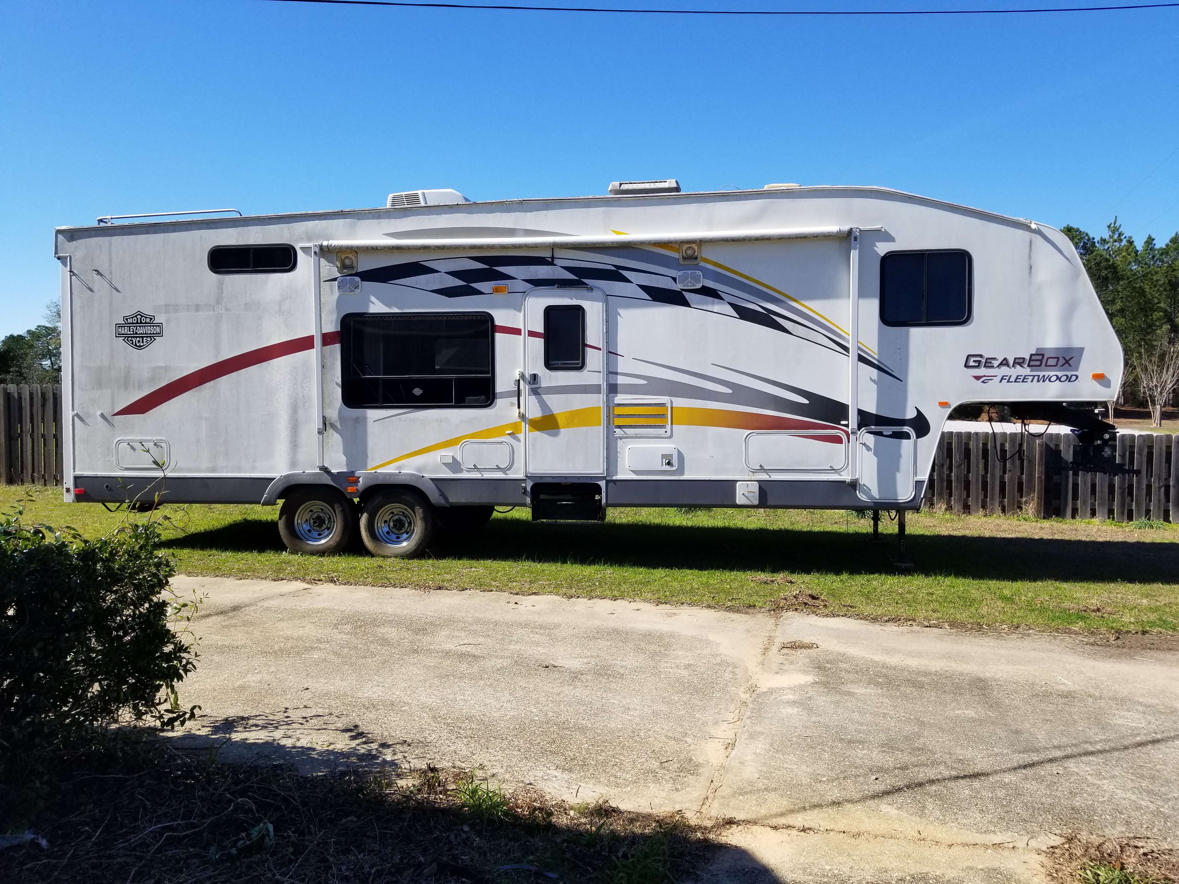

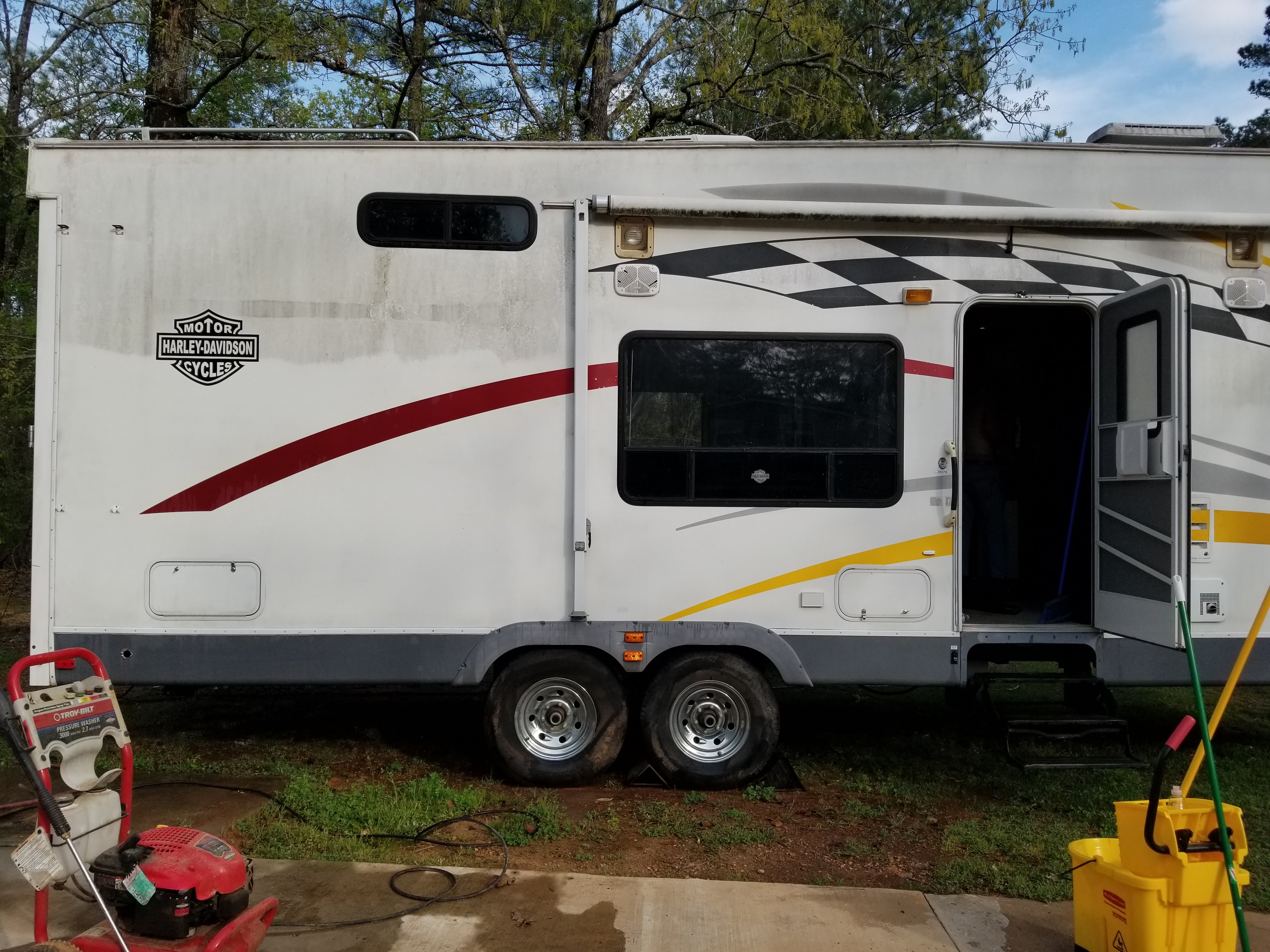

I recently acquired a 2006 Fleetwood Gearbox Toy-hauler, I'm not going to restore it to new but I am going to do some repairs. Some of the known problems are Electric landing gear not working, transfer switch not transferring, it's got a weak spot in the floor of the garage area and the generator has not run in years. so between a 12 hour shift job a honey do list longer than my arm looks like I'll be busy.

Sounds like it's going to be a time consuming job, but not a particularly tough one. The hardest jobs on an RV are roof and frame jobs where structural components are rotted. A few years ago I got what I thought was a smoking deal on a fifth wheel that had water damage in the rear end, it took several weeks of intensive effort to repair it right.
Looking at the picture - I don't know if it's just light reflection or what, but it looks like it's got some delamination issues.
   / Fifth wheel camper repair
Good eye Gunny you are correct, just more things to look at.

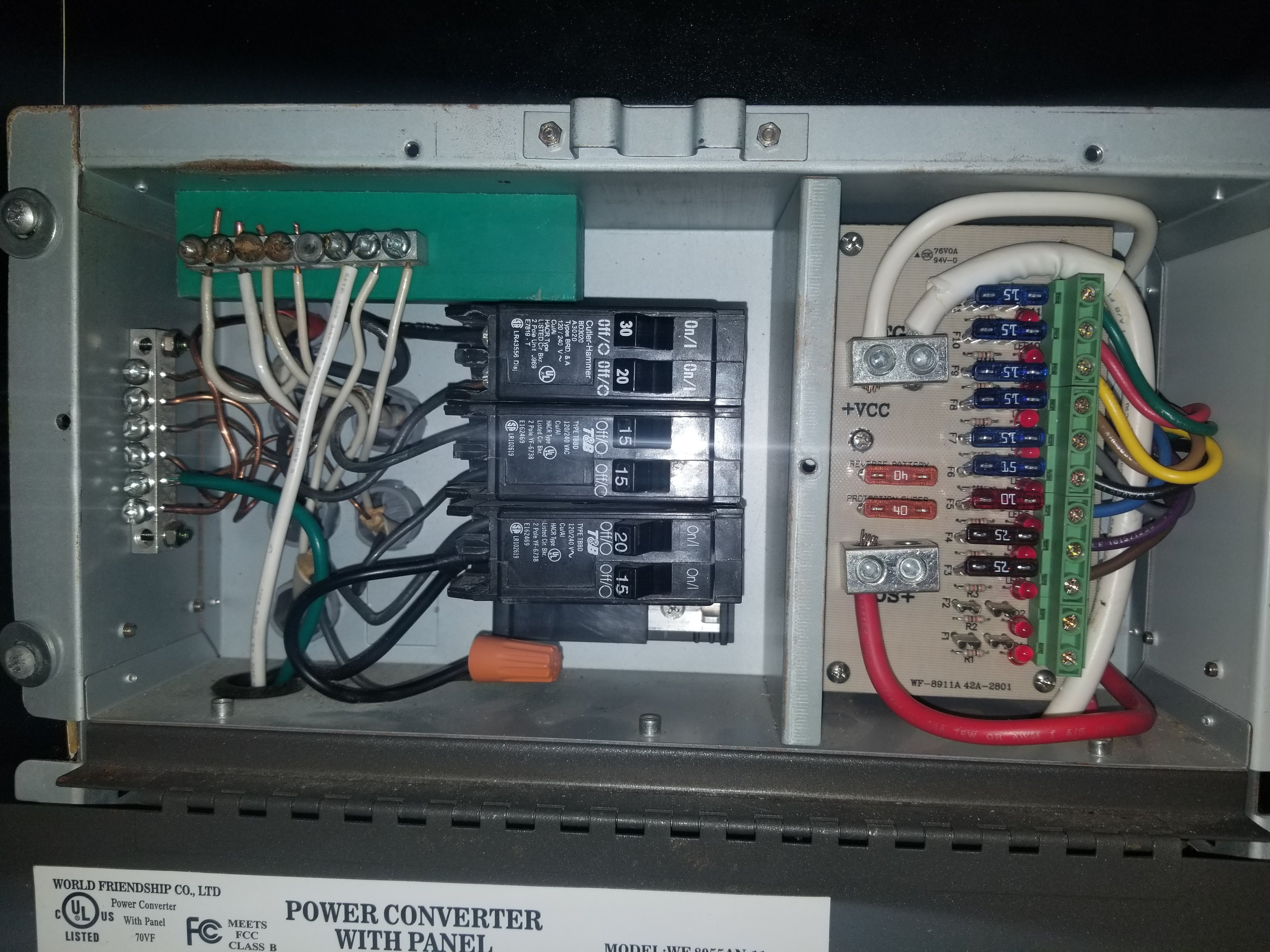

took the time to remove the transfer switch so I could order the correct one, got the new one delivered but have not installed yet.

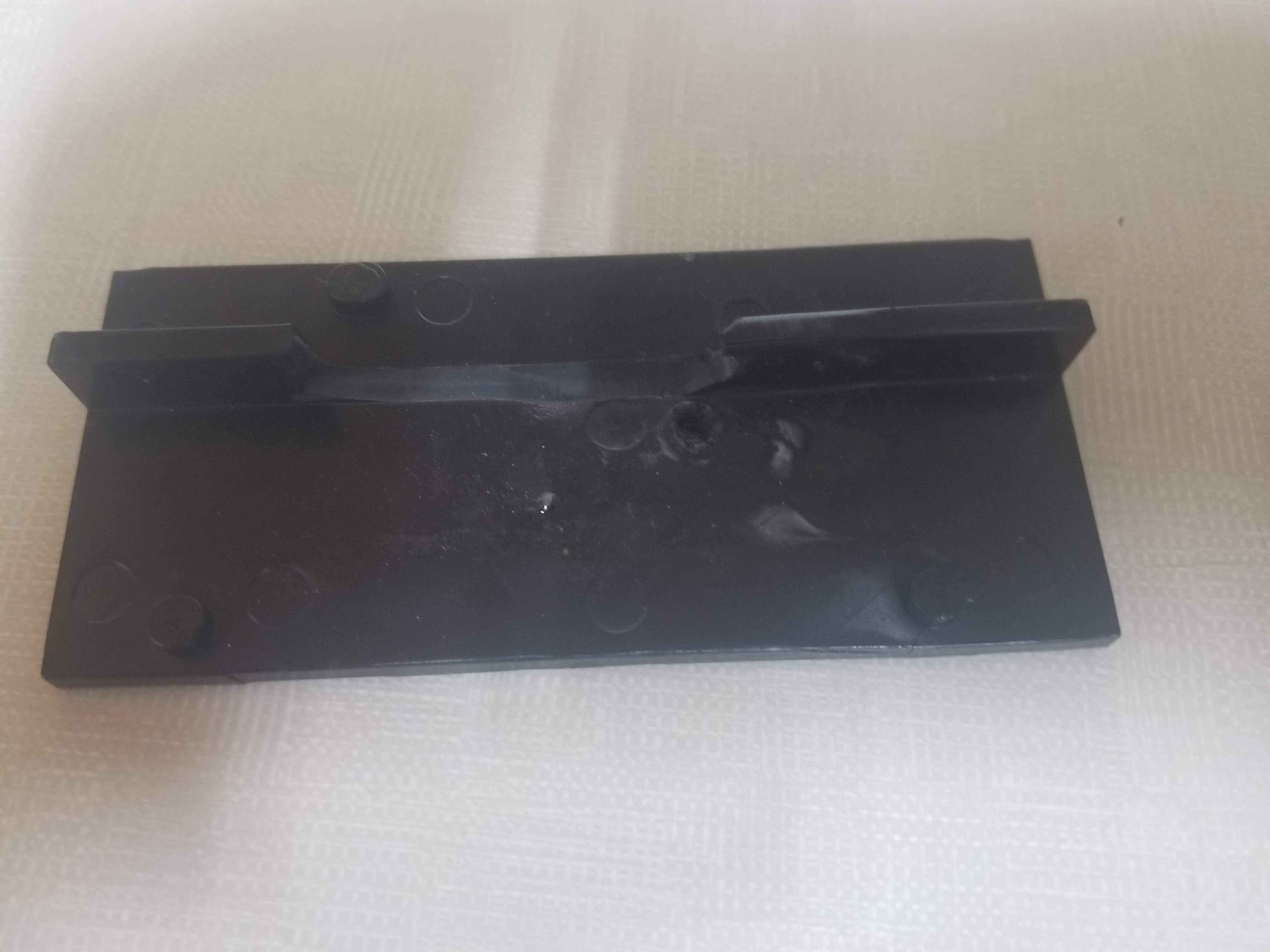

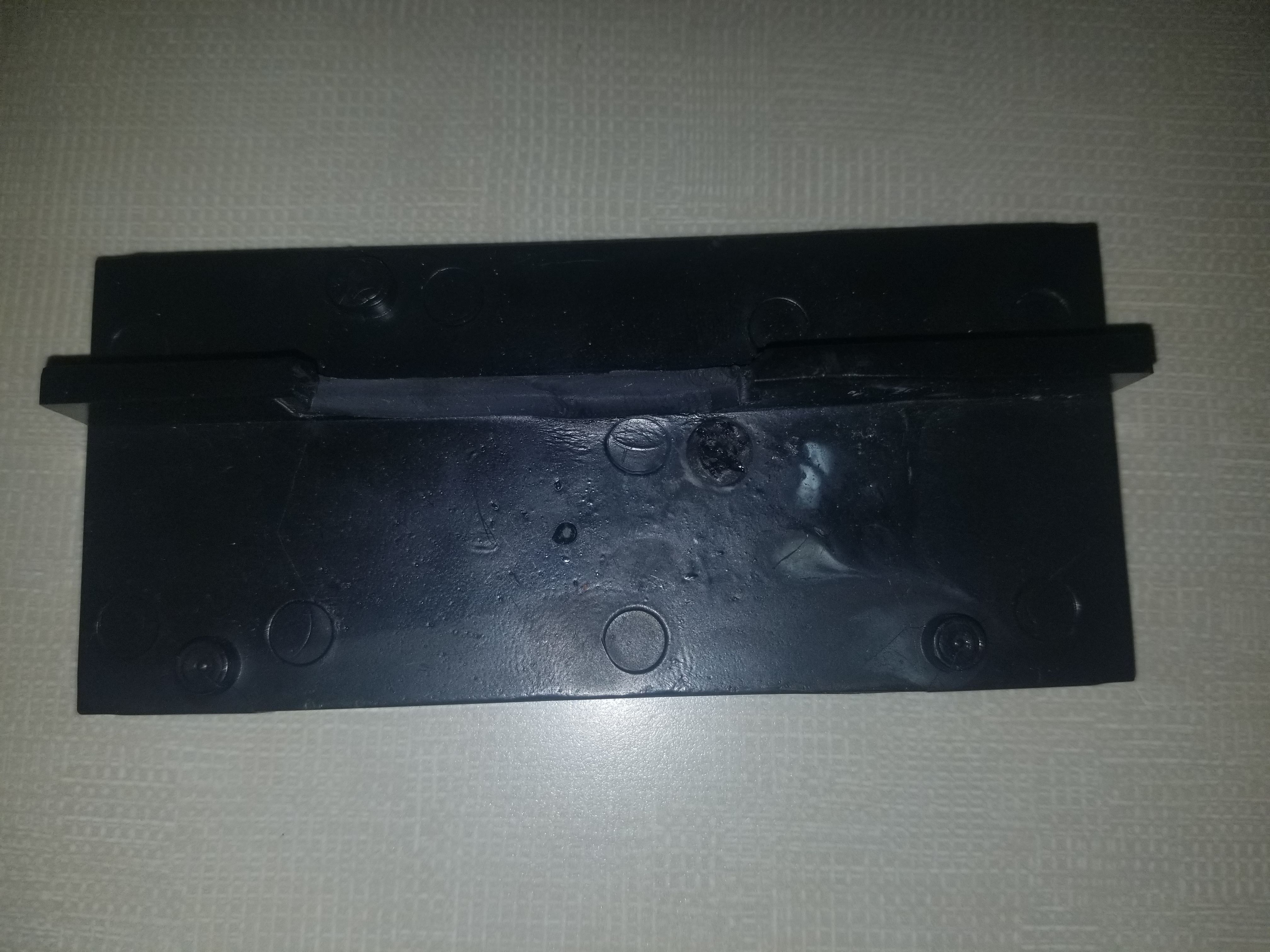

I got the transfer switch in and it is working like it should on shore power, have not tried the generator. while I was in the breaker box I found a loose ground and a neutral wire. the neutral block had gotten so hot at some time in the past that it had the plastic insulator broken and brittle. so I fabricated a new one hopefully by tightening everything in the box I got rid of the heat.
