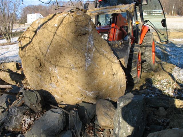

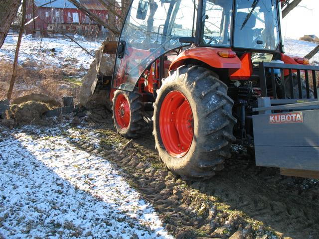

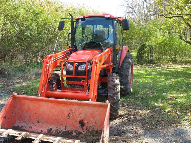

For loader work it is important to have enough weight in the back as well as behind the rear wheels to offset weigth and wear on the front wheels. To be able to use the bucket to fill up from solid ground you need traction that only weights can provide. I started with disk wheels in the rear and went to CI hubs with filled tires and then mounted a 2000 lbs ballast box on the three point and now I am going to add additional CI wheel weights. Also I have set the wheel out to gain additional stability
