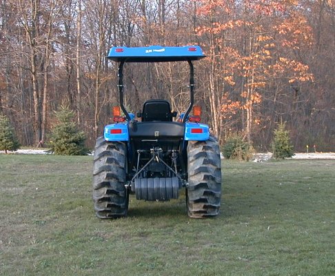

If you are worried about a BH ground clearance or width problems on a box-blade here's another option for adding rear weight that can be taken off quickly.

I would recommend a <font color="orange"> Kubota </font>B8160 Ballast Box filled with concrete. It will be all the counterweight needed with a 402 FEL.
Here is a link to a picture of it. Click Here
This link will lead you to some discussion on weight boxes. Click Here.
A weight box allows the maneuverability that a BH will not allow.

What a great idea, and should be inexpensive to do as well! Thanks!
