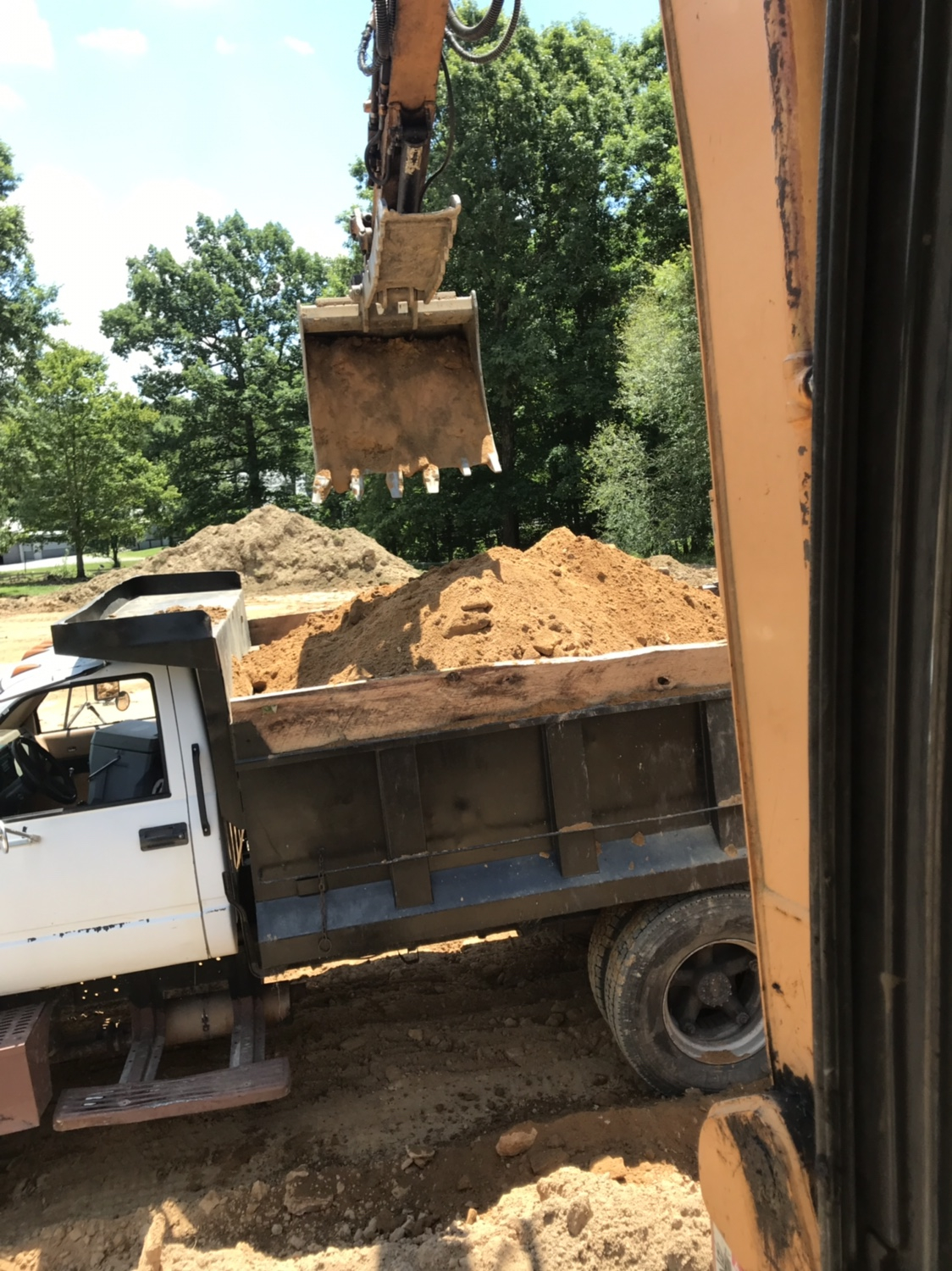

   / Filling a Hundred Holes (6-feet across, 4-feet deep) #29
You can move dirt a lot faster with less wear and tear when you put the dirt into a dump truck and move it.
I watched my farm neighbor start to move a lot of dirt after regrading the fields. I'm laughing at them using an excavator to pile dirt and have the back hoe move it one bucket at a time. I stopped them and asked them how long it was going to take? The reply was forever. Told them to get a truck, even a 6 wheel 1 ton moves dirt a lot faster than what they were doing and for a lot less money.
Dump the dirt straight in the dump with the excavator and don’t pile it first.
