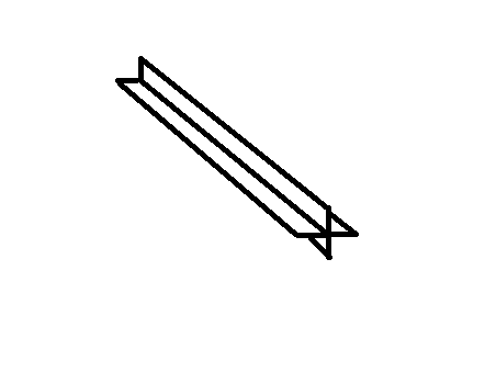

Would adding something in the middle of the pipe like this contribute to it's strength? Welded flat bar?
Some....But not as much as increasing the wall thickness of the tube by the same amount.

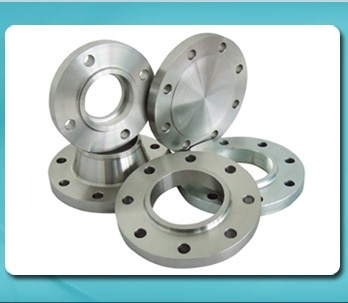

I would just go with 4" pipe in a heavy wall thickness like schedule 80 or even 120. That should not flex on a 50" length. Maybe also put in s support ring in the middle of the shaft also even though you cant weld it, it will keep the "axle" from flexing in the middle and therefore make it much more rigid.
The schedule 80 should not bend in your application. Instead of the shaft through the pipe consider weldalets on each end that transition to your hub sise. Or you could weld series 600 RF flanges on each end and choose a companion flange with the right diameter for your hub. Ring flanges would also work.:thumbsup:
The problem with this approach is you can't weld it in place internally to get the maximum benefit.
I agree that a sch 80 weight pipe is the best approach.

This is similar to what I posted about putting a rod thru the middle WITH A DONUT TIGHTLY FIT TO THE PIPE AND PLACE MID LENGTH in the pipe. When a solid rod is placed in the center of the larger pipe with one or more support donuts welded down the length, they only need to be welded securely on the ends. The center donut need not be welded as it is just a fulcrum on which the center rod rests and both ends are welded with thick plate so they wont cup inward from the bending force. Before the outside pipe can bend, it has to stretch the center rod.
Sizing the center rod would need to take into consideration the amount of force that one would be putting on the roller. The rod has to be strong enough that the forces don't exceed the yield strength of the center rod. By doing this, it makes the pipe & center rod act like a truss. The pipe cant bend without stretching the center rod AND stretching the topside of the pipe while compressing the bottom. This makes it extremely strong to resist bending.
If you just put a center rod thru it without the supporting donut, you wont have increased the strength very much at all.

actually one can weld a web like that in place, if one drills some holes that match up with the web, and plug weld it, I did that on another project, using a thin wall 6 inch pipe,

......By doing this, it makes the pipe & center rod act like a truss. The pipe cant bend without stretching the center rod AND stretching the topside of the pipe while compressing the bottom. This makes it extremely strong to resist bending.
I think the compression and tention forces on the near and far sides of the outer pipe walls are balanced, and any rod in the center of the pipe will see little forces, and so add little strength. You would be better off if you increased the wall of the pipe by the same amount of metal as you would use in a center rod.
Look up the term "neutral axis".
