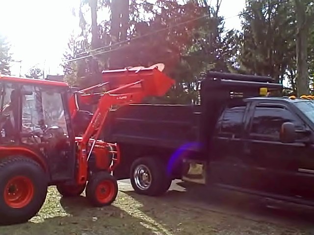

I've also got a B3030 and I used Rimguard to load the tires. I've been happy with the results; I can carry 600+ lbs in the bucket with no need for rear ballast. However, if I were to do it again, I would have the rear tires foam-filled. With foam-filled tires you can run over nails and never worry about maintaining air pressure. With tires filled with Rimguard, you still have to check air pressure and use a special air gage. Regular gages get messed up from the juice of the Rimguard. Plus when checking the pressure on a Rimguard tire, I rotate the wheel so the tire valve is up. This prevents leakage of Rimguard. In short, in my opinion, liquid-filled tires are one big hassle. I can't wait for the day when I get the rears foam-filled.

I put Rimguard in the B2410 and in the L5240, 50% fill both times. Improved stability and loader capacity in both tractors. Both tractors use R4s so I never had a puncture problem. AStanton is right, liquid filled tires require a special gauge (mine was <$10) and checking with tire valve above liquid level. IMHO liquid filled tires aren't a hassle.
