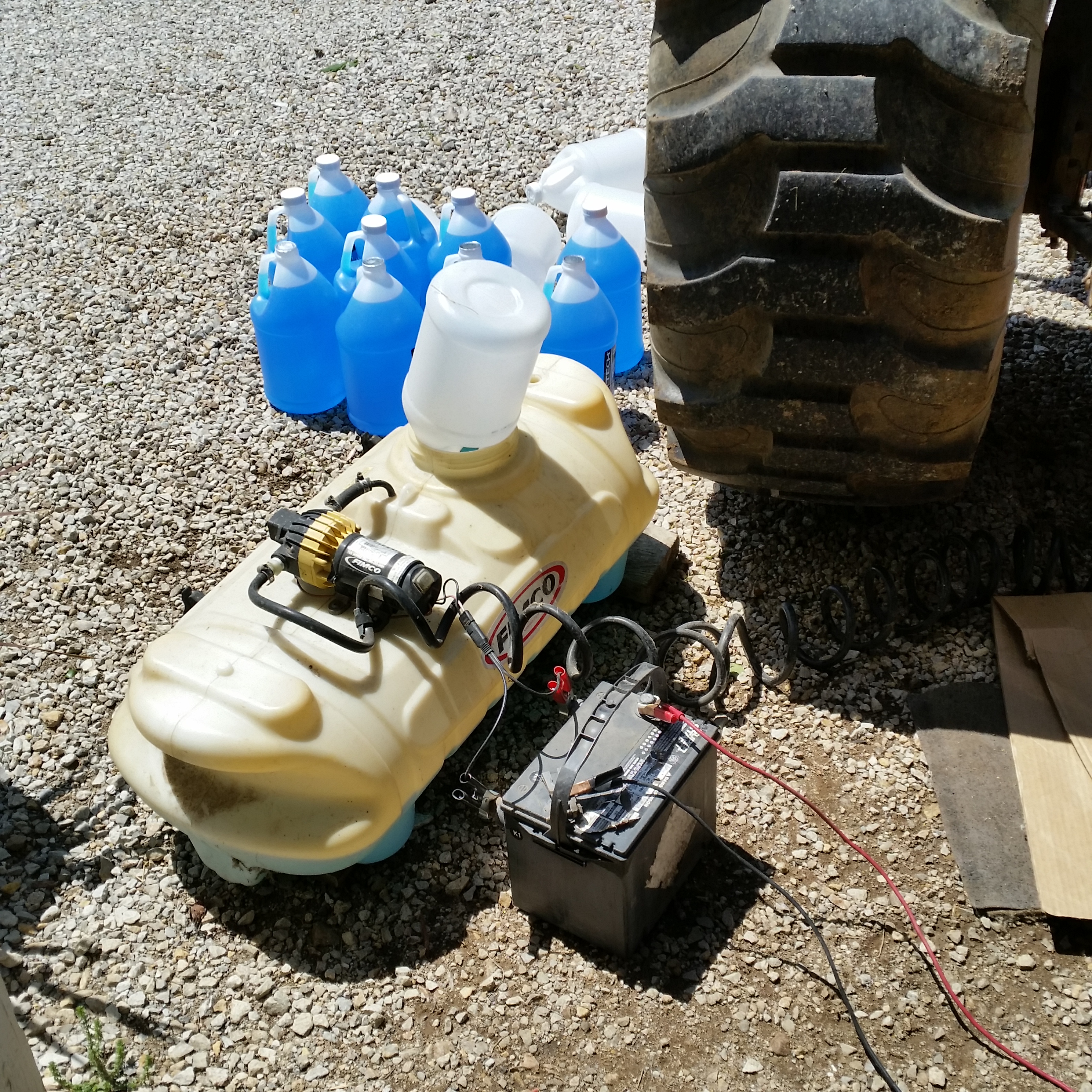

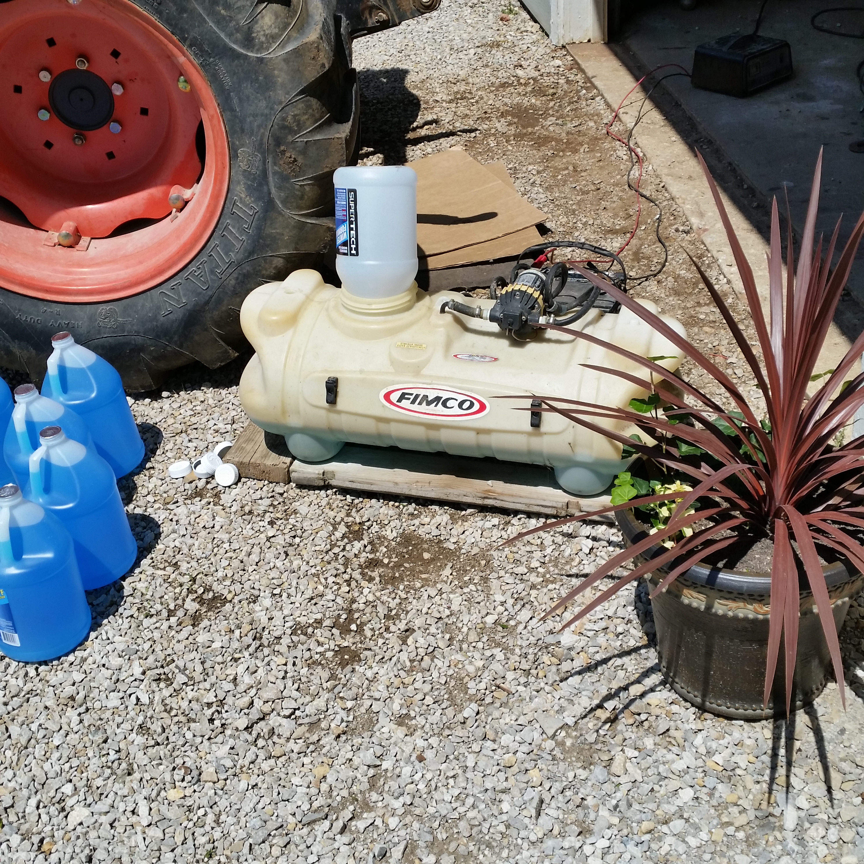

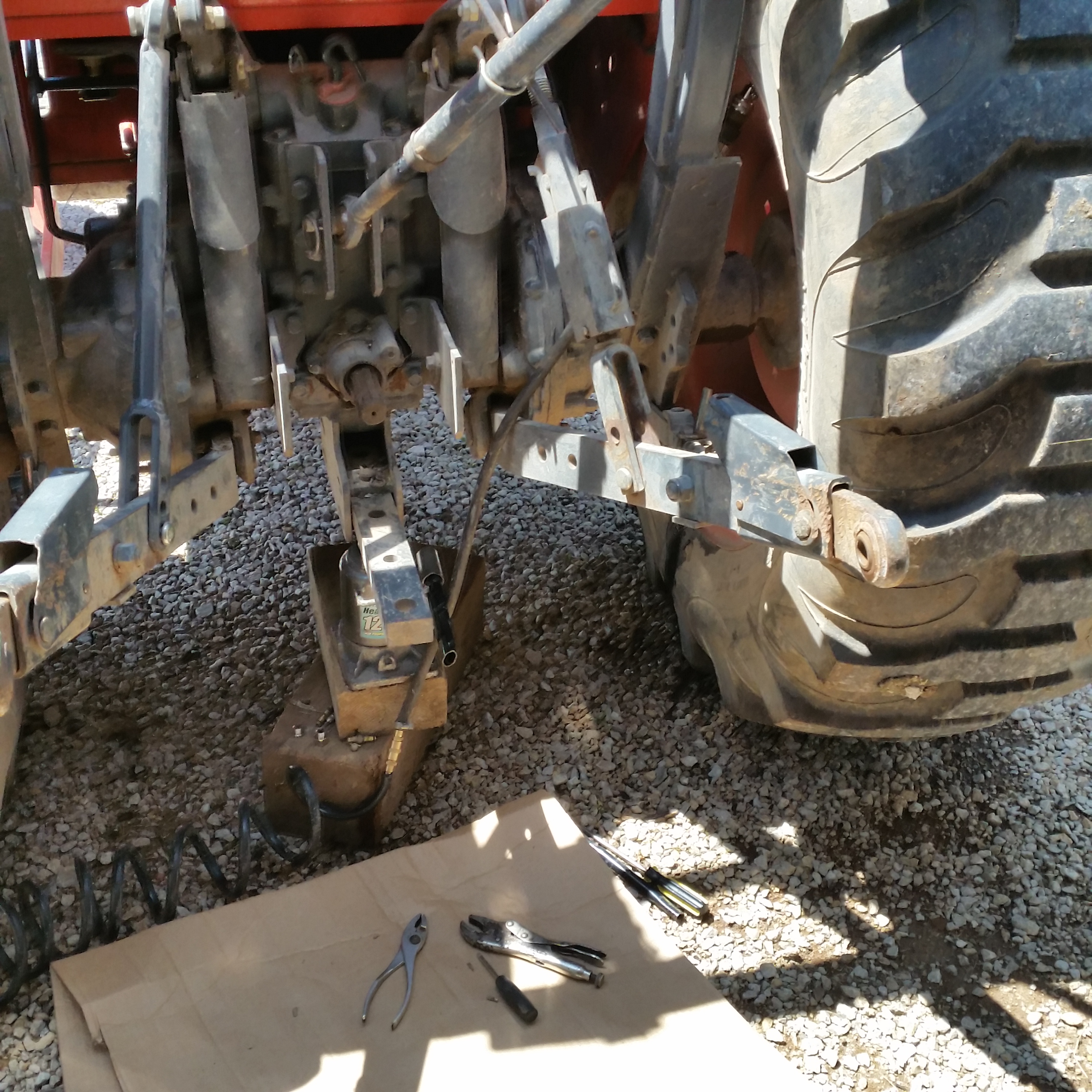

If you have one of those 15 gallon sprayers used for UTV's and four wheelers, use that to fill the tires. The gallon jugs stay in place and fit just fine when turned up side down on the opening. I put about 40 gallons in each tire and only burped the air 3 times on each side. Used -20 WWF, $1 gal at Walmart in the Spring. Took longer to get it all set up than to pump the fluid. Probably 25 minutes per tire.
View attachment 564063[View attachment 564066View attachment 564065
I have one that is towed behind my lawn tractor and that is a brilliant idea. I have a 12V RV pump I was going to use but this is a better way. Thanks for posting!
