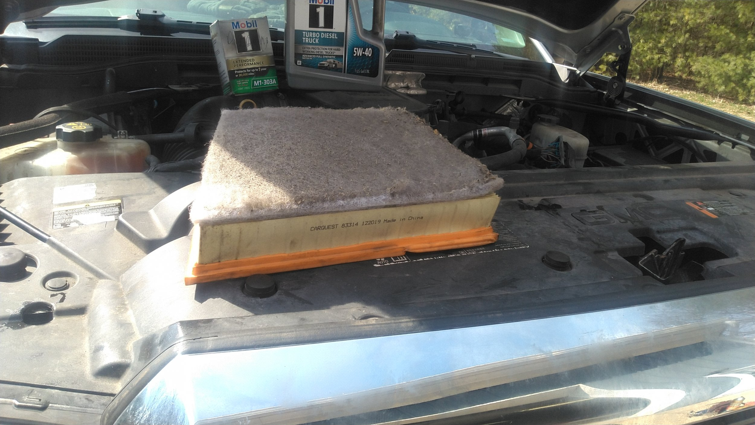

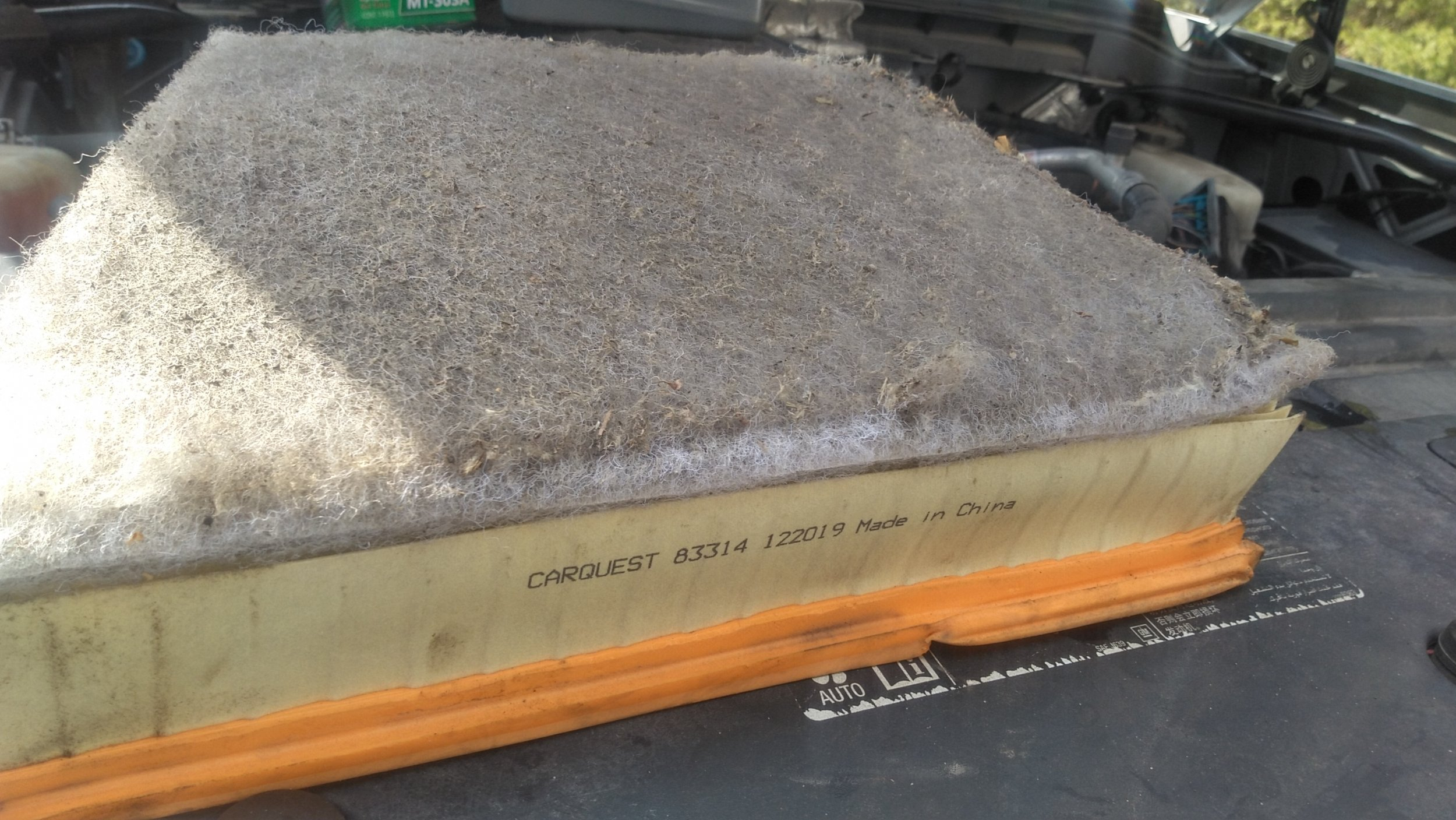

Doing the pm on my truck this afternoon found my rather expensive air filter purchased at a local carquest and the one I replaced before was made in China. Anyways been kind of burned before buying cheap parts online due to mediocre descriptions and wrong part numbers that's why I asked more knowledgeable folks if they have purchased filter bundles online. Knowing I wasn't looking at genuine Kubota filters. However after Input from a few on knockoffs and qaulity etc, I guess you don't really know what your buying in terms of filters unless it's from a known reputable company that's been around awhile e-commerce or brick and mortar.

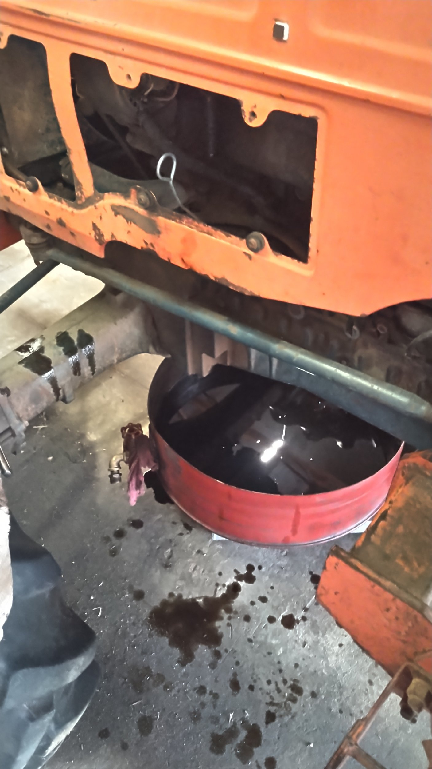

So replaced all filters with genuine Kubota filters/ aftermarket fluids. There is a Peace of mind knowing what I bought is correct and works like it's supposed to. Btw a Kubota l 4150 or 3750 takes over 45 qts of trans hydraulic fluid. Got to test my homemade drain pan still overfilled, my diy welds held up ok fortunately, however I still made a mess and had to put plugs in mid drain my calculations for liquid volume capacity using an old drum was off lol. 600 hrs I'll do it again.

Lets see, my M9's hold just under 15 gallons each so if one gallon is 4 quarts times 15, that is 60 quarts, give or take. Why I use a plasma cut big truck aluminum fuel tank with welded on (TIG) handles. The Chevron THF synthetic I use is getting pretty expensive too. Currently $121 a pail. I can not only drain the gearcases but the sumps as well on one shot.
Only money. $121 x 6 ain't chump change.
/ Filter bundles #25
I like to drain mine on the gravel out front of the shop, that way if any spills, it just keeps the dust down. I like your bung / valve idea. I may have to do that. Now, I just prop the half full fuel tank on a block and use a gallon plastic jug to get the oil out which goes in the empty 5 gallon pails and off to my friendly recycler.

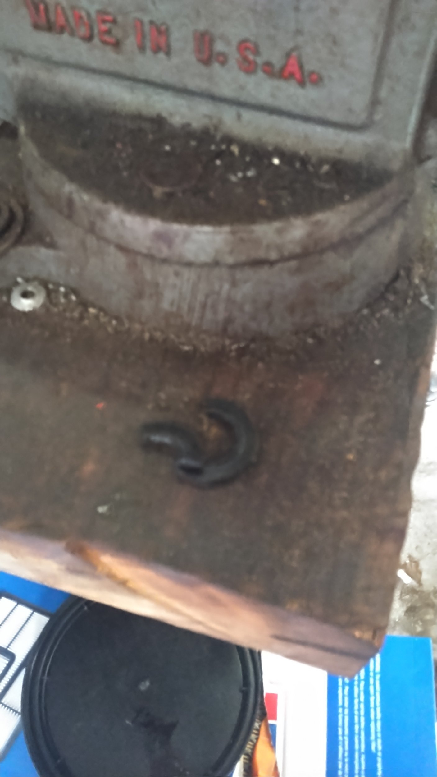

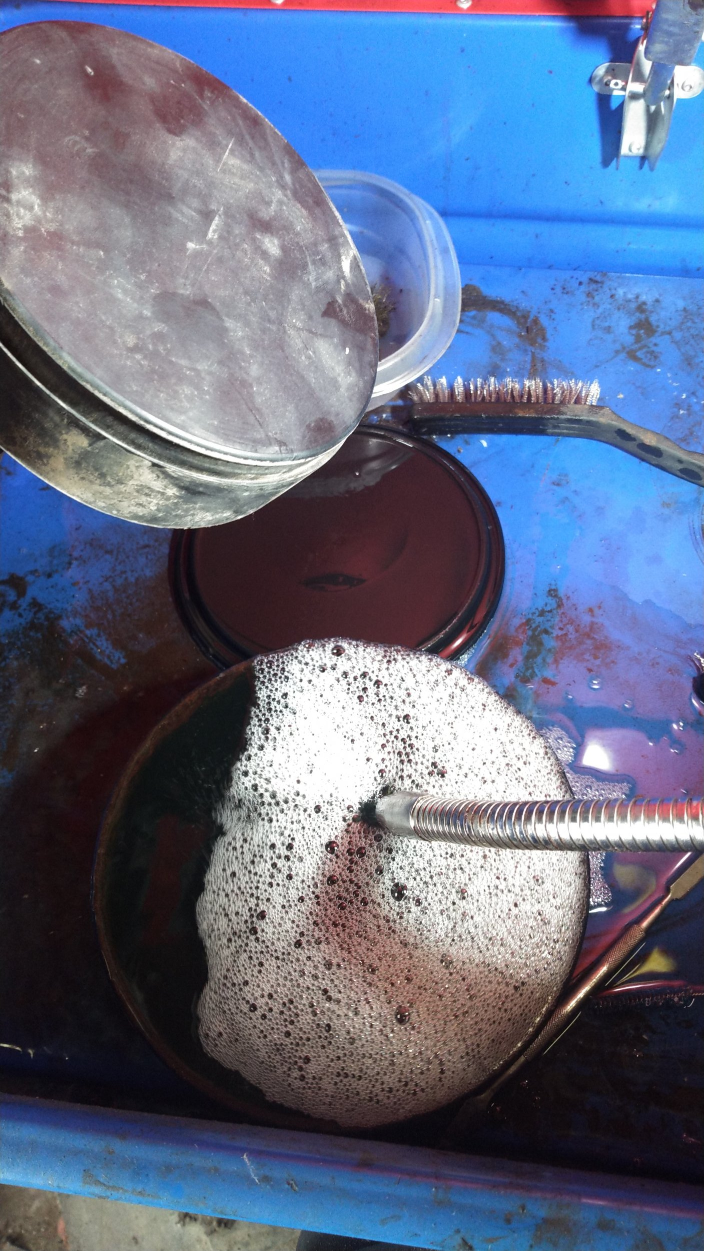

When I got my first tractor I changed all fluids and filters regardless of hrs annually I look back now and wonder what the heck was I thinking. Definitely changing trans hydro fluid every 2-5 years now unless I go over the hrs. Reminds me wonder how many folks pull the rubber dust collector cap off the back of air filter canister on older Kubotas? That can and will get nasty. 1st pic is from a broken sealing washer on goes in between filter retaining nut and filter, it was broken when I took filters out at least Kubota OEM filters give you a new seal for it and you don't even have to pay extra for it lol.

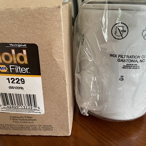

I ordered a NAPA Gold 1229, inside the box is a Wix 51229
