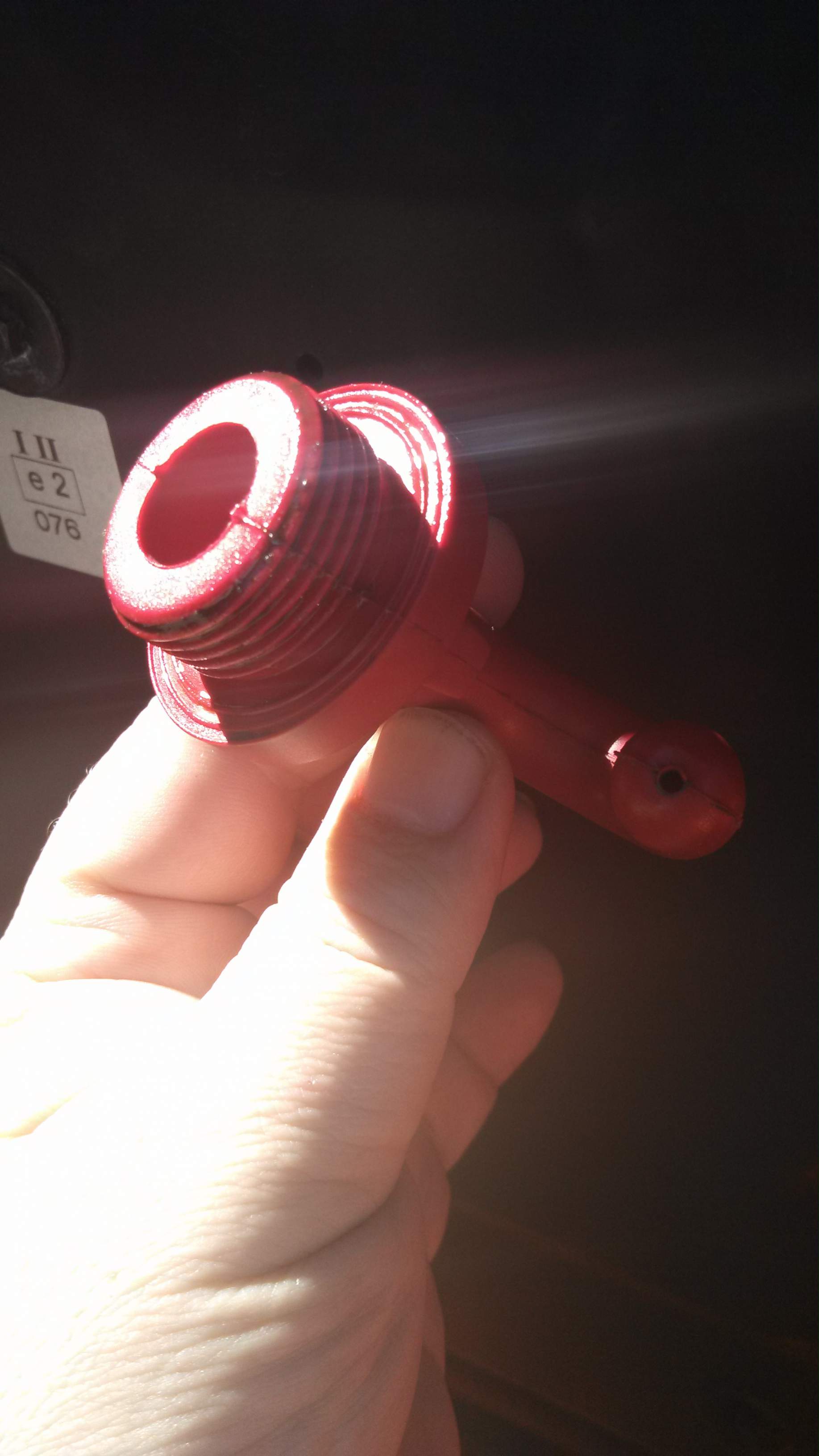

IMG_20130922_150416_989.jpgI didn't use a vacuum the last time I changed the hydraulic and hydrostatic filters on the Kioti. I just stopped up the breather hole with a screw. I changed out the hydraulic filter at my leisure and lost maybe 1 or possibly 2 ounces of fluid and what ever was inside the filter of course. the fluid did not rush out the hole because there is no air that can get in from the top side of the tank with the breather hole stopped up. It creates it's own vacuum. The hydraulic system is airtight except for the breather hole. I had used the vacuum cleaner "trick" before with success, but I lost less fluid this way than with the vacuum cleaner method.

If you "plug" up the other end. the air in end, you will not have to mess around with rapidly putting in a cork as without air going into the tank no (or very little) fluid will come out of the filter hole. All you need to do is put a screw in the air vent hole of the rubber crooked stopper. On Kubota's I believe most of them are under the seat. Do not forget to take the screw out when you are done. It sure worked for me on my last filter change.
